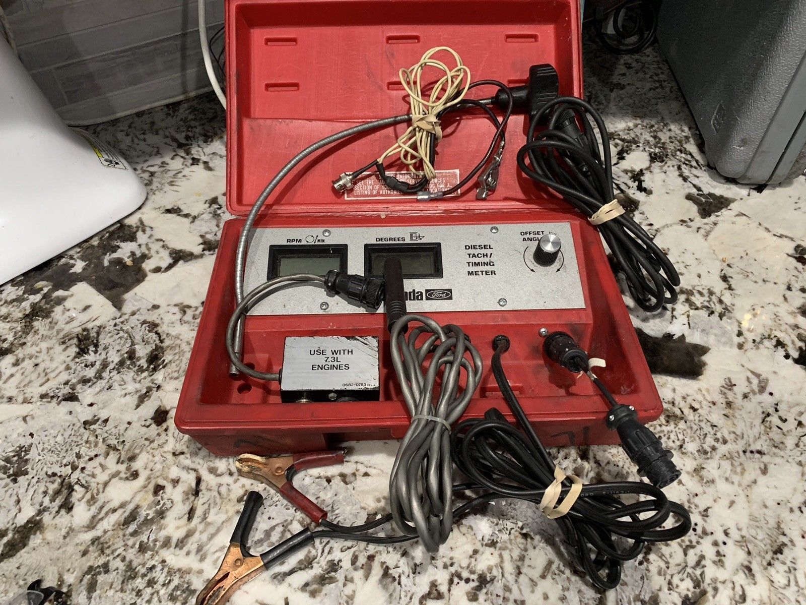

Changing the injection pump can be a simple process, but getting back in time properly requires some special equipment that is getting hard to find and expensive.

It is electronic equipment so not exactly something you can whip up in a machine shop.

To time the IP you need a piezo-electric detector that you clamp on the #1 injector line. Then you can hook up a timing light to the detector. I haven't bought the detector yet and I've owned my truck for almost 2 years. You can static time the IP, but you need the detector to do it properly.

Here are one of the few piezo adapters left. I think Ferret quit making theirs.
Gunson Diesel Adaptor For Timing Lights - 77089

No you can static time it basically just line up the line on the pump and the timing gear cover. And that will get it close enough to start and drive it to get it timed at a shop.

That is the static timing to get it started and take it to shop to get it done dynamically . The marked setting is conservative and is fine to drive on but you will be leaving power and fuel economy off the table.

Probably not a bad idea to have a diesel mechanic familiar with the 6.9 set the timing. Usually you can get more than 150,000 miles out of a complete tune up which would include injector pump and injectors. No need to replace glow plugs unless they test bad. Besides the timing there is also the adjustment of the injector pump which also requires special tools.

Here's a thread on our site about the IP timing tool:
https://www.ford-trucks.com/forums/1...ow-what-4.html
From my experience, you will have a difficult time finding a diesel service shop to time and adjust your IP. I went to multiple shops in OKC and I was either told that they don't service mechanically injected diesels, or they just wanted to just sell me new parts instead of troubleshooting the problem.
