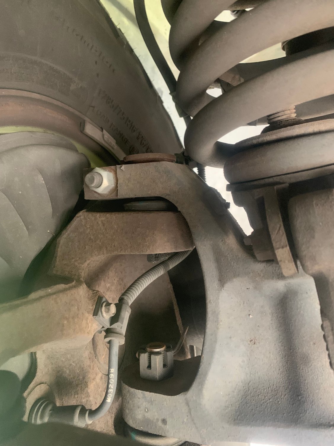

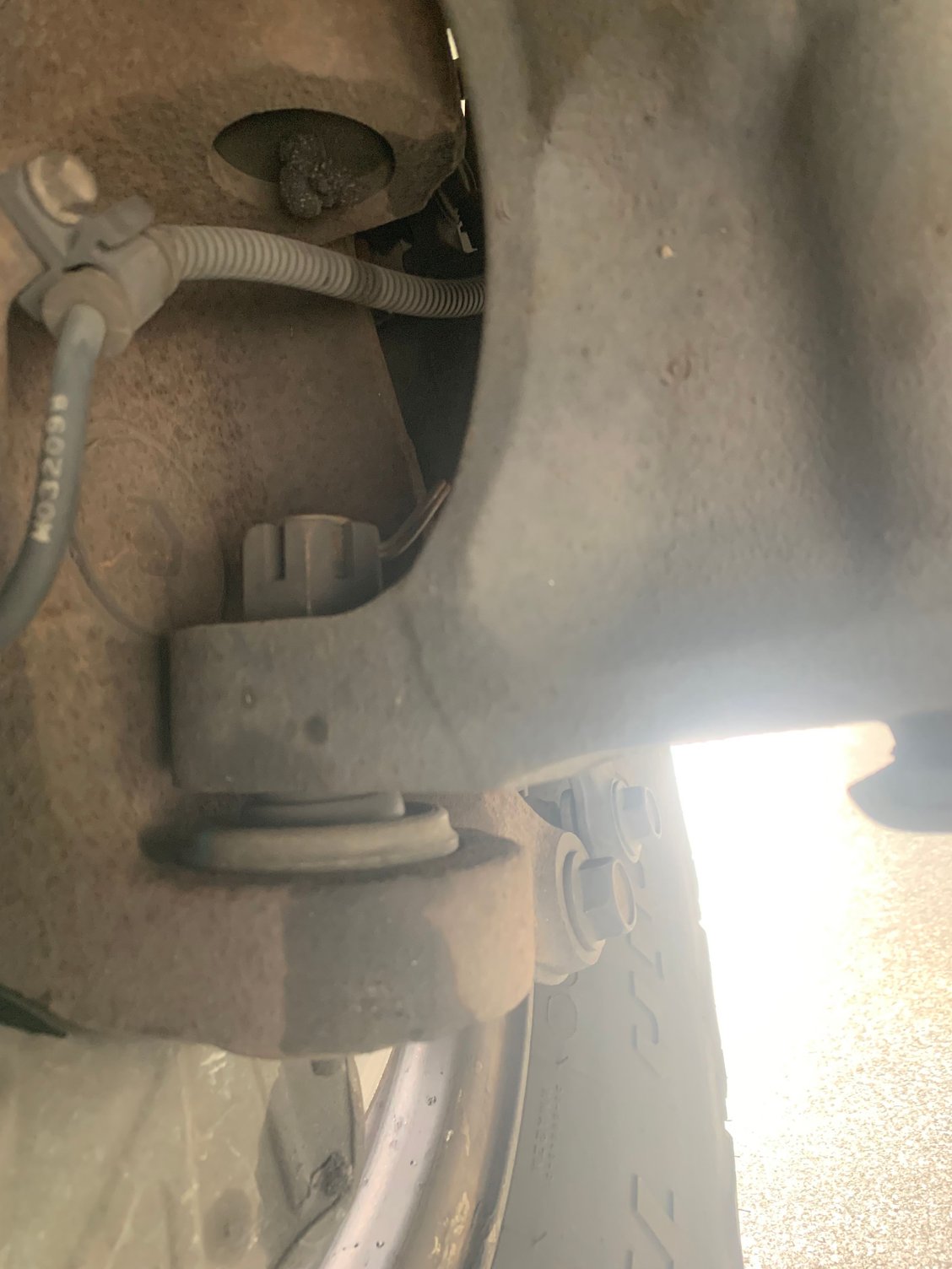

Old Mar 17, 2019 | 11:01 AM
HarleyHD's Avatar
HarleyHD
Joined: Jan 2019
Posts: 63
Steering
This was done bout 3k miles ago. I drive a lot and no dirt roads. I don’t even see any scratch marks. Hopefully I loaded these correctly
Old Mar 17, 2019 | 11:12 AM
pirate4x4_camo's Avatar
pirate4x4_camo
Joined: Apr 2011
Posts: 8,259
Likes: 346
From: Northern California
Post a pic from this angle showing the top of the balljoint
