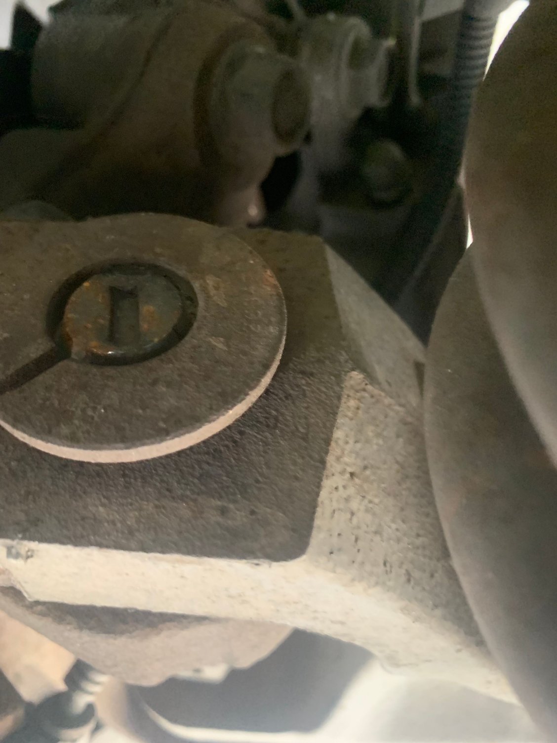

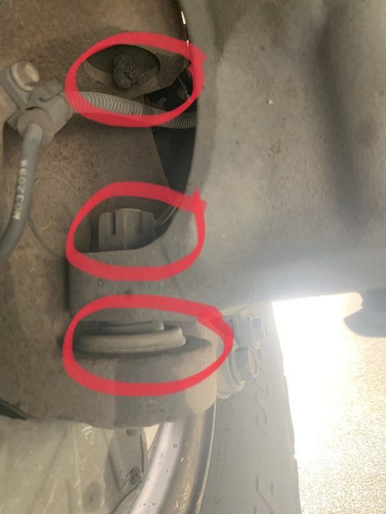

Driver lower ball joint
1st picture shows the nut and threads have the same aging as the rest of the underbody, this is road grime as I would expect to find on a part that has been in place for a long period of time, a new balljoint would have clean threads and a brand new nut and cotter pin, this ball joint has not been replaced recently, 100% Certainly not in the last 3000 miles.
the bottom circle shows the zerk fitting, close examination shows road grime in a small grooves, this one has been wiped clean and then used to grease the ball joint. 100% certain this is not a new ball joint.
and finally the boot.
the boot is a faded black and shows considerable road grime with clean grease oozing out of the seal as is common with a old ball joint that has recently been greased. Note the fresh grease also on the zerk, if had not been done recently the grease would be covered in dirt.
100% this is not a new ball joint.
every indicator in this pic shows a old ball joint that has been recently greased.

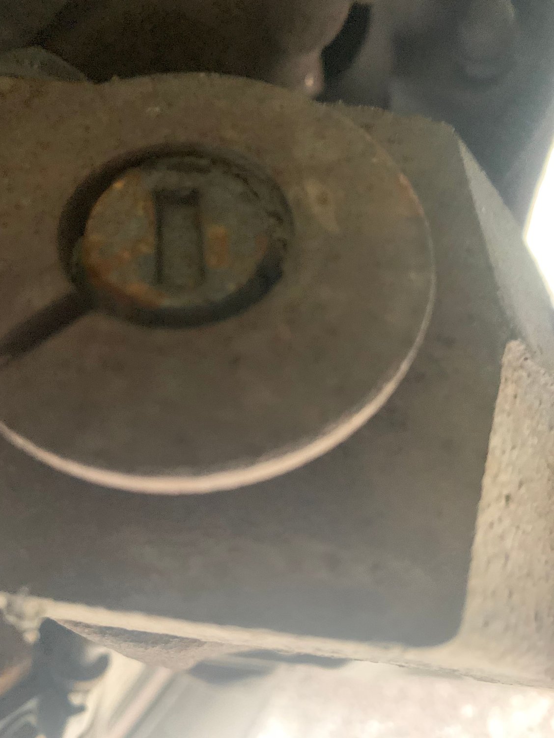

Passanger side upper.
Zerk is covered in greese Which has attracted a considerable amount of road grime.
not only is this a old ball joint it does not appear to have been greased recently.

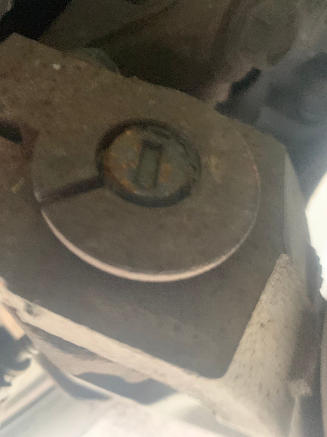

another clear view of old road grime compleatly covering the Zerk.
also the bottom of the ball joint shell coated in road grime that takes considerable time to accumulate, I would say this ball joint has been in place for several years.

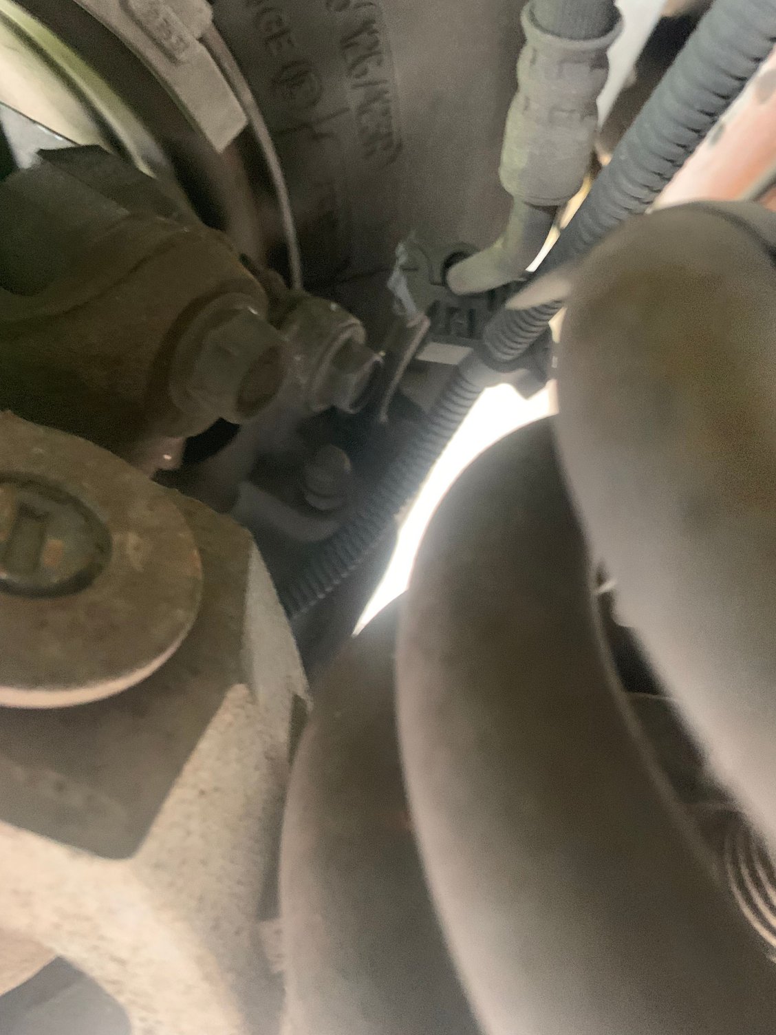

lower ball joint.
nut shows ageing consistent with the rest of the underbody indicating they have has in place for years.
a new ball joints comes with new nuts and cotter pins, both of these are not new.
The rest of the ball joints coloration shows the same aging indicating it has been in place for a considerable amount of time, likely years but without any doubt has not been replaced in the last 3000 miles or the last year. No way no how.
