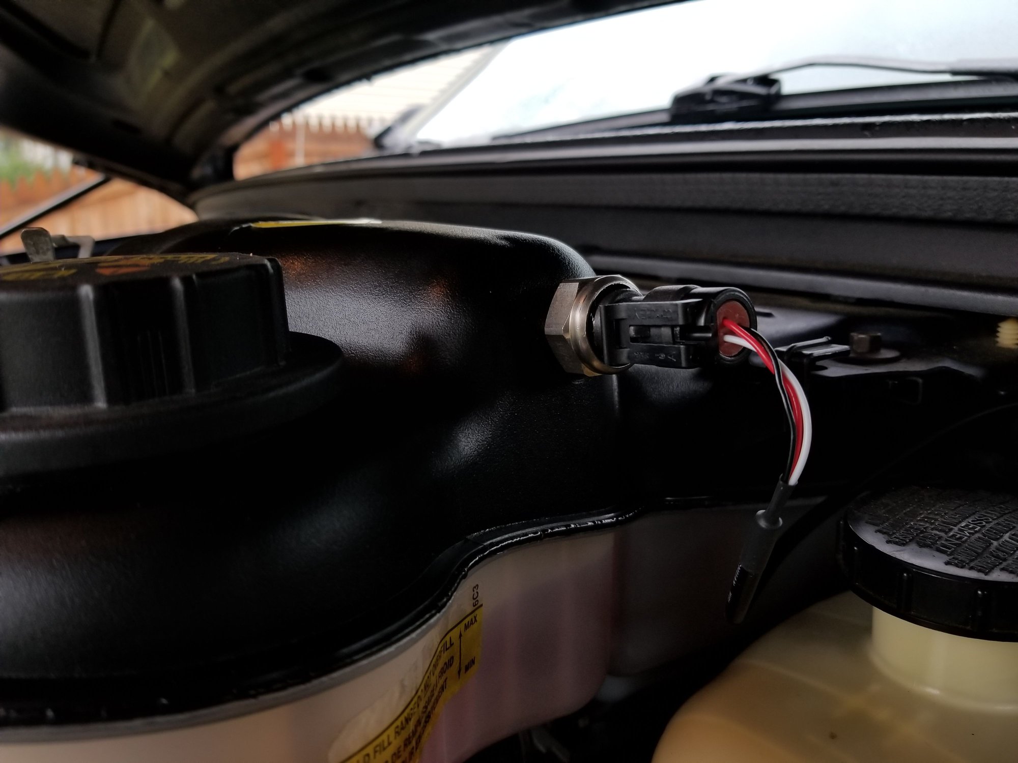

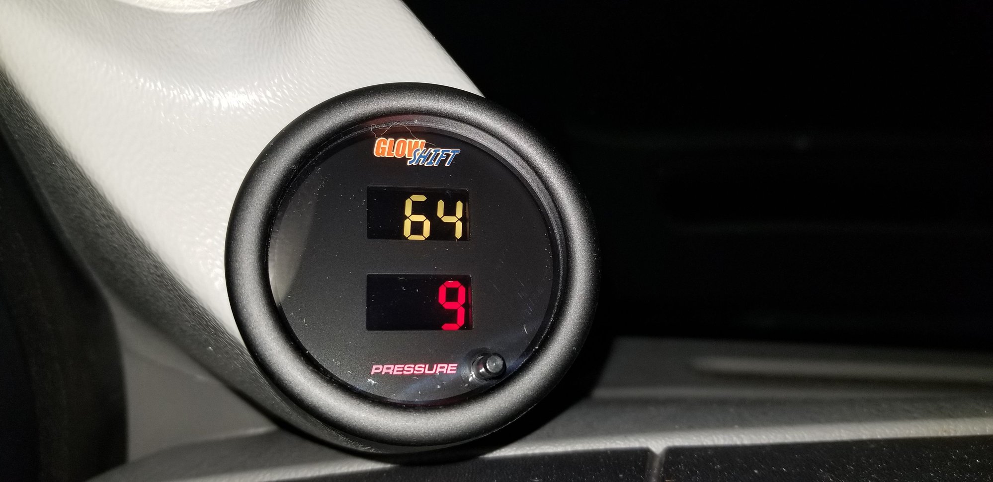

I hooked a sender into the extra port on my coolant manifold and have a gauge on my A-pillar.
Ten psig is is about normal for me at 190+\- coolant temp. Can get higher when towing but still tracks with temp.

Electronic gauge with the sensor tapped 1/8npt in the degas. Avg 9-11 psi
