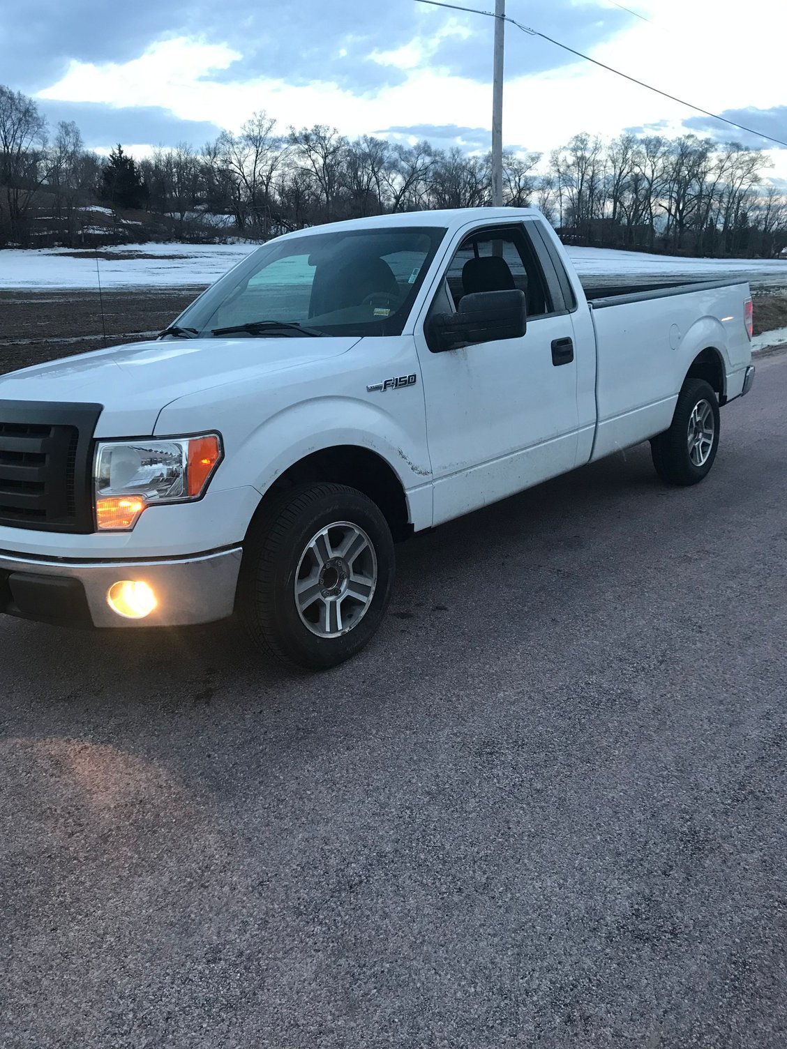

how much interference with the caliper bracket.. Can you grind down in one area that don't make much difference in strength and get the clearance you need ? ................... I thought you said the 2008 wheels were FORD, not aftermarket... they should have the SAME backspace if they were FORD.
Old Mar 12, 2019 | 09:03 PM
dragford1's Avatar
dragford1
Joined: Dec 2017
Posts: 72
From: Omaha NE
The wheels I’m trying to use are ford oem from a 2008 f150. The ones I’m replacing are aftermarket - and they stick out way too far for my taste.
Old Mar 12, 2019 | 09:26 PM
steve(ill)'s Avatar
steve(ill)
Joined: Jul 2005
Posts: 11,931
Likes: 180
OK.......... still don't understand why the 2008 FORD wheels don't fit the 2009 truck.... Clean the center hole with sandpaper, flapper, or wire brush and then install and check clearance......maybe a small amount of grinding on the bracket ??
Old Mar 13, 2019 | 08:21 PM
dragford1's Avatar
dragford1
Joined: Dec 2017
Posts: 72
From: Omaha NE
Well I cleaned out the center bores, and took off the caliper bracket to grind it - did the trick. Not sure why I had to do that but it worked. Thanks guys!
