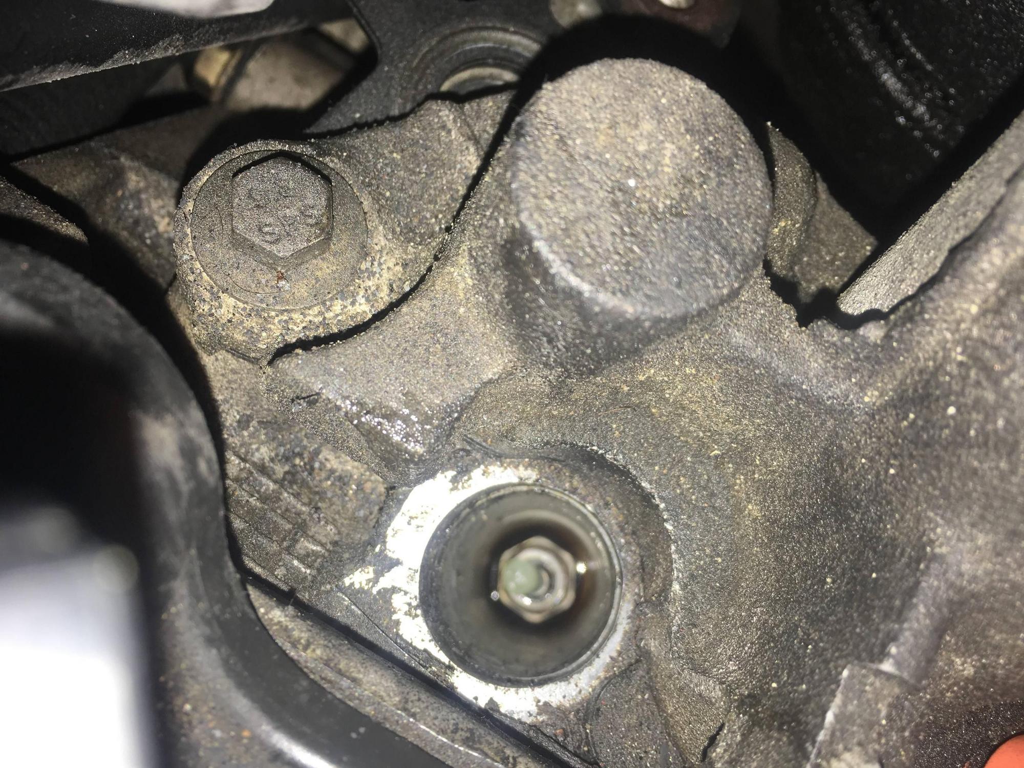

Today when running the truck, it is not stuttering in Drive like before. It stutters very very slightly in Park, but it has always done that. Once I drop into Drive it feels pretty smooth. Nevertheless I started some tests.
I pulled the COP on #5 and swapped it with #1. While the COP was on, I took a picture of #5. It didn't look too wet or anything, but it was very hard to tell.
With the COPs swapped, I unplugged the one on #1 and it started stumbling, so that COP was OK. No codes came up.
I went to take a look at the spark plug on #5, and discovered there was a damn screw on the top of it. You can barely see it in the picture because it is blurry. The spark plug was tight, so I didn't even bother taking it out. I just disposed of the screw.
I put the COP back on and it is still acting as normal. Stumbling/vibrating ever so slightly in Park, but feels good in Drive. I unplugged #5 and started it up, and it ran badly, so clearly it is not completely misfiring. I guess I will take it on a short drive and keep checking for a code coming back.
