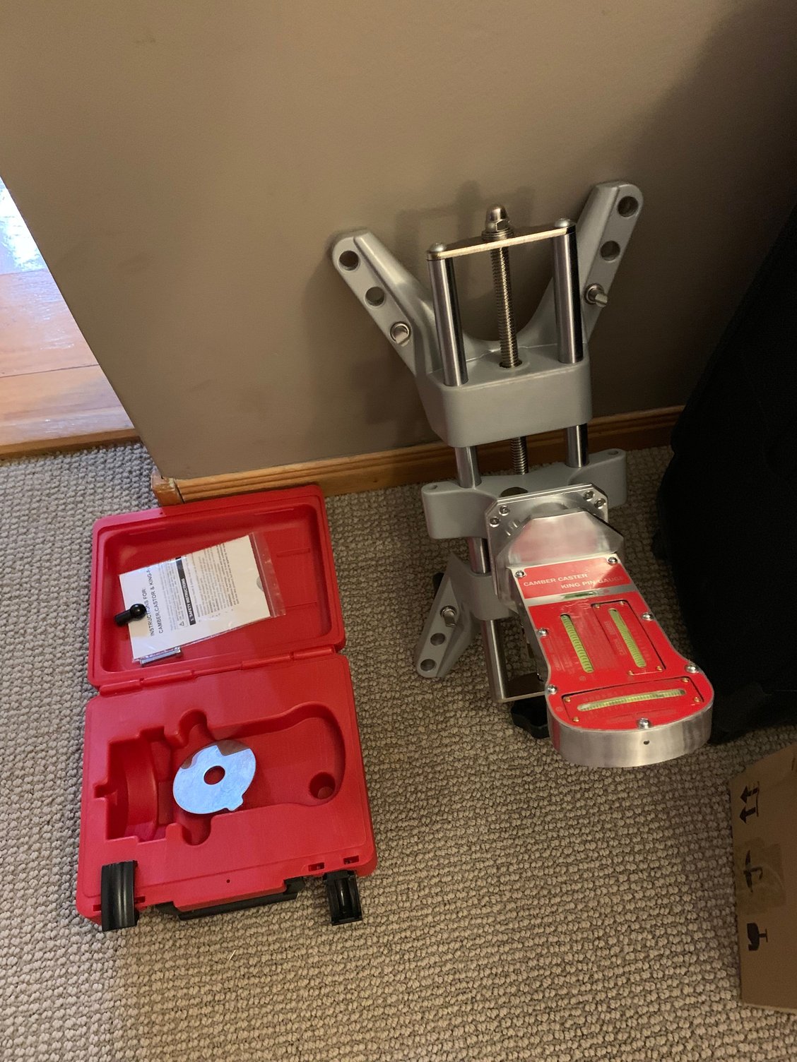

I just ordered a caster/ camber gauge because I’ve decided I don’t trust a shop with my front end...
hope the wife’s not home when it arrives

I think there’s confusion in terms. I’m gathering by neutral they mean very little bias left to right. It can’t possibly be anyone thinks these trucks will be better with near 0 caster than 3-5.
And the gauge arrived today while the wife was home... but i’m Still glad it’s here!
