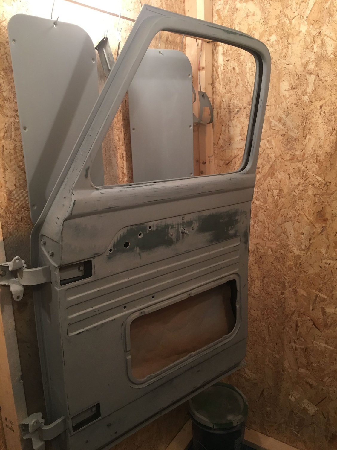

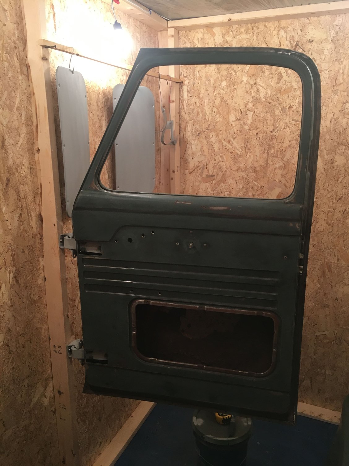

Hung the doors

Nice...very ingenious!

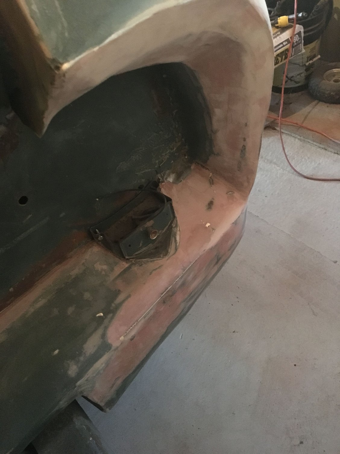

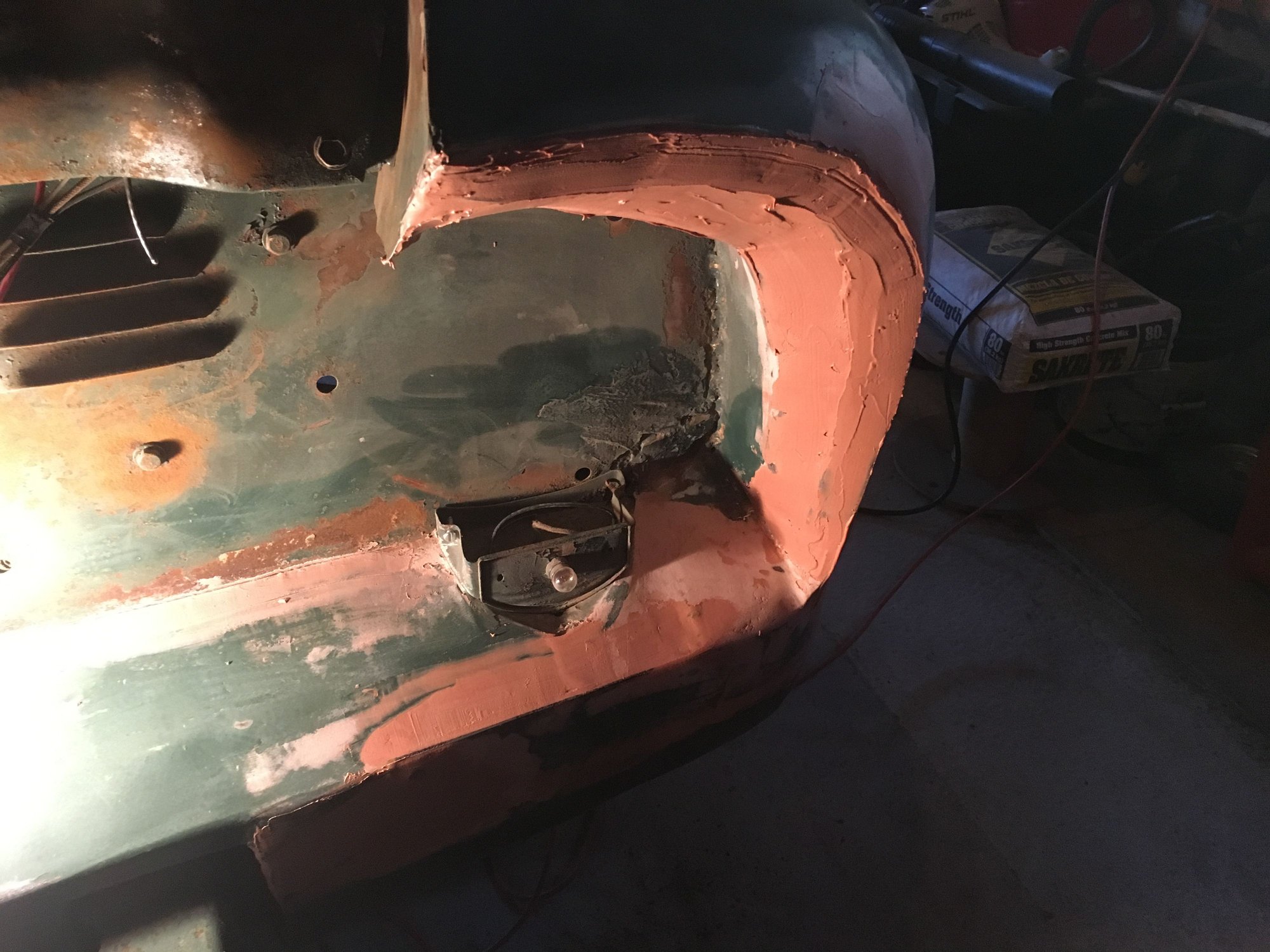

Waiting for my new positive pressure full face mask to arrrive. Then I can start to paint some of the smaller parts and the two doors. Still have a little shaping and sanding to do on some Bondo work. Do I need spot prime (just hit the spots with the body filler), let it dry, then prime entire piece?

It is always best to spray the entire panel with a sealer prior to applying your color coat. Body filler is like a sponge and will suck up any paint applied to it, you will find that you will need a few coats of primer to get the surface smooth.

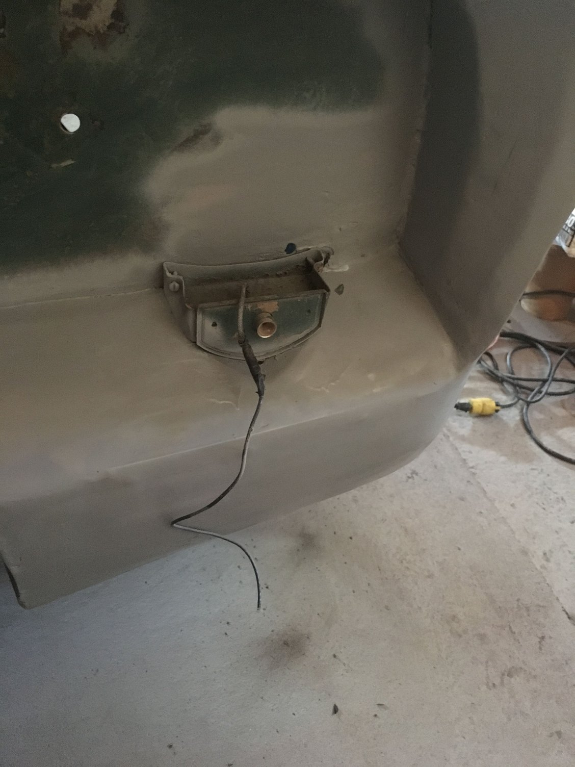

Applied another light coat of body filler, did some sanding and rattle canned some primer on. Need to sand primer down now. All I have is 220 grit right now. Need to get some higher numbered sand paper.

Now that a little primer is on, I can see a few low spots with the filler. And of corse I have runs. I will be sanding most of that off. I do like my new positive pressure face mask.

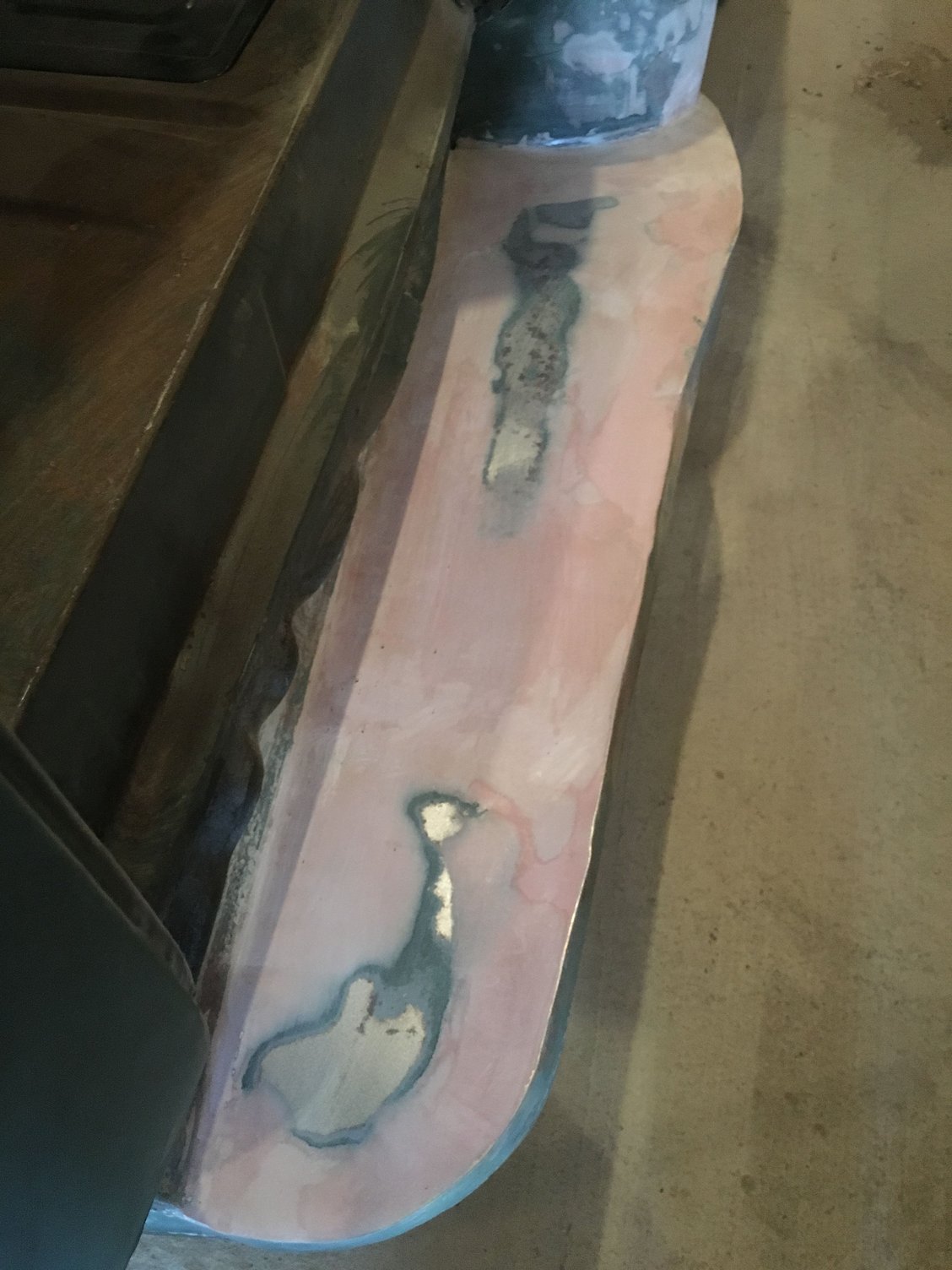

Well I am definetly not a painter. I did get one coat of primer on. I don’t like it. Will be sanding most of it off.

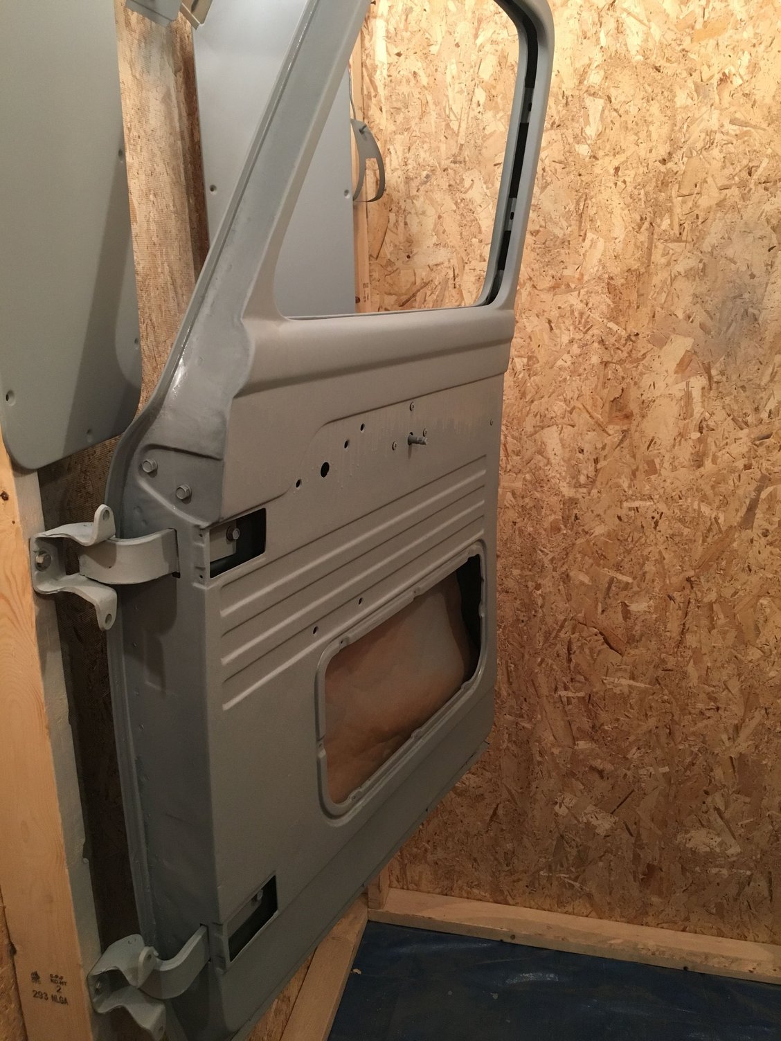

Great way to mount your doors.

I like your removable plastic on your floors. I did not do that but wish I had. I has an epoxy floor in my old shop. After all the priming and painting the floor was a mess. Lesson learned. The days I was painting, I would lightly spray the floor with water to help keep any dust or particles from flying around.

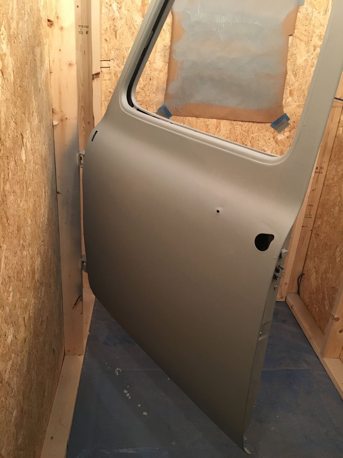

Got the doors sanded. Started with 500 then went to 1000, then 2000 grit. They feel really smooth. Vacuumed and washed then down. Ready for another coat of primer.

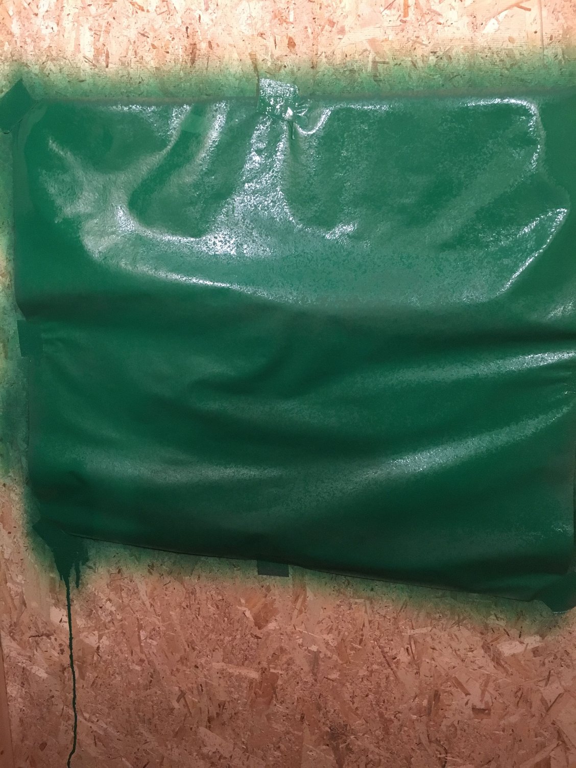

Bought some cheap acrylic water based paint and ran it through the gun. Did some nice test patterns. I think when I pruned the first time, I thinned it too much. Directions said 1:1. Think it should be more like 1:0.5
