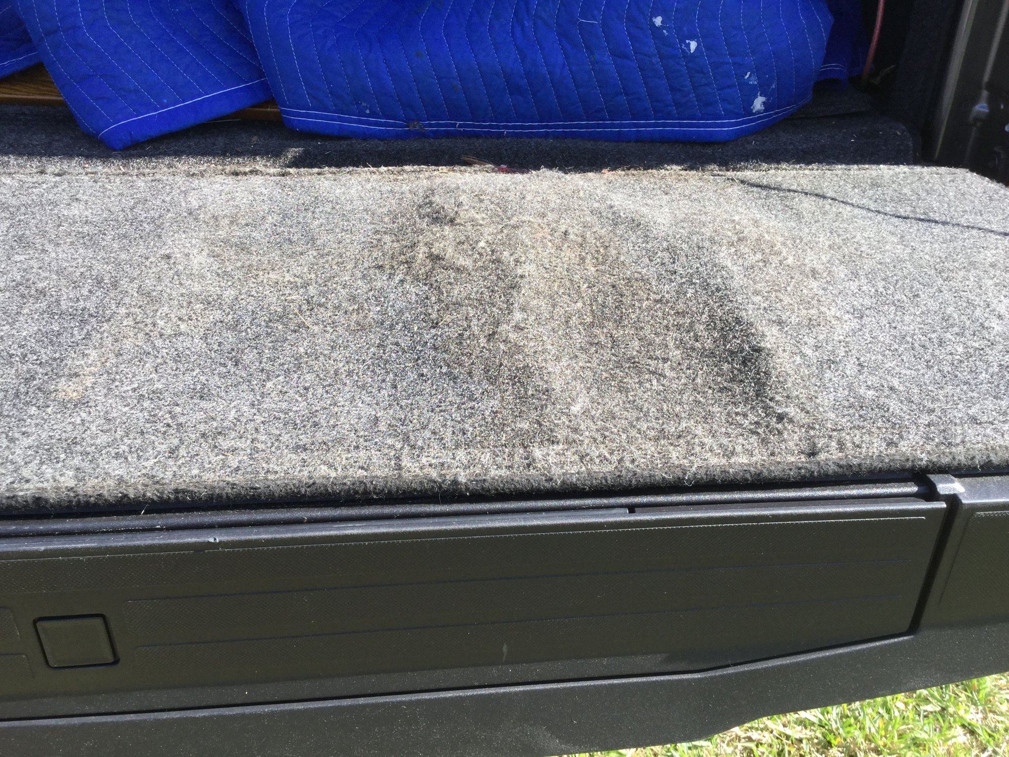

I just replaced my BedRug Bedliner with a new replacement BedRug Bedliner under warranty due to spilled hot used Diesel engine oil. The oil bubbled the carpet on the tailgate piece and stained it so BedRug agreed to warranty the 2.5 year old Bedliner.

Here’s a picture of the replacement Bedrug Bedliner with my Andersen hitch installed. No more distorted and stained rug on the tailgate.
