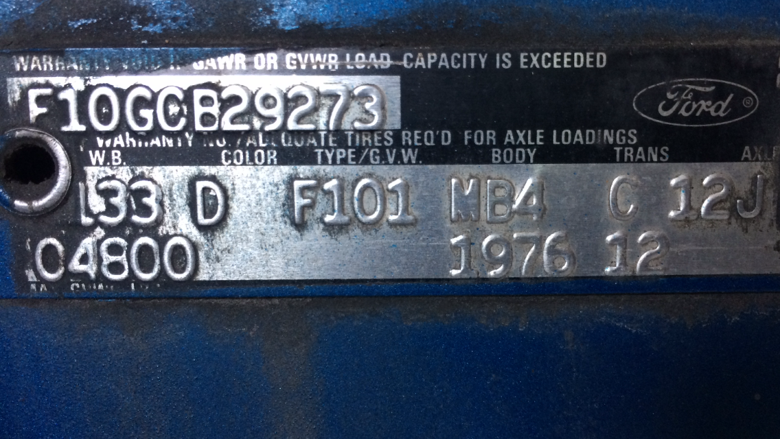

I have a 1976 LWB F100 2WD with a 302 engine, 27 inch diameter tires, and a 3.03 manual transmission and was wondering if anybody knows if all of these transmissions came with the same gearing with this model year truck? I have read that they have 2.99 first gear, 1.75 second gear, and 1.00 third gear. Does this sound right? I want to change the third member in my 9 inch rear to a possi. and want to have accurate information to pick the best rear gears for my truck. My intentions are to hot rod it and I'm thinking 3.70 rear gears would be good.

Originally Posted by BeauF0RD
This truck does not have a 9" rear axle.
F10 = F100 2WD Pickup.
G = 302 2V
C = Oakville Ontario Canada Truck Assembly Plant.
B29273 = 1976.
133" Wheelbase.
D = Blue Metallic.
F101 = F100 2WD Pickup, 4800 lbs. GVWR
MB4: MB = Blue Vinyl & Blue Cloth / 4 = Styleside Pickup.
C = Ford type 3.03 3 Speed Manual all Synchromesh Transmission.
12J: 12 = Dana 44-3 Rear Axle / 3.00-1 / 2,900 lbs. Rear Axle Capacity // J = Power Steering.
4,800 lbs. Gross Vehicle Weight Rating.
1976.
12 = Buffalo NY Ford District Sales Office, where the original selling dealer ordered the truck from.
Dana 44 has an inspection cover, the 9" does not.
In 1976, Ford began installing Dana 44 rear axles in some F100/150's after the 1st Arab Oil Embargo ended in an effort to improve MPG
The 2nd Arab Oil Embargo occurred in 1979.

I guess the previous owner must have swapped a 9 inch into my truck than.
