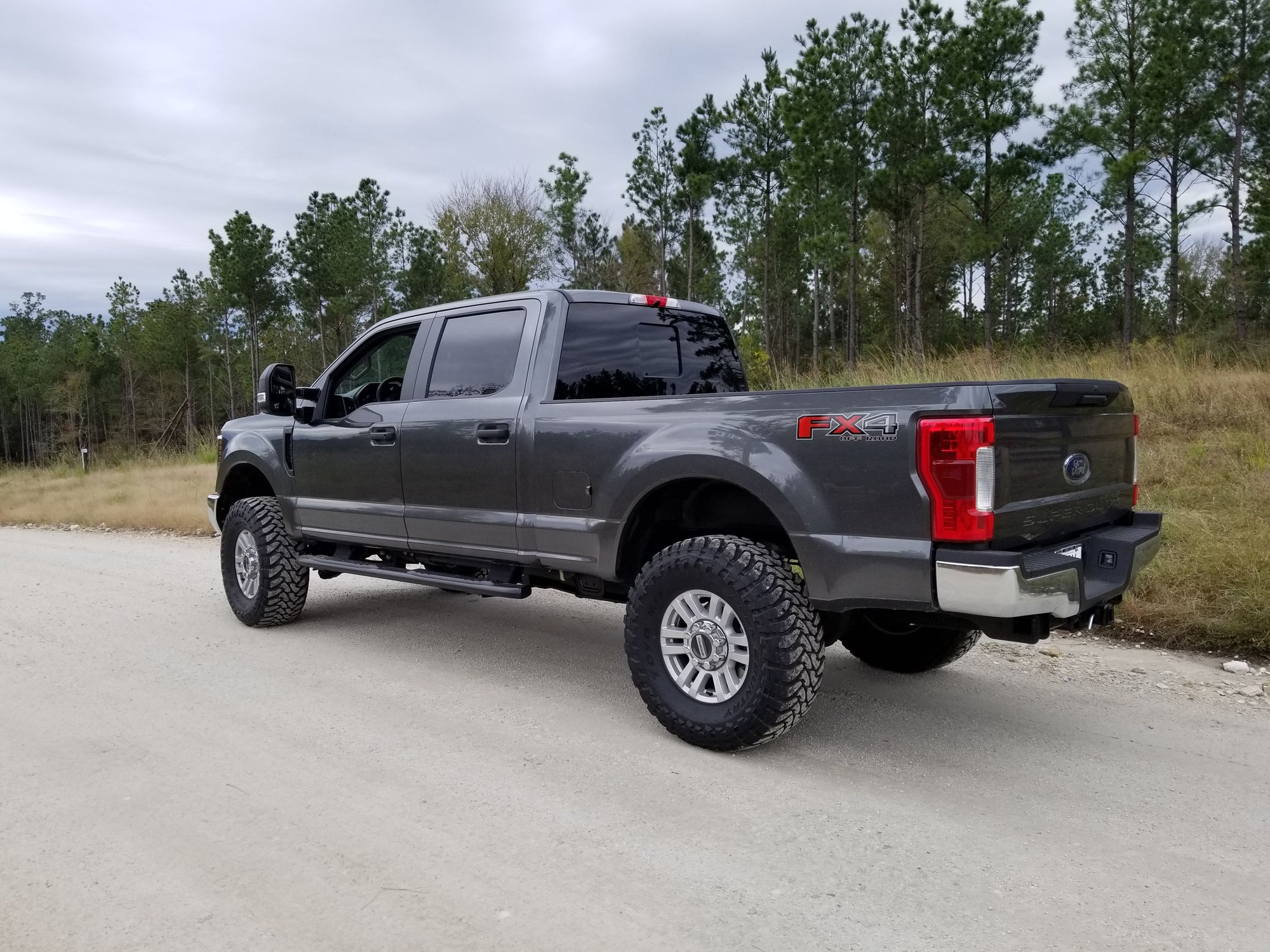

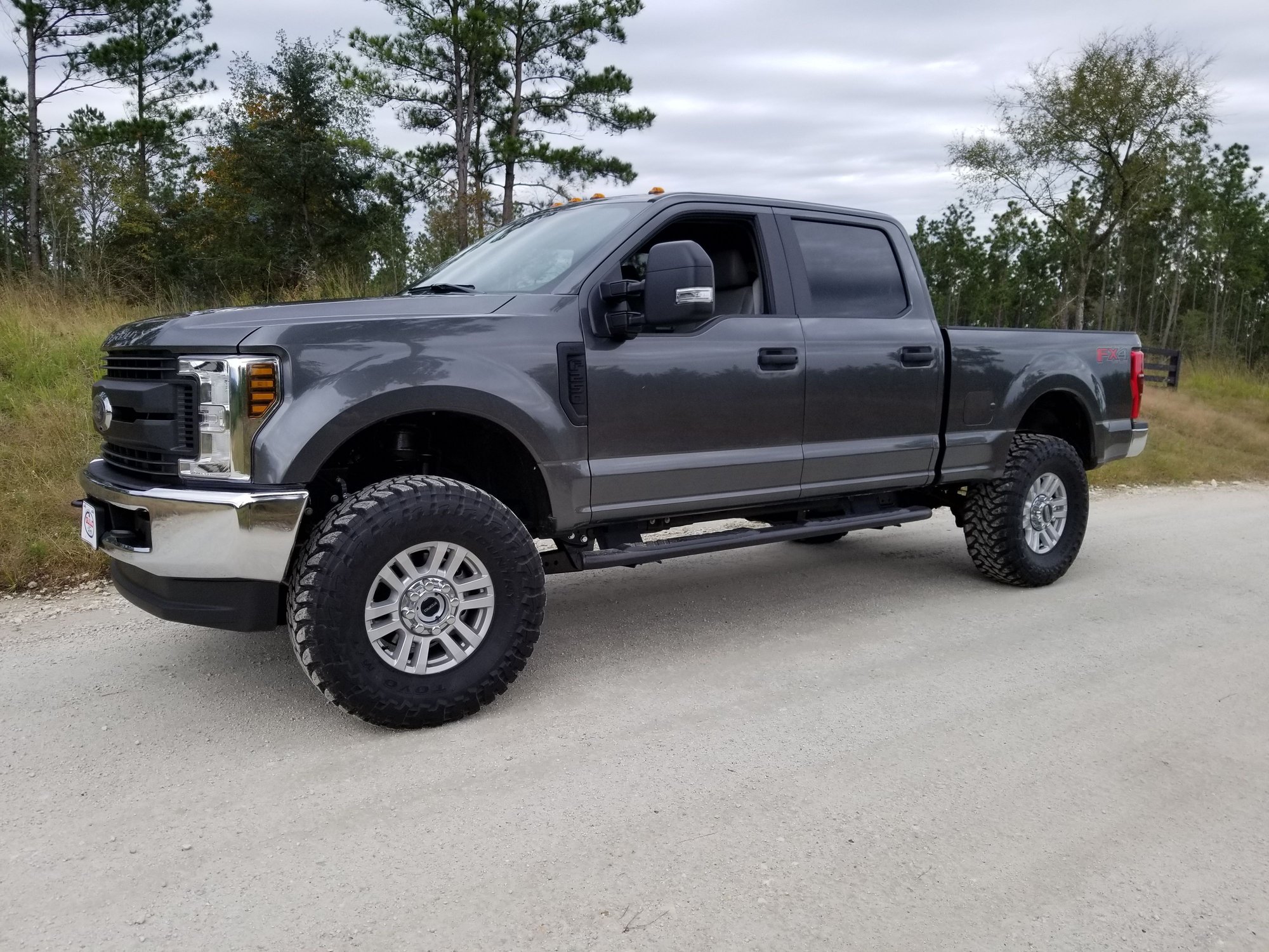

'19 SD F-250 CCSB 6.7L FX4 Limited; Leveled by means of +2" front lift, -2" rear spacer drop, riding on Bilstien 5100's F&R, and 35/12.50/r20 F-125Q's Ridge Grapplers.
Just to be clear....you added the 2" in front AND put a 2" shorter block in the rear? If so, what blocks did you use for the rear? (1" PMF?)
looks great! how does it ride

Haven't had time or reason to get it on the road yet, as it sits in the photo the truck still has less than 300 miles on it and the lift & tires were done yesterday at about 280 miles.
Dammit that is one beautiful truck.

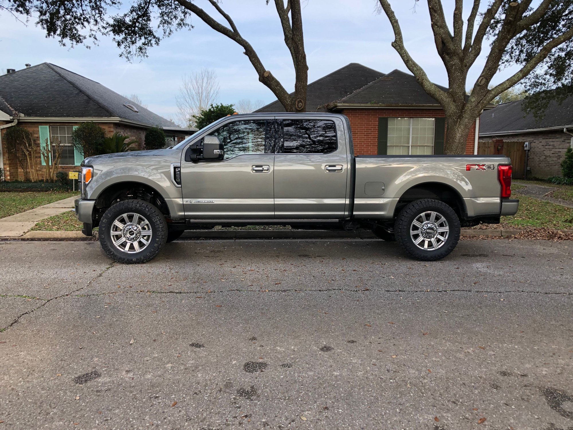

Toledo,
Here is my 2019 with a 3.5" spacer level that TOaP installed. The ride is pretty damn equivalent to stock. The included radius arm drop brackets provide plenty of caster for stock-like steering/ride (unlike most 2.5" kits, unless you follow up with proper caster cams). I am very happy with it - there is zero bump steer and my wheel snaps back on hard turns. The kit is the "rugged offroad" 3.5" leveling kit, identical in every way (except parts are a different finish) to the ReadyLift 3.5" SST kit (3.5" pucks, RA drop brackets, TB relocation bracket, brake line relocation brackets, sway bar drop brackets, bump stop extensions, etc.). TOaP says these are made in the same factory, just sold under a different brand than the "ReadyLift" name for a cheaper price. I think I paid $650 installed. Has shock extensions in the front, but as soon as I decide what shocks I want to go with (No, won't be Fox 2.0s - those were terrible in my 2018) - I'll replace those with longer shocks.

^^^^That is a kick-a$$ good looking truck. Every time I see a truck with 18" wheels I am reminded why I should have ordered with the 18" wheels. I guess vanity got the best of me. But I really like seeing some good sidewall
on a tire because it works much better with the suspension that way.
