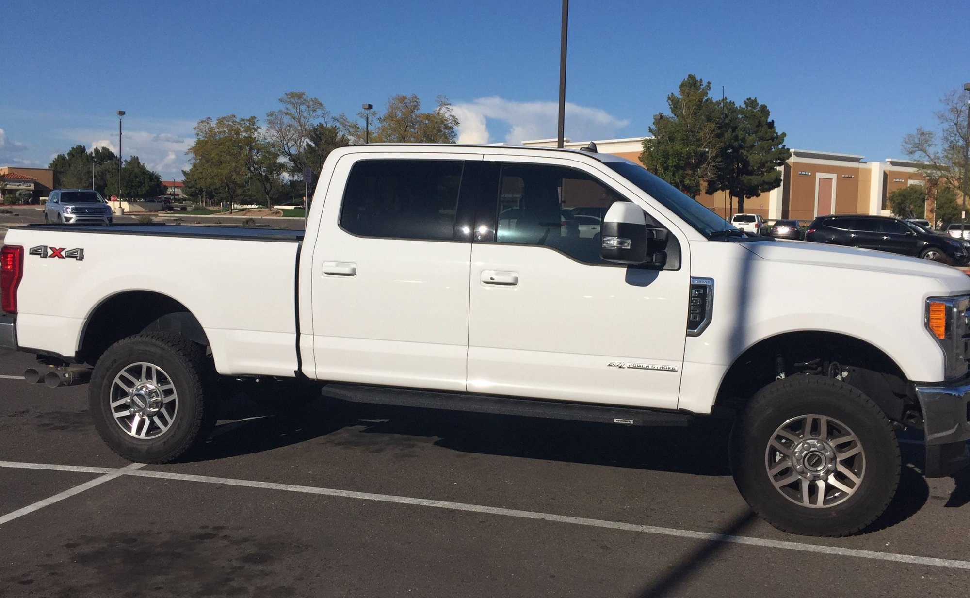

Here’s the after of a 2” BDS level with the Fox 2.0 Performance shocks
This is the after pictures of the 2” BDS leveling kit, with the Fox 2.0 performance shocks on all corners. The measurements are from the pavement to the top of the front and rear wheel wells.
Before leveling
Front - 40.5”. Rear - 44.5”. Rake - 4”
After leveling
Front - 42.5”. Rear - 43.5”. Rake - 1”
You can see that the BDS 2” leveling was exactly 2” on the front. What surprised me a little bit was by leveling the front and changing the shocks in the rear, the truck actually lowered by less than 1”. The rake went from 4” before leveling to 1” after leveling. Which is perfect for me, as I don’t want a nose-high stance when pulling smaller trailers or my bass boat.
I have pictures of the measurements if you want them, I just didn’t want to bog down the post with 4 more pictures.

that looks good.. hows the ride? do you think youll be rubbing if you get bigger tires

It rides very good. It’s firmer, but not overly stiff. I have no complaints about the ride on asphalt. I haven’t taken it off road yet but I know the Fox shocks will definitely out-perform the factory shocks off road.
I have no idea if oversize tires tires will rub, I usually stay with the factory tire size.
