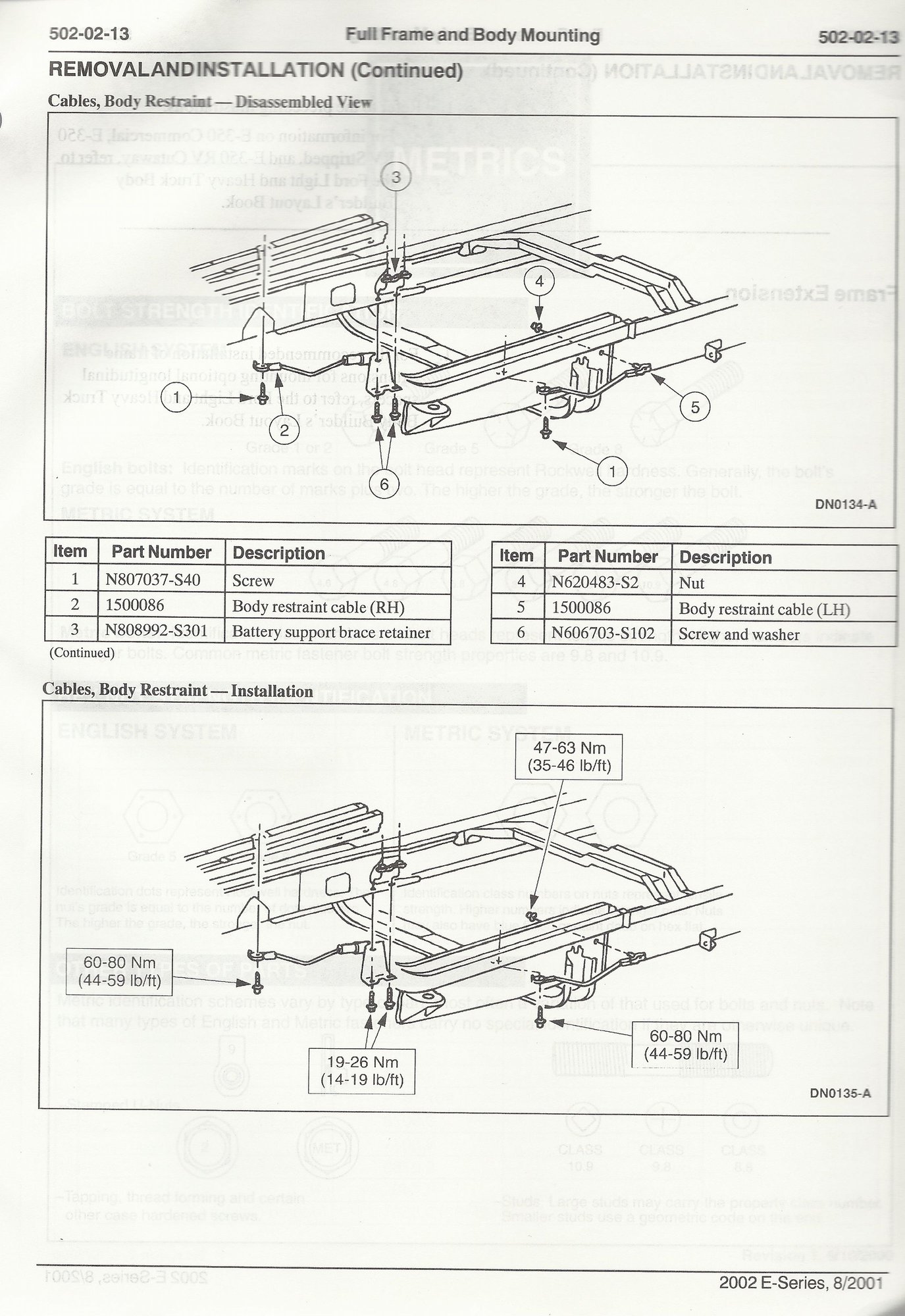

Look at the pics in post #5. The ONLY part numbers listed are the standard aka hardware numbers. Everything else only has basic part numbers that are worthless, because there's no prefix and suffix.
Suggest the OP go to a dealer and get the complete part numbers. Normally I could help, but my microfiche viewer bulb burned out.
It's not EZ to find locally, so I'll probably have to order it. 25 bucks plus shipping.
No argument there---for the exact part number including prefix and suffix the dealership has that info based on the VIN. At least that's my experience with my local dealership.
If I correctly understand numbers shown in drawings like above are "group numbers" that identify one aspect of a part: brakes, body, engine etc etc. The prefix ID's the year and model, suffix indicating various modifications of any one part.
My knowledge here is probably naive at best but it does help me understand most of Ford's parts drawings.
