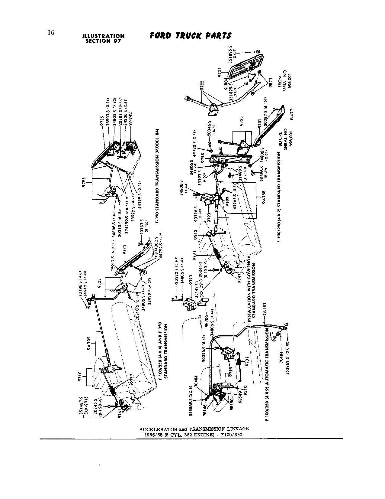

Does anyone know the bolt size for the throttle cable bracket that mounts to the intake manifold on an FE engine? See area circled in red in the attached pic.

Bolt (bracket to engine) - 5/16" - 18 x 5/8" hex. head

Which bracket is it, 9723? If so, see Chad's post #2.

Yes, It's the 9723 bracket
