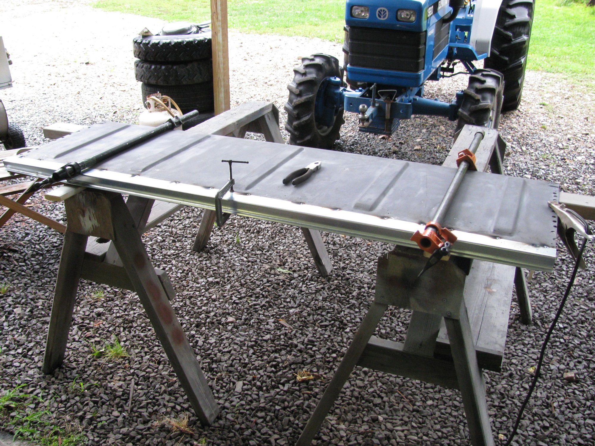

If you are talking about the one at the very front I had that stuff made for my bed. You need to find a shop that has a press break big enough to bend the metal without putting a bow in it. If my memory serves me I believe the front cross sill was 13ga. and the bulkhead was 16ga. If it is the front one, that is only one that does not require that joggle to be in it nor does the bulkhead need the joggle. All you need is some flat bar shims on top of the cross sill ends to raise the corner pieces up to the same height as the bed floor. I can't find a picture of the cross sill but here is one of the repair to the bulk head.
