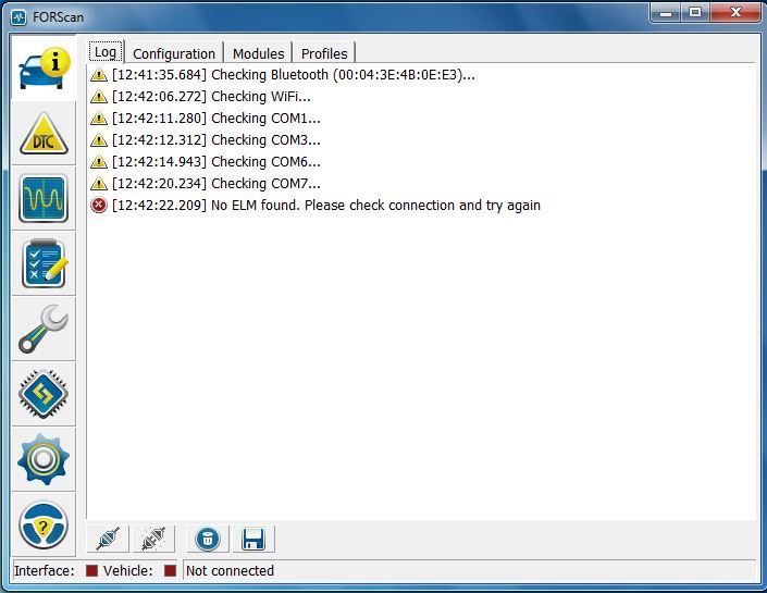

My OBDLink MX Bluetooth arrived this morning, so I gathered up all the spreadsheets, instructions, and laptop specially set up with Windows 7 that I have spent a week studying and prepping, and ran down to my truck.
I plugged the module in and paired it with the computer, no problem.
Opened Forscan and tried to connect. Problem.
It went through checking all the possible connections - even showed a bluetooth device address, but ultimately reported No ELM Found.
So I tried the OBDwiz native software for the OBDLink. It showed the device paired with the computer, but also failed to connect.
I have searched the OBDLink forum and this one for this problem. I found a couple on the ABDLink forum but no solution posted.
Is there something easy I'm missing?
Oh yeah, I uninstalled and repaired the module to ensure it was installed correctly. It does show up in the devices and printers section, and the computer reports the device is working properly. So I'm kind of at a loss at this point.
Help is definitely appreciated.

I ran into the same thing when I first tried mine. I was able to get it to connect and I am trying to recall what I did -
just double check you unclicked demo mode in forscan and then in the connection tab I believe I had to select blue tooth specifically. I'm looking as we speak.

You got the adapter to connect with the computer but I think the issue is that Forscan does not know to look for your bluetooth - I know despite what the screen messages show.

It had "auto" selected on the connection tab. I've changed it to "bluetooth" so I'll see what happens when I try again.
I also have a USB wireless mouse that I'll disconnect just in case it's somehow using the same com port.
Since the device fails to connect to Forscan or the OBDLink software, but it shows up paired in both applications, it has to be something common to both. I kind of doubt it would be a simple setting. More likely a hardware issue, so I'm suspecting the OBDLink module.

Thanks guys, it's working now! It was one of two things - the only two I changed. I disconnected the wireless USB mouse, and under the connection tab I changed from auto to bluetooth as Bernie suggested. If the mouse was the issue, it would because both applications were trying to use Com 4, though I don't know for sure what com port the mouse was using. It was a "just in case" kind of thing. I really think it was Bernie's suggestion that fixed the issue.
