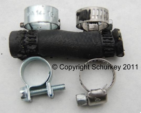

Ever see these clamps? They are EFI fuel line clamps.
