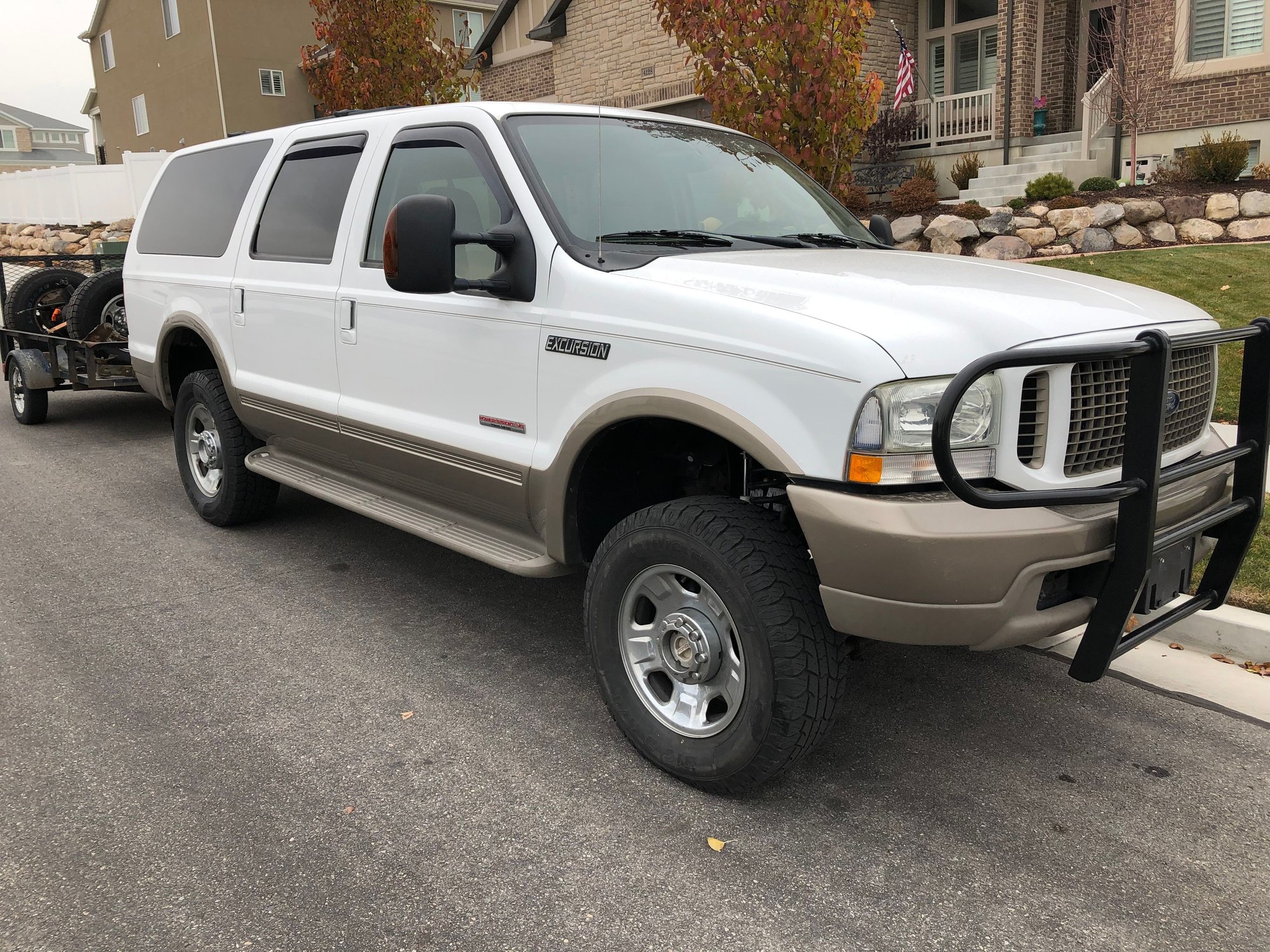

Stock from dealership

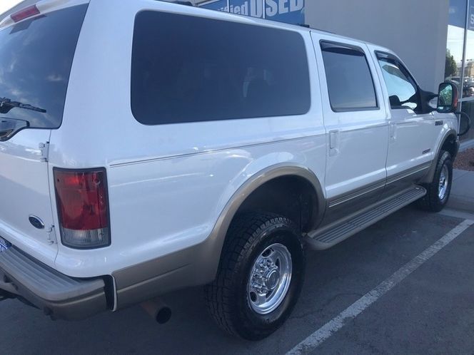

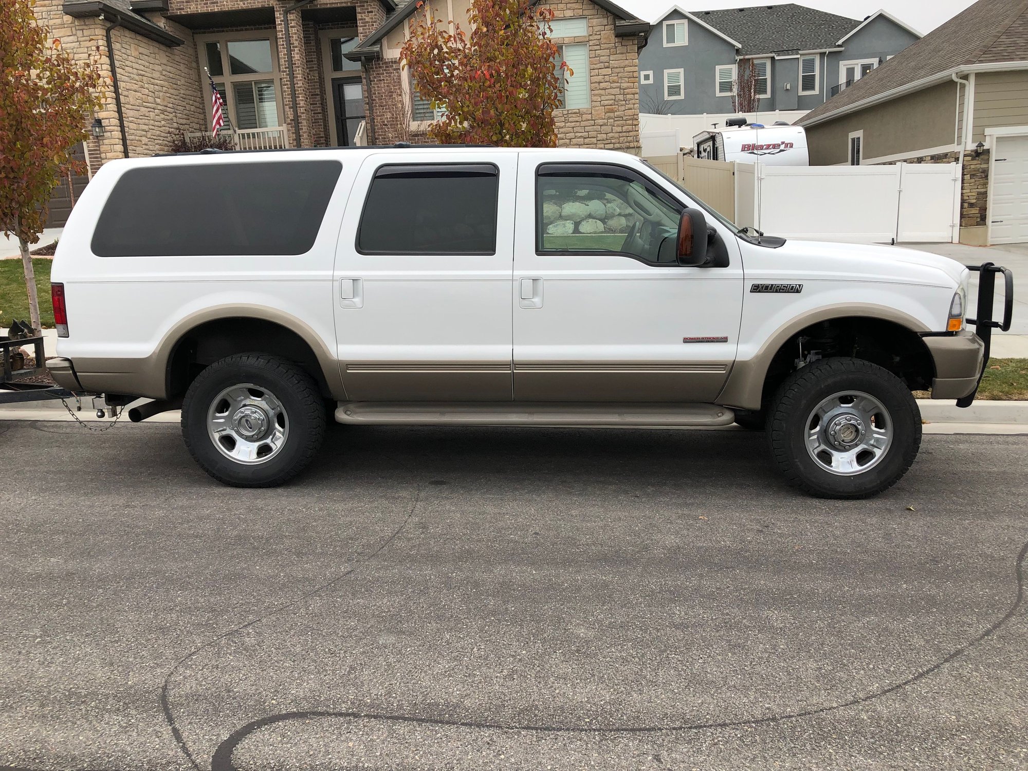

I started with the cleanest 2004 X I could find to build. I found a 1 owner 6.0 with 126k. It already had an EGR delete and airbags with onboard compressor.

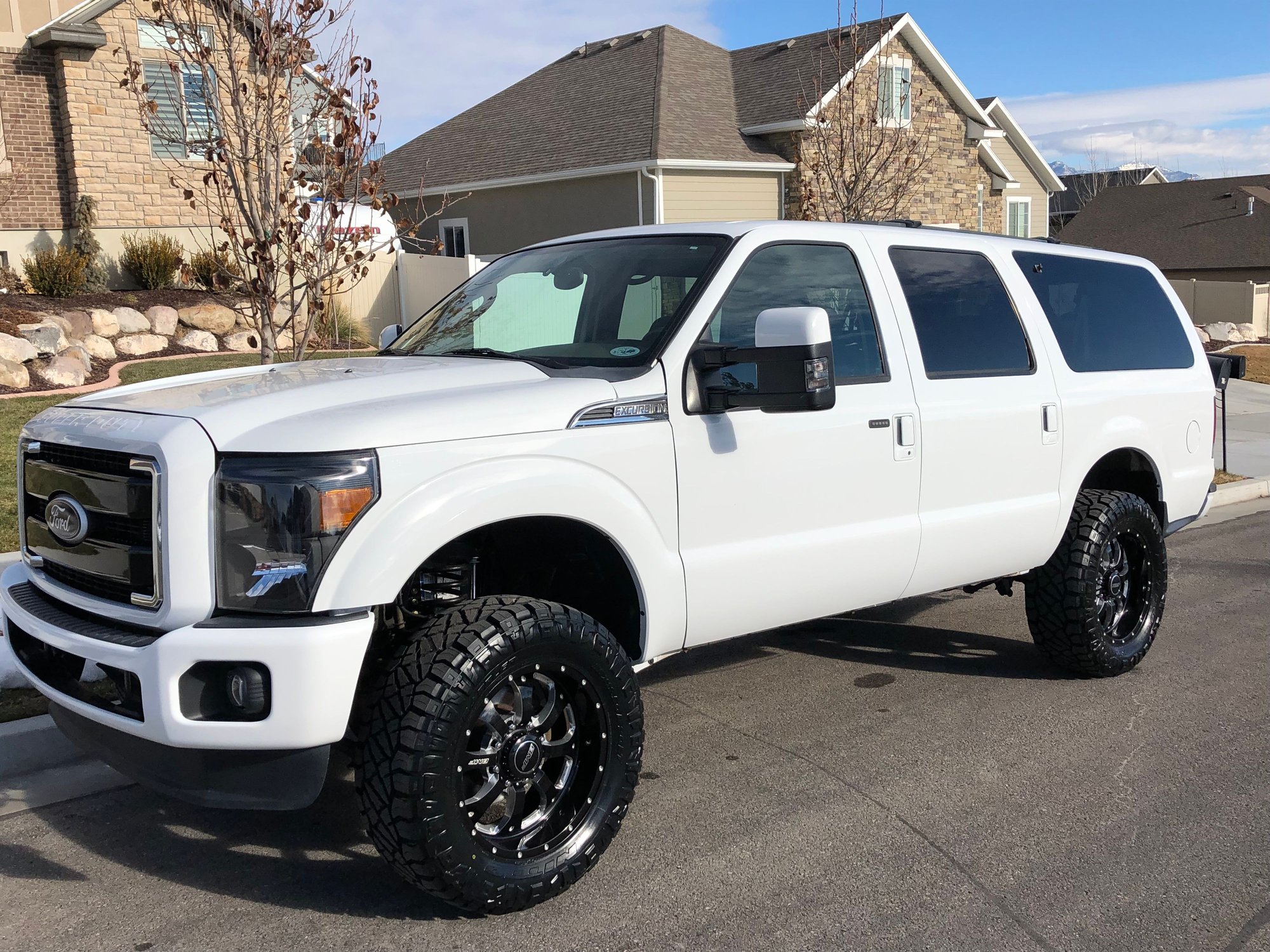

i removed front and rear axles from a 2006 F250 with corresponding hardware and brackets needed for the conversion. I did end up buying new coil buckets and radius arm mounts as those were riveted on the donor truck. I wanted the coil set up for a couple reasons: better turning radius, bigger brakes and better handling/ride. I also had a shop put these on. A big thanks to NicMike for helping me through the process.
I also installed a level kit.
3rd

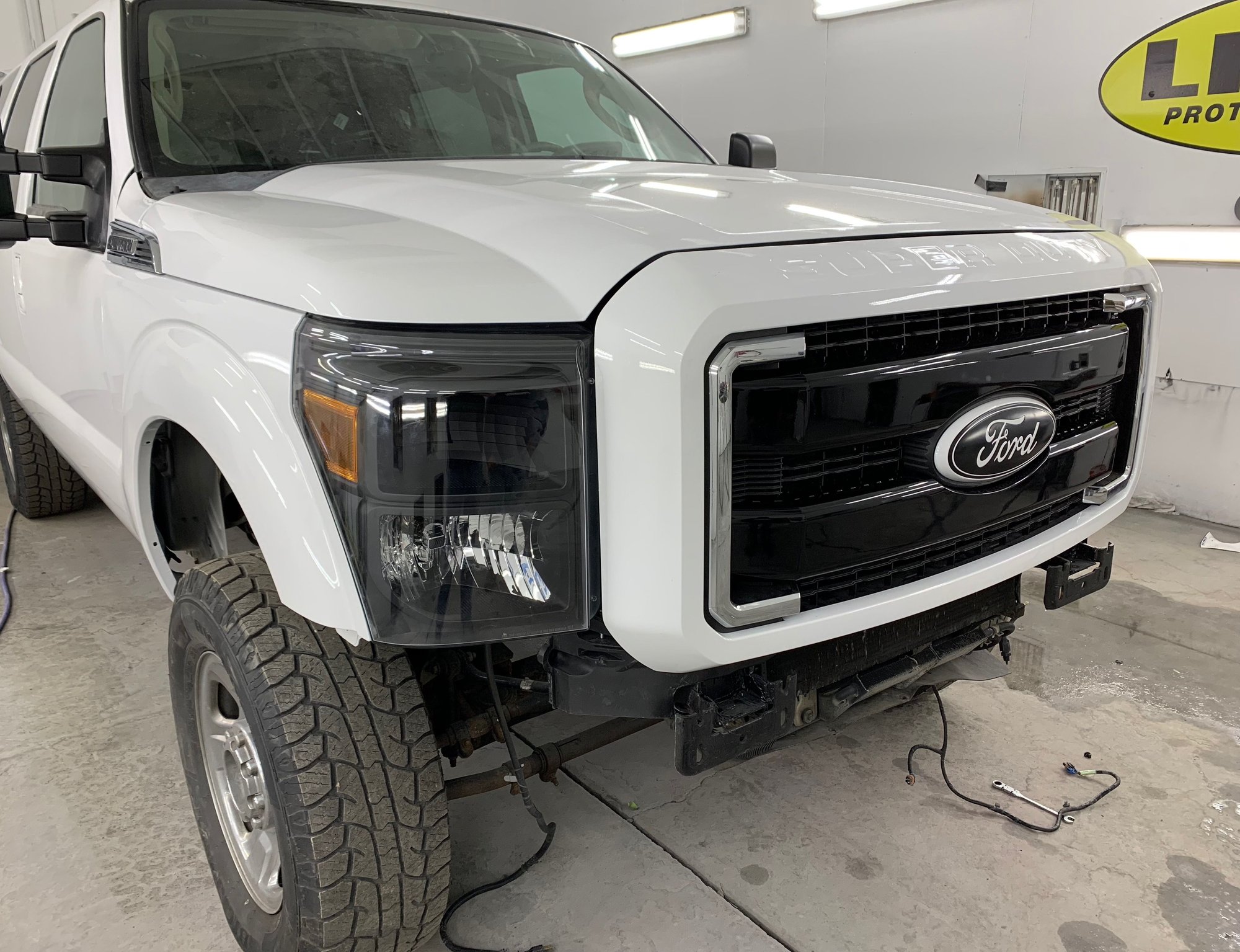

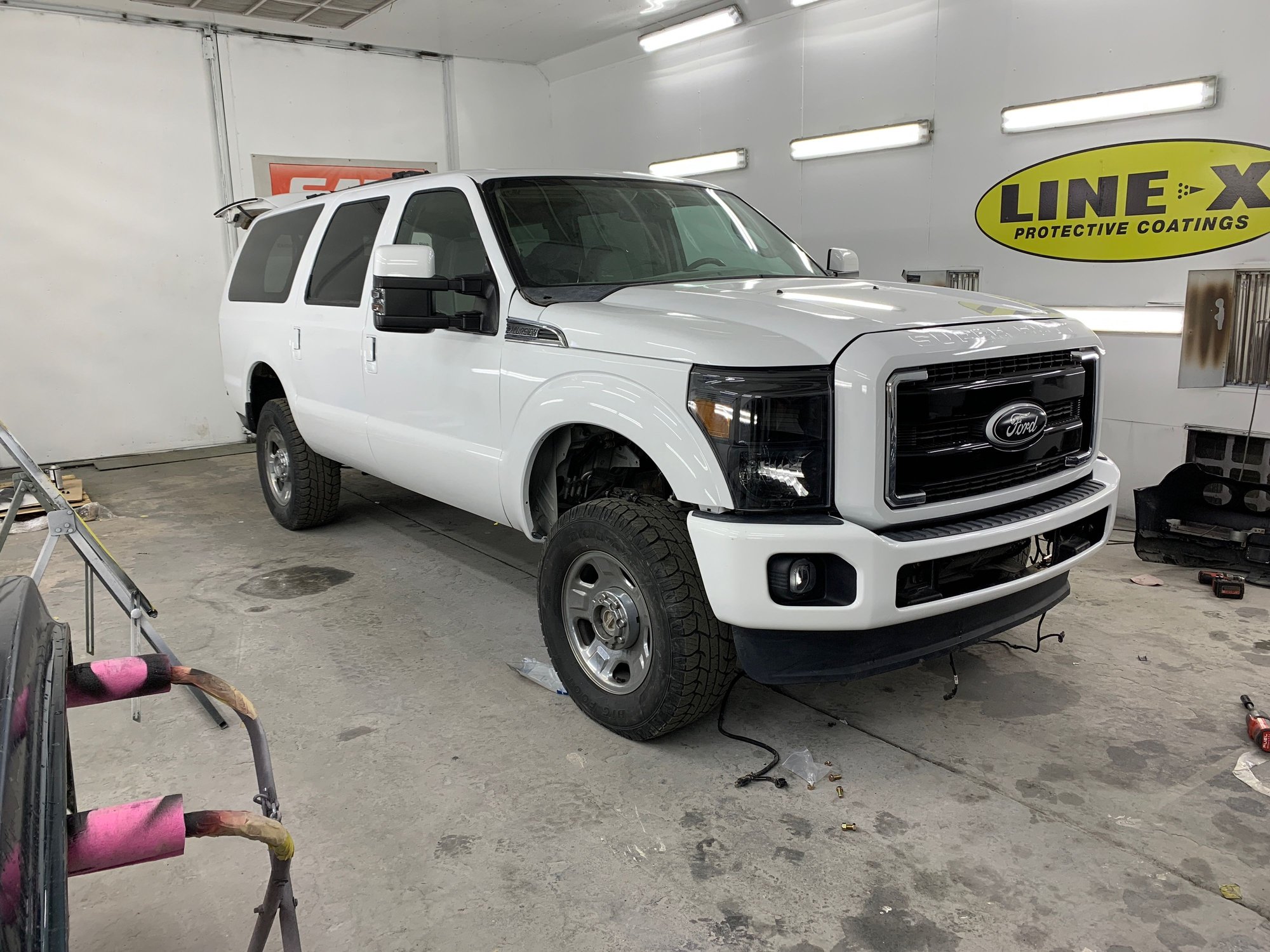

i wanted to update the front end to look more modern. I decided to go with a 2016 conversion. I had a local shop do this conversion. While half way into the job we noticed the paint on the roof was chipping off so I decided to re paint the whole thing and remove the cladding. I like the look of paint match bumpers and decided to go that route as well.

Ride quality IMO is better it doesn't feel like it wants to wonder like it did with leaf's, it could have been the truck was sitting on old leaf's and needed to have been replaced. Turning radius is much improved since you don't hit leaf's. Also your going from a dana 50 to a dana 60 which is a strong larger axle with big brakes and its noticeable. I kept with the 3.73's that the stock axles had so no change there. Overall I am happy I did this mod, I have not towed with it yet but I don't foresee any issues.
