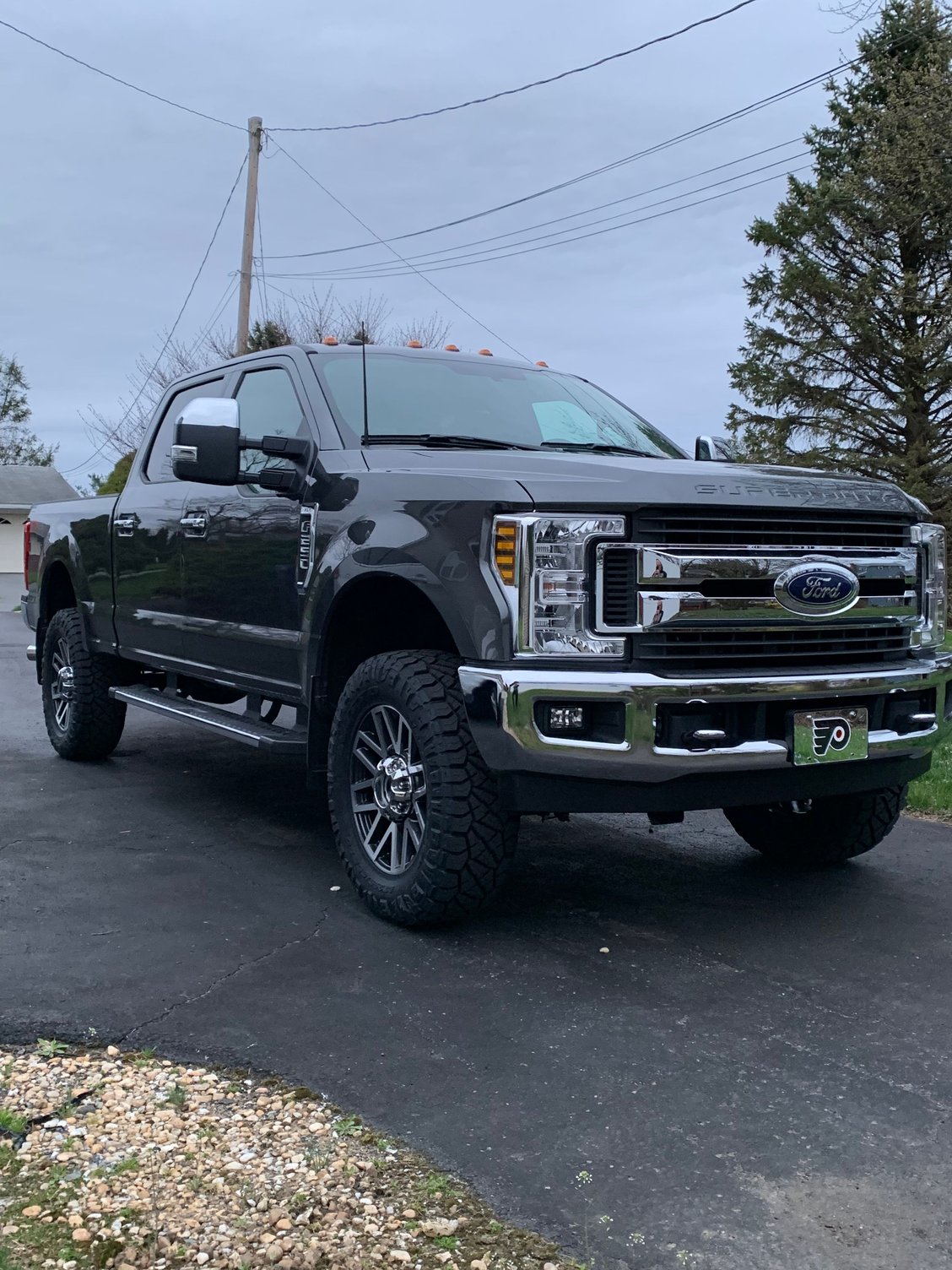

I just had a 1” BDS level done last week and replaced all 4 shocks with Fox. I have the plow prep and heavier springs, and honestly I would do 1.5” if I was you.
Old Apr 15, 2019 | 04:43 PM
Jointasset's Avatar
Jointasset
Posts: 300
From: Tampa
Motown- how’s the handling of your truck w just 1” of level? Any alignment correction needed? Looks great BTW
Old Apr 15, 2019 | 05:12 PM
Motown82's Avatar
Motown82
Joined: Nov 2018
Posts: 73
Thanks! I also added 295/65 Ridge Grapplers at the same time as the level along with the 4 Fox Shocks. The handling so far has been fine. I had it aligned but not really sure if it needed it. So far the only negative I found is that it has a bit more bump steer but I know this is from the tires. I’ll be adding a steering stabilizer shortly.
On a side note and off topic I also added a pedal commander as well this past weekend. I wasn't a believer but have to say so far I am really impressed. There is no power gain from the PC per se but it sure as hell feels like it. Definitely gained back any loss of power from the bigger tires.

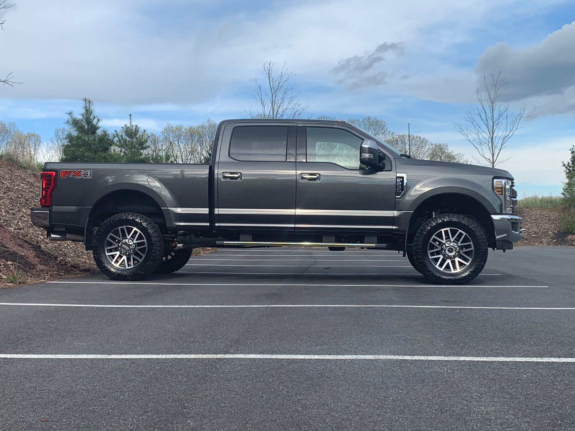

Here is a little better pic
Old Apr 24, 2019 | 07:49 AM
BocaIvan's Avatar
BocaIvan
Joined: Feb 2018
Posts: 361
Looks great Motown82!
Have you measured the difference from front to back yet?
Old Apr 24, 2019 | 08:45 AM
Motown82's Avatar
Motown82
Joined: Nov 2018
Posts: 73
Thanks! I have not measured it yet but am guessing that there is still around 1-1.5” of rake which I actually like. I also have the plow prep package as well.
