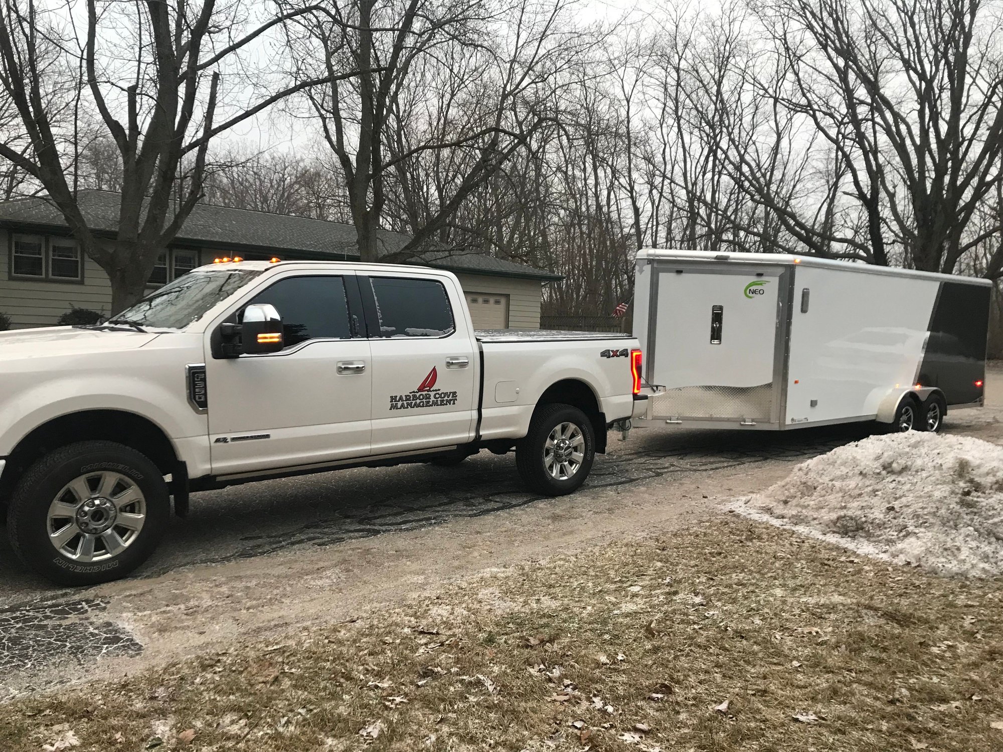

I’ll try to make this as short as possible
2018 F-350 6.7
about 11k miles
I had dealer when new turn the diesel parcticlate % display on
since I’ve had it it always gets up to 99% and the. Regens
Fuel mileage always plummets
smells terrible
and I watch it on the display as it counts down to 0%
no problems
well this past month I’ve done 3 separate trips pulling a 24’ enclosed snowmobile trailer up north
each about 400 miles 1 way
I noticed the first trip that the % meter never moved from 0% and I put almost 1000 miles on
It was -18 to single digits the entire trip
figured that had something to do with it
so I get back and use the truck without towing and throughout that week the meter got to 45% before I left for next weekends 1000 mile trip towing again
i believe the meter started at 45 and got to 60 before I realized it regen all the way to 0 again
remainder of trip up and wat back meter didn’t move
also leaving the hotel up north letting truck warm up for 20 minutes I noticed it smelled like it was cleaning exhaust at idle. Also interior cab smelled for awhile inside
third trip that I just got back from my meter was at 75% before I left and once again. It never moved and then went to 0 within the first 40 miles of trip. Stayed that way until we got back 806 miles total
same thing.
This morning while warming up smelled like it was regening and I’ve come to think that maybe it for some reason just regens the entire time while towing??
stop for fuel and it smells
kinda sounds like it also while accelerating when off the highway
also I didn’t think anything much of it as I’m towing and don’t expect good mileage
but going 75mph basically the whole trips just stopping once for fuel I only average 9.5-10.2 mpg
24’ enclosed V nose trailer. Prob total weight is 4000lbs
i pulled very simular trailer with my older 2014 6.7 and would get 12-13mpg
so I’ve come to think there’s something wrong
going to call dealer tomorrow but didn’t know if anyone has any ideas
thanks
Dan
