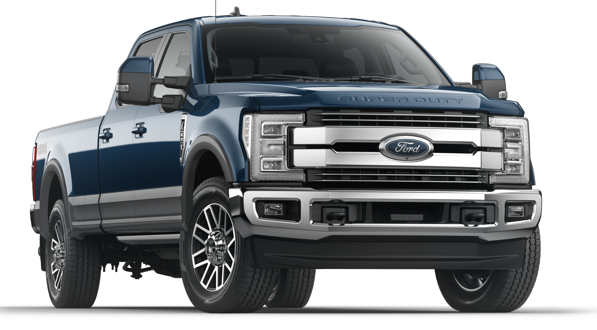

I have a 9000 lb. travel trailer and a 32 foot boat. That's all this truck is ever going to pull, so I'm avoiding all the suspension "upgrades". No snow plow, no camper certificate, no 5th wheel prep etc.
I am going with the long bed for the larger fuel tank and upfitter switches because I've never had them and want them,
2019 F250 Lariat Ultimate 6.2L

Nice looking truck.
