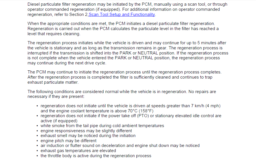

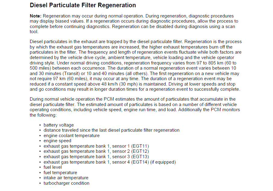

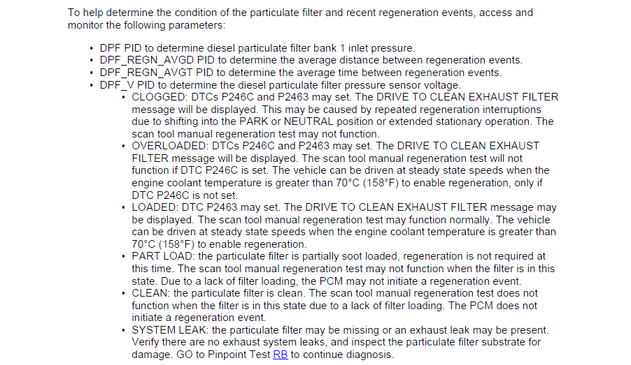

From the 2016 Service Manual
There are other references in the service manual that state if the Distance Since Last Completed Regeneration/Normal Distance Traveled Between Completed Regeneration events is not between 60 and 500 miles, there could be internal damage to the particulate filter.

I interpret the above a bit differently. If the DPF goes longer than 500 miles between regens then it is not operating as designed. The PCM monitors soot load as well as miles driven since the last completed regen. Others have reported while monitoring with a scan tool the truck will enter a regen every 500 miles.
I'm not stating you have an issue with your DPF but rather it's more likely you missed the cleaning exhaust filter notification(s).
