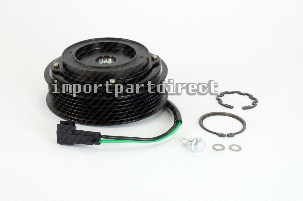

Most clutch disks have holes in them to hold it from turning, This one is not designed like that:

I got it! Stopped by Home Depot and bought a 4.5" channel lock type pliers and gripped the clutch with them while torquing the bolt. It was a tight fit. Crazy thing is after I tightened it the ratchet fell into no mans land. I took the inner fender out, couldn't find it. So I tightened the bolt again since I had better access. I found the wrench, slid 1/2 way down the radiator support, took an hour to find it..
