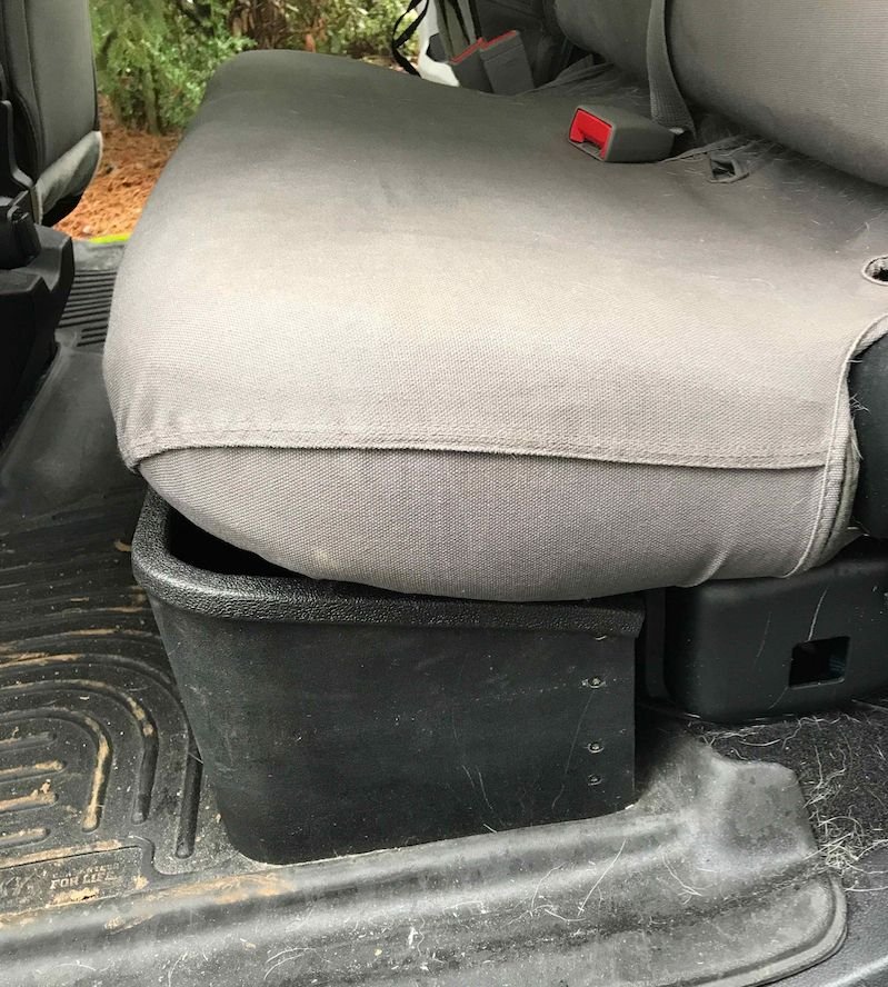

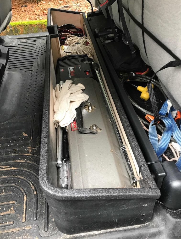

Not exactly what you are asking for, but may give you some ideas. I have an extended cab and the box I built butts up to the underseat storage. Built out of plywood with kerf bent corners; spray on bed liner; automotive trim around the top lip.
