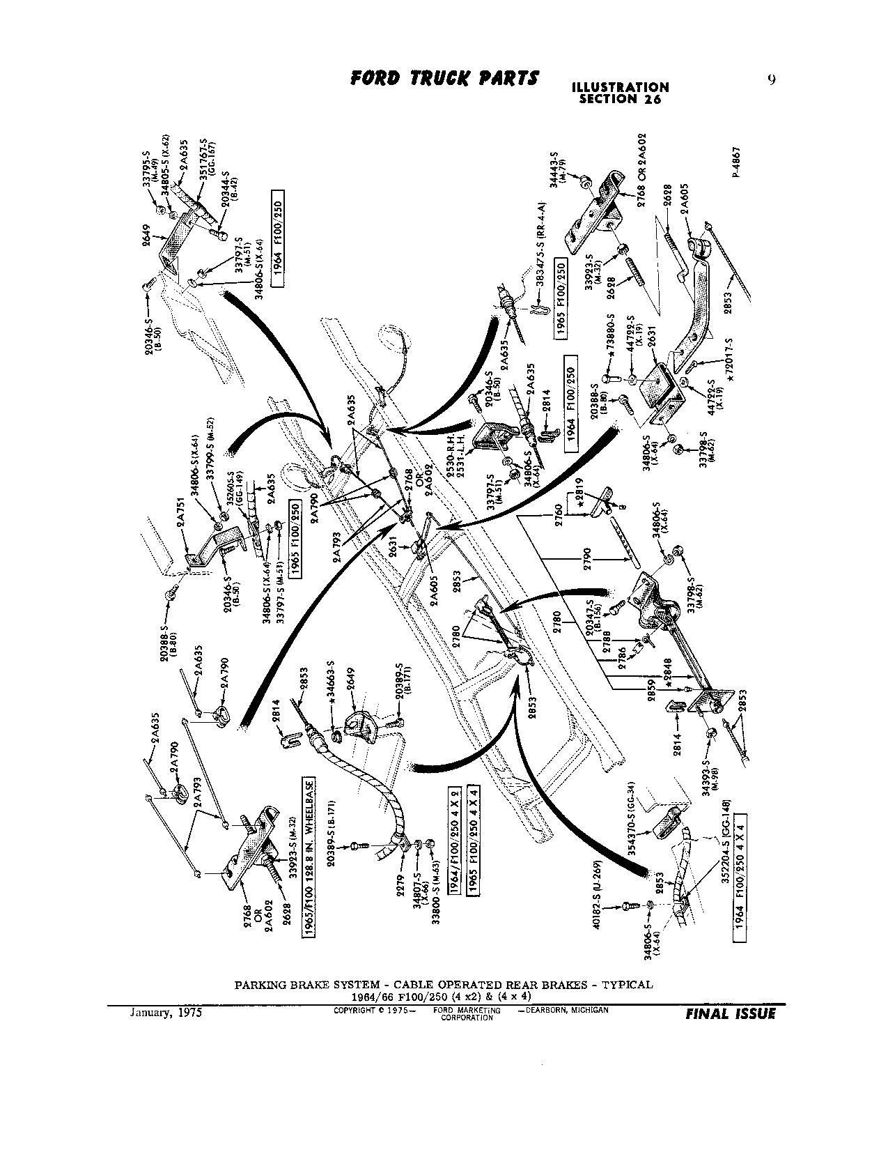

Originally Posted by Christmas
I have a 98" with 43" housing and it's about 10" too long. Seems this the only one offered for 65-66.
I have another one that is 85" with 37" housing that is too short (C6TZ-2853-B = 1966 F100 4WD).
See 2853 in pic (click on it twice to enlarge it):

Originally Posted by TA455HO
This is the extension part number. F100 only.
65/66 F100 (Model 81) - 128.8" W/B
C5TZ-2A793-A - EXTENSION ASSY. - PARKING BRAKE CABLE 14" long - 2 each
Chad
2A793 in pic at lower left:
