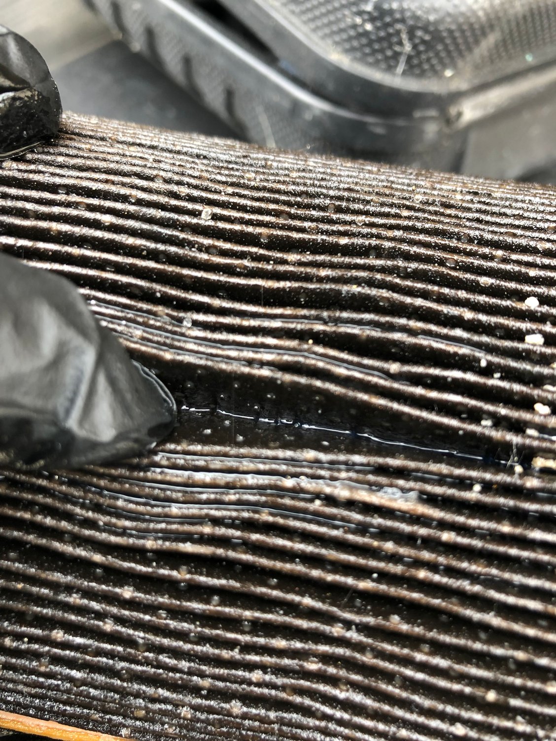

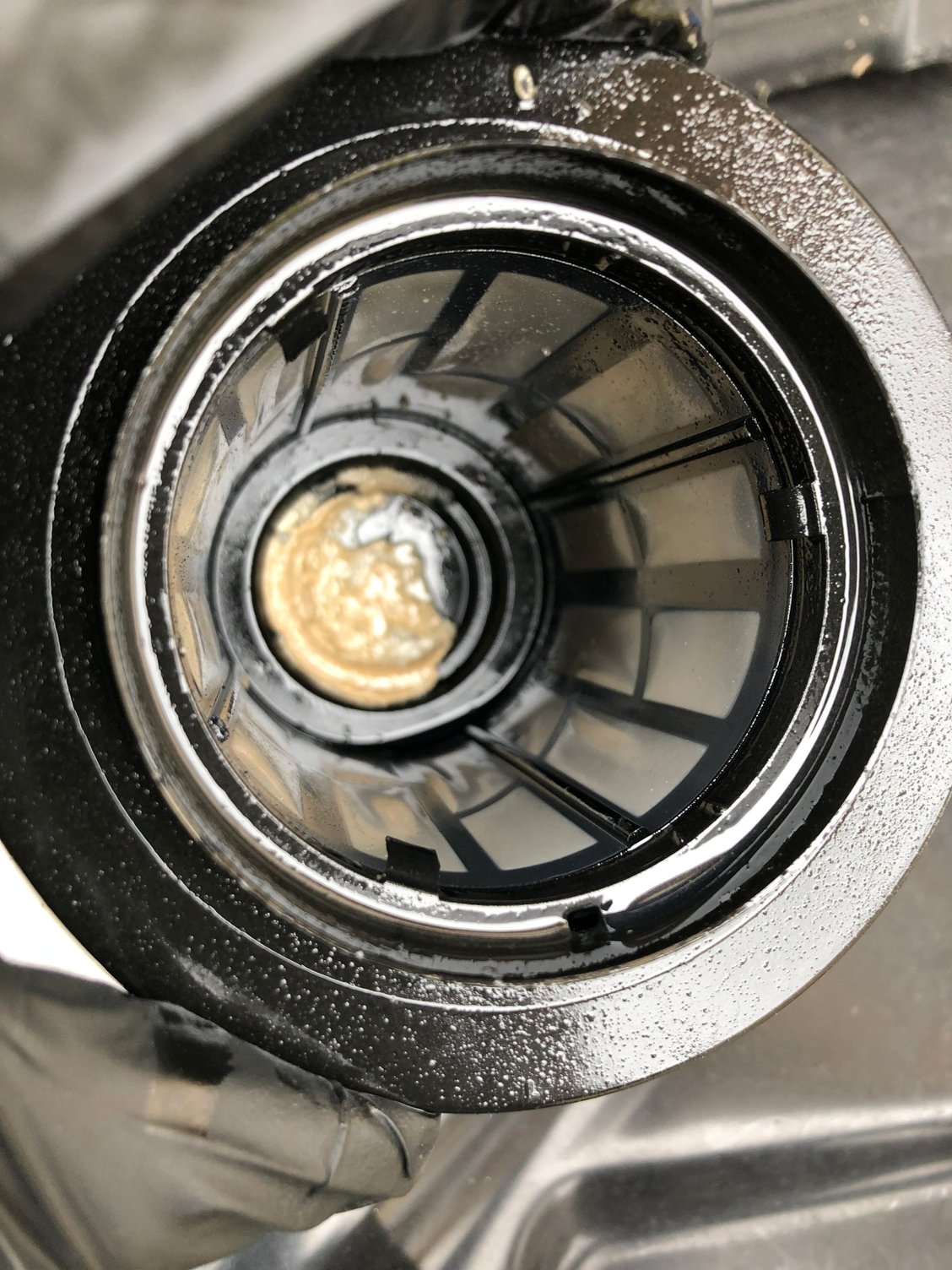

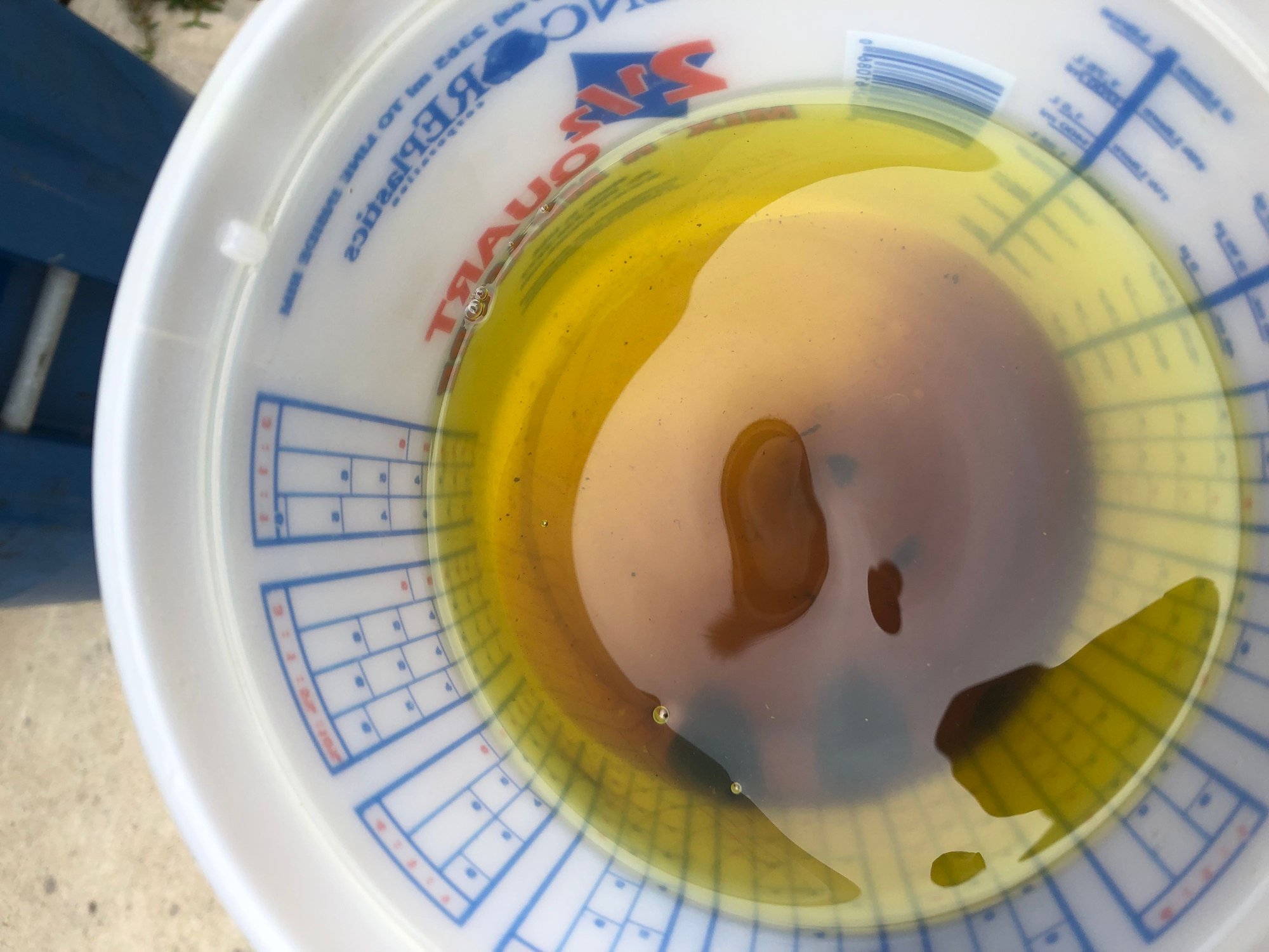

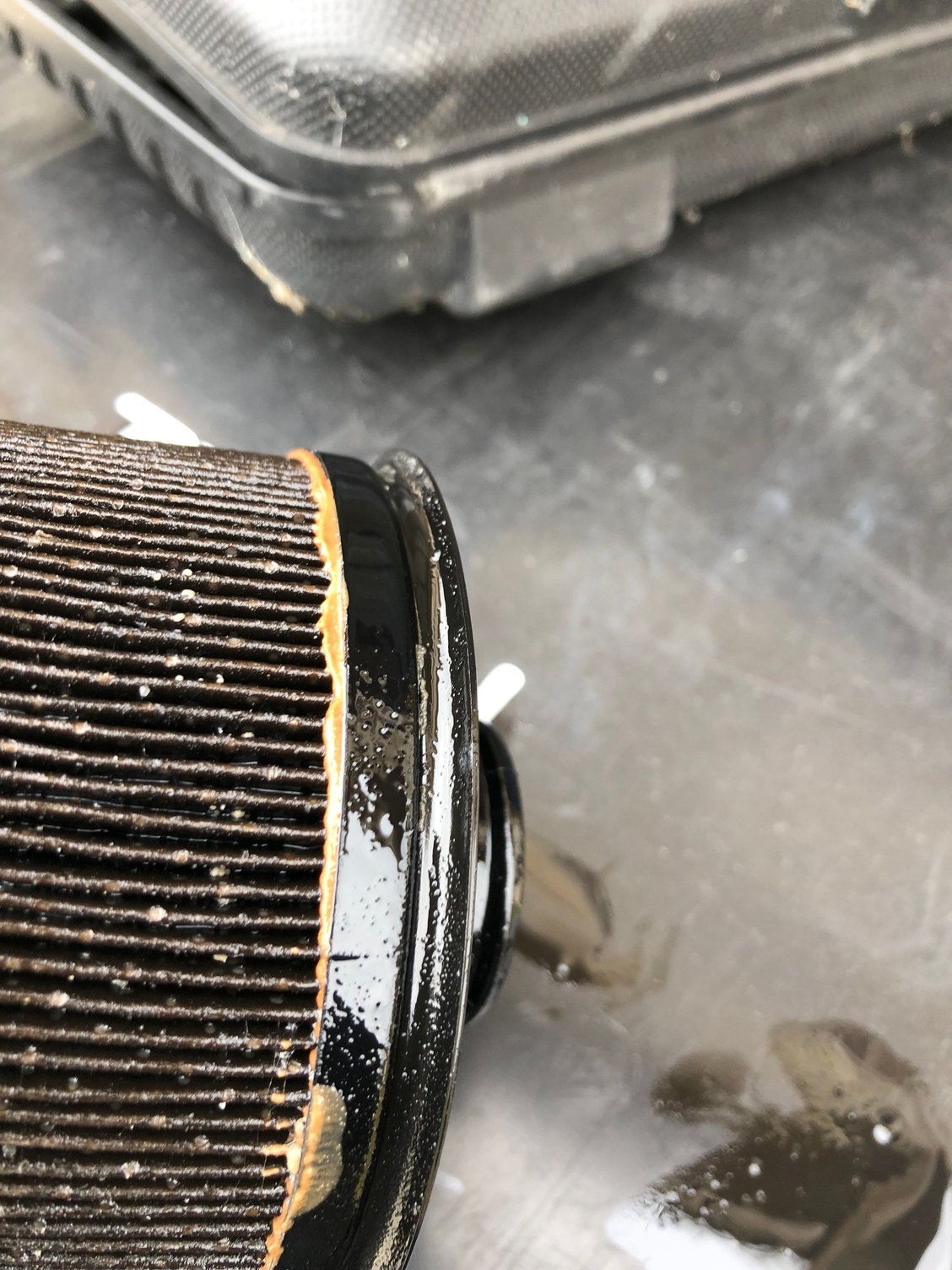

hello guys wondering if yall can help me i heard a loud humming sound comming from my fuel pump amd later got the diesel reduce power code drove home and
change the fuel filters, filters looked bad and the diesel drained had some brown liquid im in the process of draining my diesel now. Should i be worried its my truck toast ? 2014 6.7 with 88,000 miles

That filter looks terrible, change interval is way overdue. Hopefully you didn't cause any damage to the HPFP.
Normal Operation = Every 22500 miles (36000 kilometers) or as indicated by the information display.
Severe Operation = Every 15000 miles (24000km), 6 months, 600 engine hours, or as indicated by the information display

I kept hearing a loud buzzing noice comming from my fuel pump later i had the reduce power so i took it to the dealership hr later the contact me telling me if was fuel contamination and to contact my insurance i did and after months going back n foward the insurance took fuel samples and fuel had no metal sand water just puer diesel so they dint cover me so im trying to figure out whats next

Typically the buzzing is from the LPFP. Are you talking about the frame rail unit (DFCM)? In this case, I can see why it was noisy.
Has the HPFP already self-destructed? If not, any metal bits in the pleats of the filters? Unsure if the HPFP can be accurately inspected. I assume it's cheaper to replace and clean prior to it sending shrapnel throughout the system.

Looks like the nasty stuff I drained out of my 86 F350..guy I bought it from was dumping used motor oil in without filtering/cleaning it...

the dealership wasnt much help they basically just put diesel in a bottle and claim thats it was diesel contamination beacuse of the brown stuff in the diesel

Your original post states you were in the process of draining your fuel. Did you check the tank for contamination similar to the gunk that's on the filter and filter housing?
How is the truck running now? Reduced power go away after replacing the filters?

no with all the hours i been working i havent had time to drop the tank i havent turn the truck on or done anything but drain all the fuel i was wondering too if it had that bacteria fungus i keep hearing about
