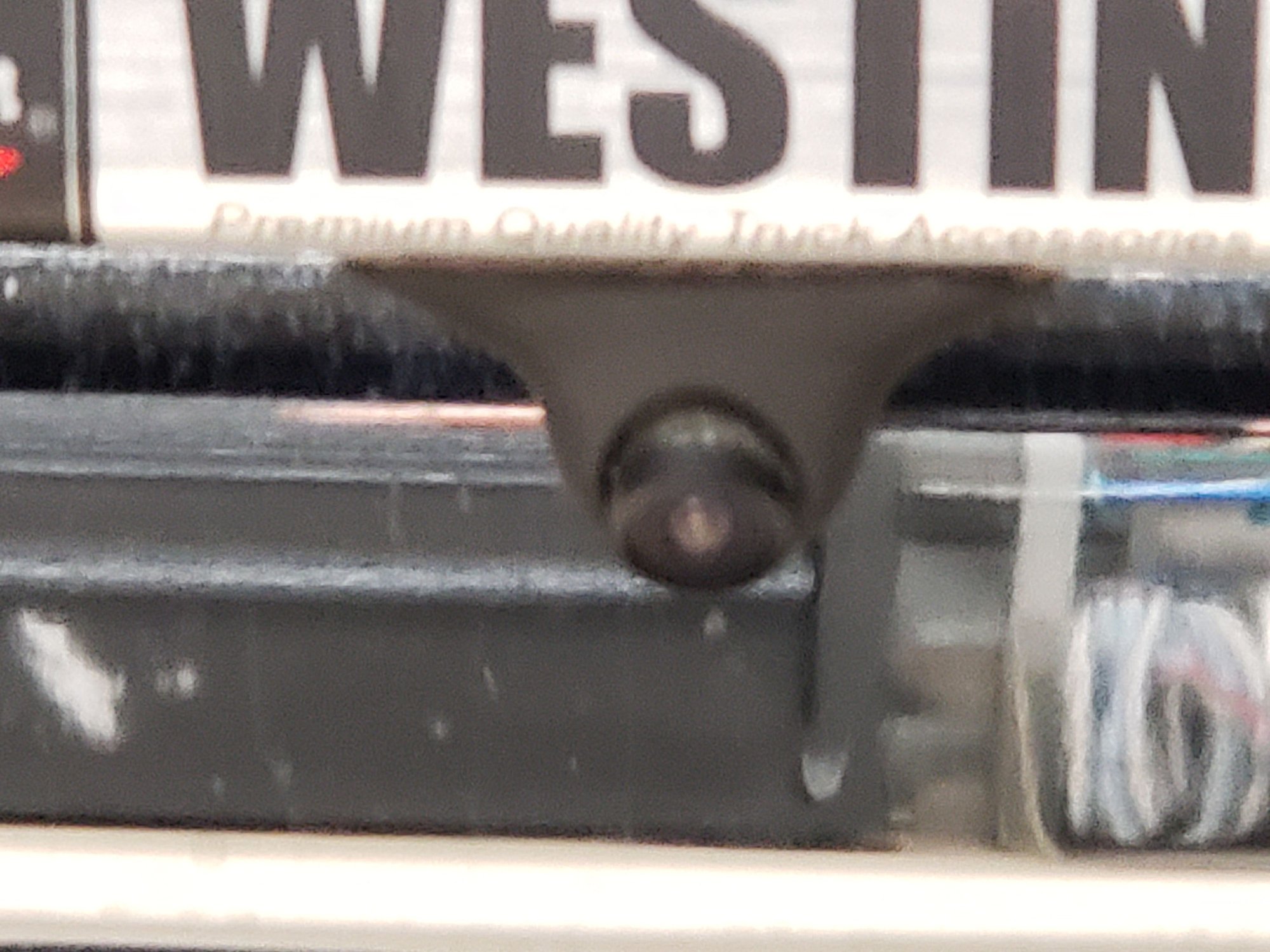

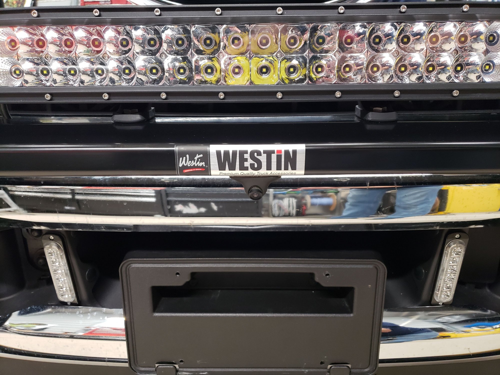

I used a Rostra 250-8160-BSC. It is really small, a rubber housing with 3m tape on the back. I have seen these in grills, under mirrors, and even used under/over the CHMSL light, it worked great for me. I have a Westin Push Bar so I had to see in front of that. I mounted it to the bottom of the mid bar just under my light bar.
To answer another question, I ran the camera cable through a nipple on a firewall grommet. I then sealed it using windshield buttle, that is the thick black stuff they used to use to hold windshields in. The stuff works great for sealing holes, stays flexible, and does not fall out.
Pictures below.
nice work.. didn't ever think about the windshield stuff as a sealer...
