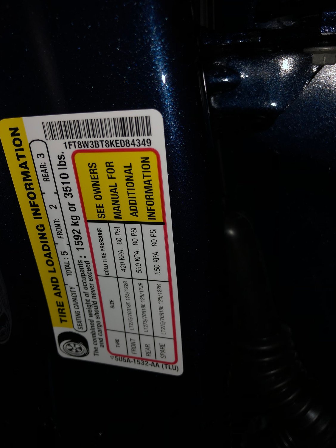

What does the yellow door sticker state for Max combined never exceed cargo weight?
Old Jan 27, 2019 | 12:34 PM
JlaneAK's Avatar
JlaneAK
Joined: Nov 2016
Posts: 68
Originally Posted by Flyct
So we don’t guess, what are the details of your truck.
Diesel or Gas?
diesel
Sticker
Old Jan 27, 2019 | 06:21 PM
Flyct's Avatar
Flyct
FTE Community Team
Joined: Mar 2017
Posts: 3,339
Likes: 1,052
From: Florida
Your truck weight limiting specs are the exact same as my 2019 Lariat CCSB Diesel w/18” wheels
28,700 GCWR lbs (with either 3.31 or 3.55 axle and 11,500 GVWR rating)
15,000 lbs Max trailer loaded weight (conventional trailer)
20,800 lbs max gooseneck towing (with either 18” or 20 tires and Gooseneck)
18,000 lbs Max with 5th wheel towing
Look at your white door sticker and your Rear GAWR (axle rating) should be 7230 lbs
Your Front axle rating will be anything from 5200, 5600 or 5990 lbs depending on if you have standard, HD or snow plow springs
From https://www.fleet.ford.com/resources...e_r2_Dec21.pdf
Old Jan 27, 2019 | 06:28 PM
Flyct's Avatar
Flyct
FTE Community Team
Joined: Mar 2017
Posts: 3,339
Likes: 1,052
From: Florida
Btw, with a 11,500 gross and 3510 lbs payload your empty truck weight is 7,990 lbs with full fuel.
