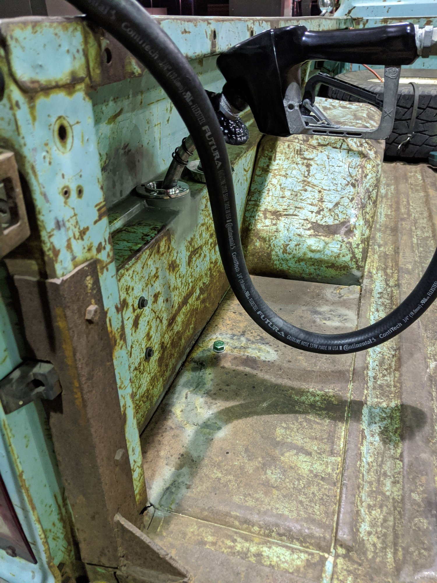

Originally Posted by Lrrr-RulerOfOmicronP
Boat filler. If I had to do it over I would get the filer with a 45 degree angle and do a little more metal work.
I would use this fuel fill if I was doing it again: Amazon link. It is a little tight getting the the fuel nozzle in how I did mine. I may modify it down the road.
Mr. Lrrr,
I am getting ready to order parts for fuel fill. Want to do a door on exterior but that will have to wait, so looking to copy what you did on opposite side.
Can you elaborate more on the need for the 50* filler neck? Does the pump handle not fit well with it vertical?
I'm assuming that to use the 50* neck some sheet metal work is needed to build up a new mounting surface at the corresponding angle.
Also, the Burb tank I have has a 1.75" filler neck. Is your the same and how did you adapt to the 1.5" boat filler?
Thanks.

Originally Posted by smoky_diesel
Mr. Lrrr,
Thanks.
Yes, the fuel nozzle does not fit as well as I would have like. My bed is pretty much beat to hell so I will "adjust" the bed side until it works.
I had to do a little sheet medal work anyway so the angled filler would not have been much worse.
I adapted the end by getting a small section of 1.5" filler hose and installing it on the filler then putting 1.75" filler hose over that. It was relatively tight. I think I had to use wd40 to get it all to slide together. Nothing leaked when I filled it up so it is working so far.
