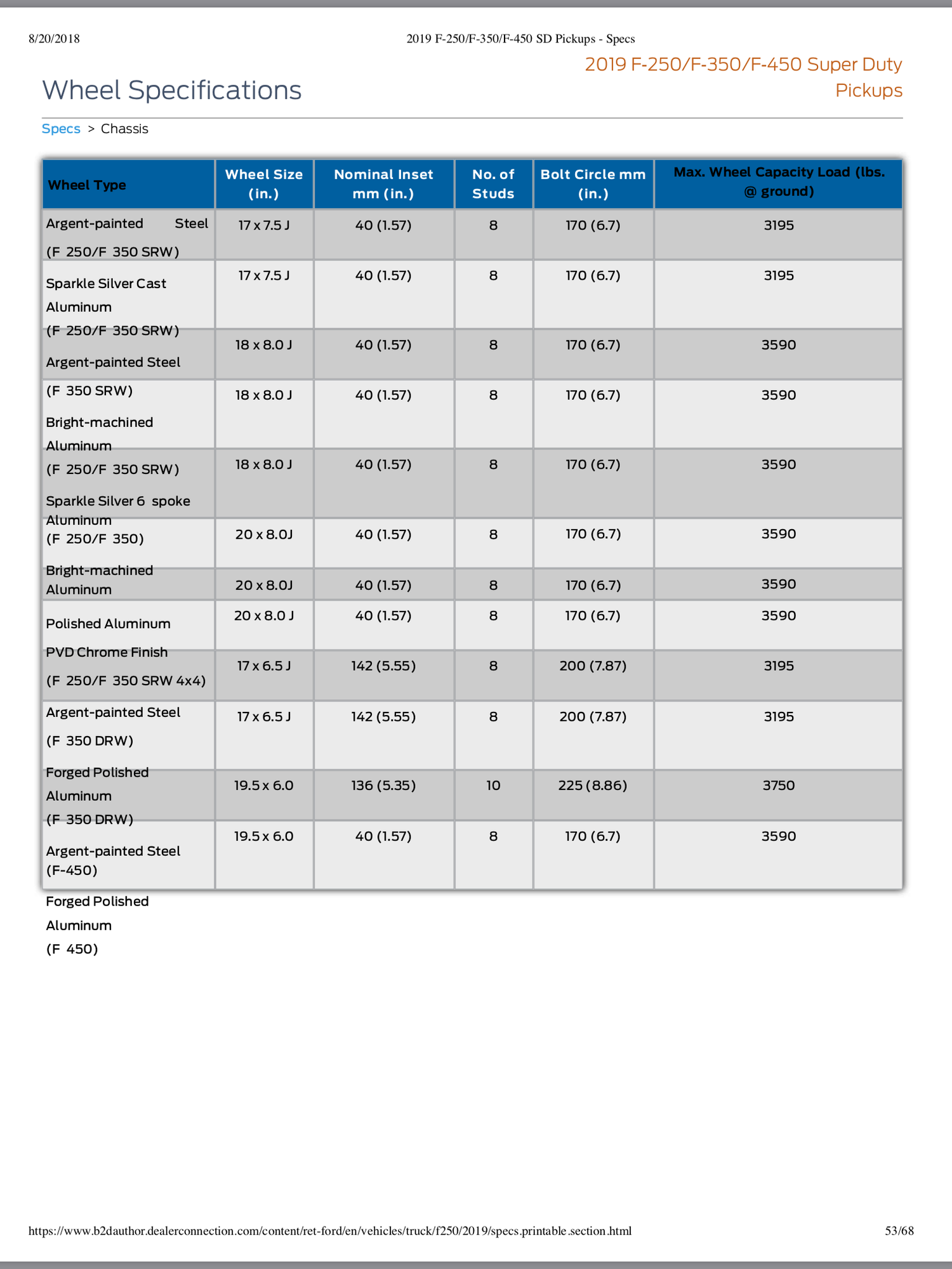

Lariat 2019 with stock 18 inch wheels. How wide are the stock wheels? Could I go with a 1 inch wider wheel and still use the stock tires?

Hey, Randy;
Here are the 2019 SD wheel specs. The left column formatting is a bit off, but it can be deciphered.
HTH,
Jim / crewzer

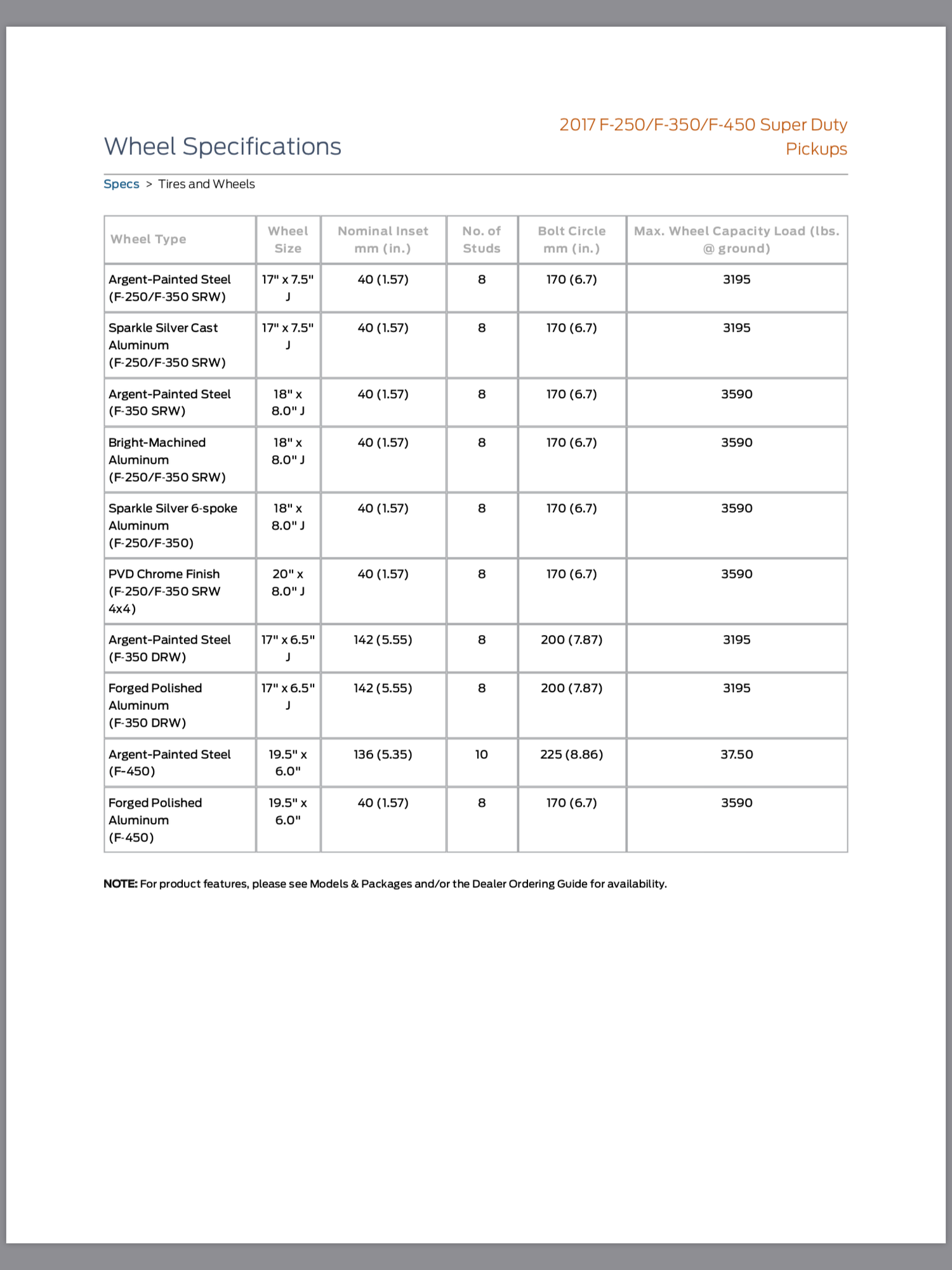

Here are here the 2017 SD wheel specs. They appear to be the same as the 2019 specs above, but the formatting is better.
HTH,
Jim / crewzer
