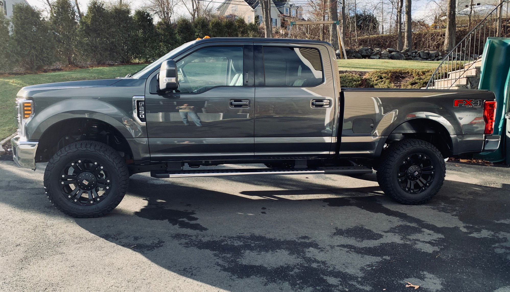

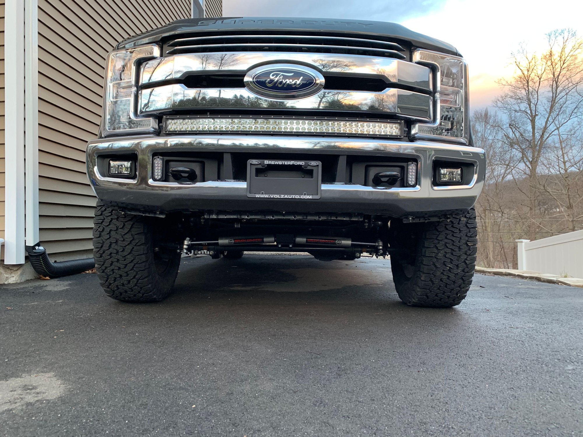

I’m getting stock length shocks because the rear is stock and the front is leveled with a Readylift 2.5” with shock bracket extensions. I put on the RC dual steering stabilizer and it eliminated 100% of bump steer. Used a lower track bar bracket and went with 20”x9” +18mm wheels wrapped in 35x12.5 KO2s

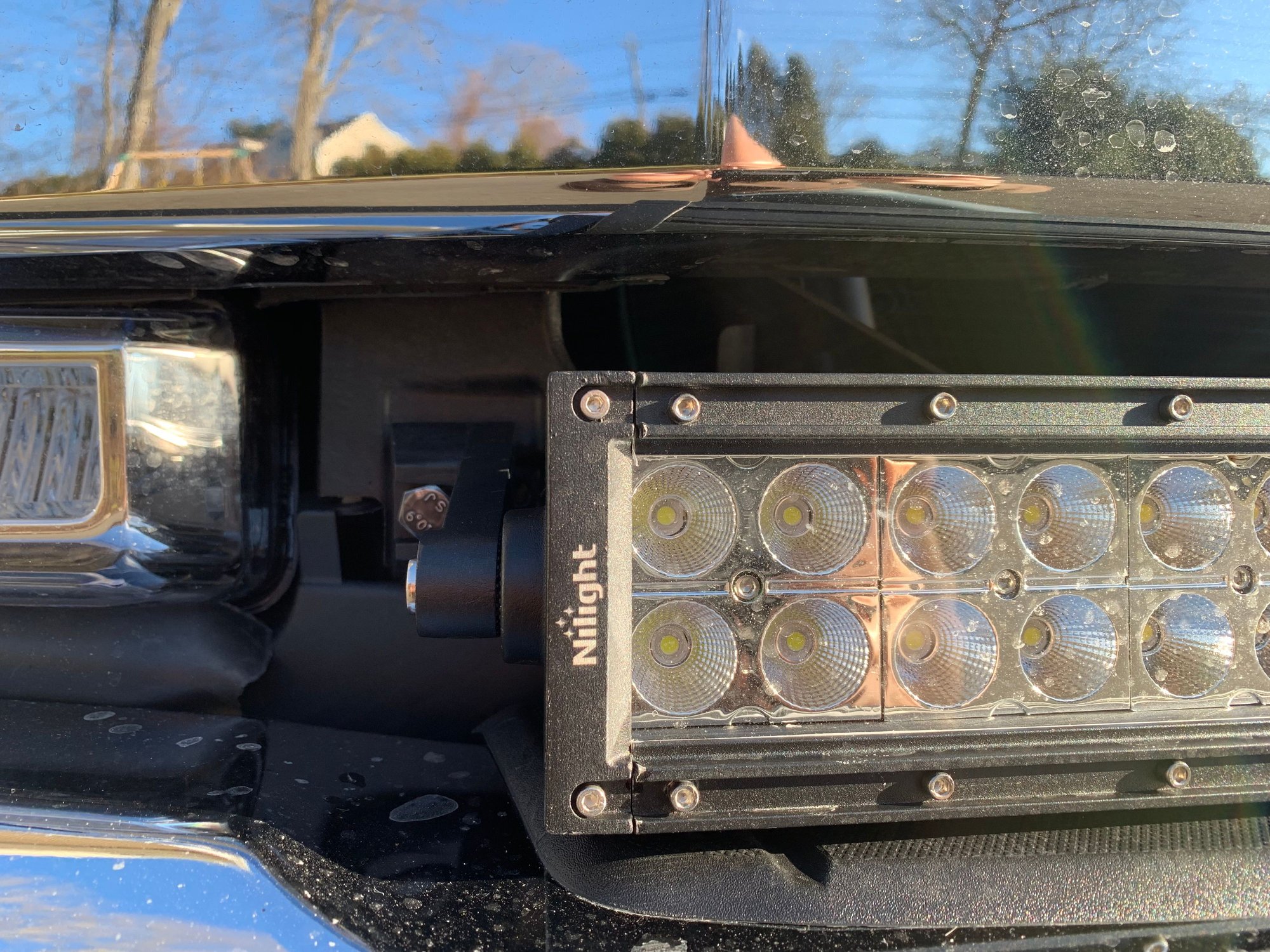

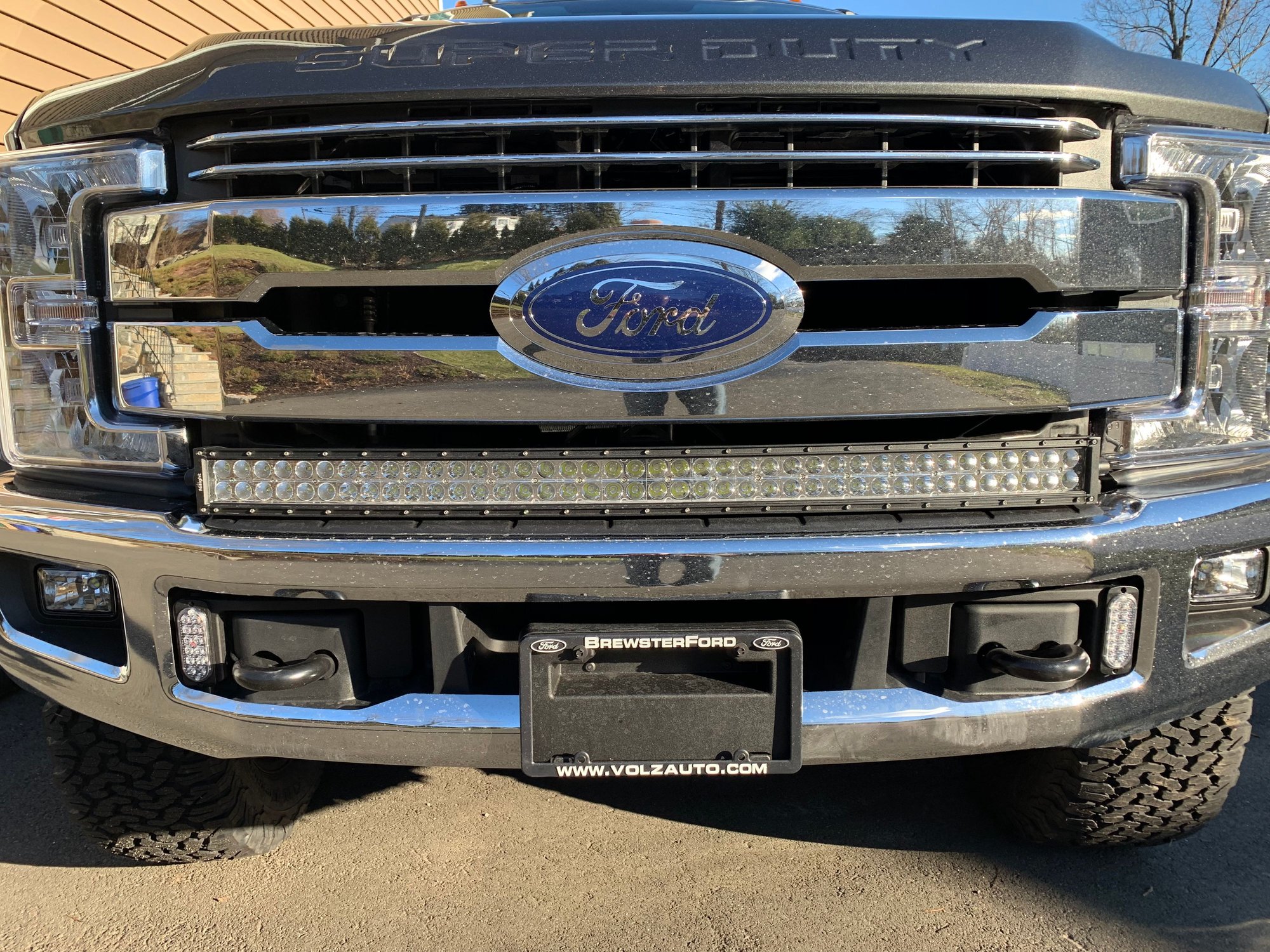

It’s a 42” curved bar from
Amazon Amazon
I Had to cut the bottom part of the grill and then the light bar just tucked in perfectly and bolted on to the grill back bracket where the grill clips on.
