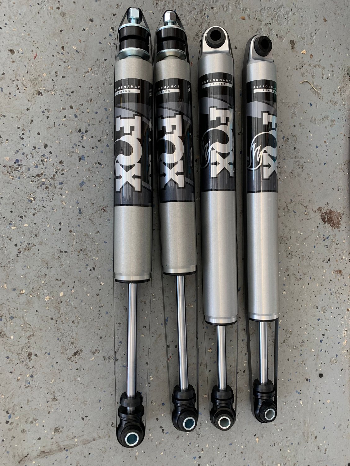

Got back home this morning and found these waiting for me

Nice! Stock height? Gotta get mine ordered.
Yes, stock height. The Readylift lit has shock brackets so no need for longer shocks

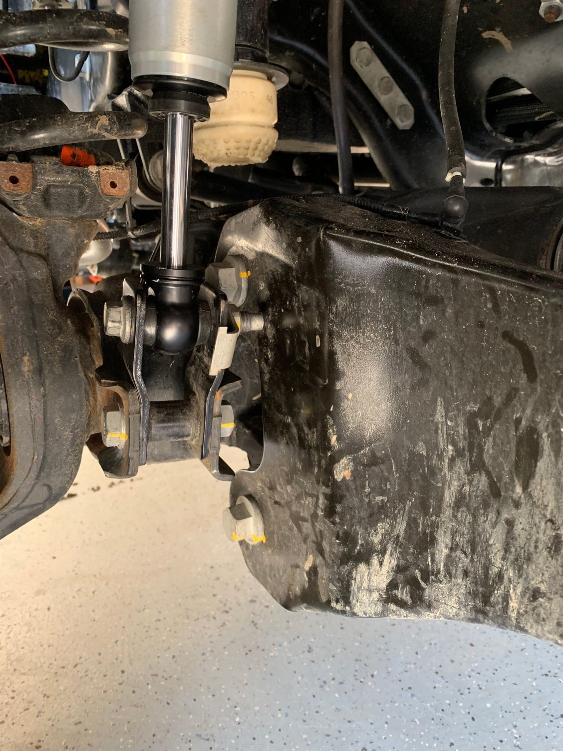

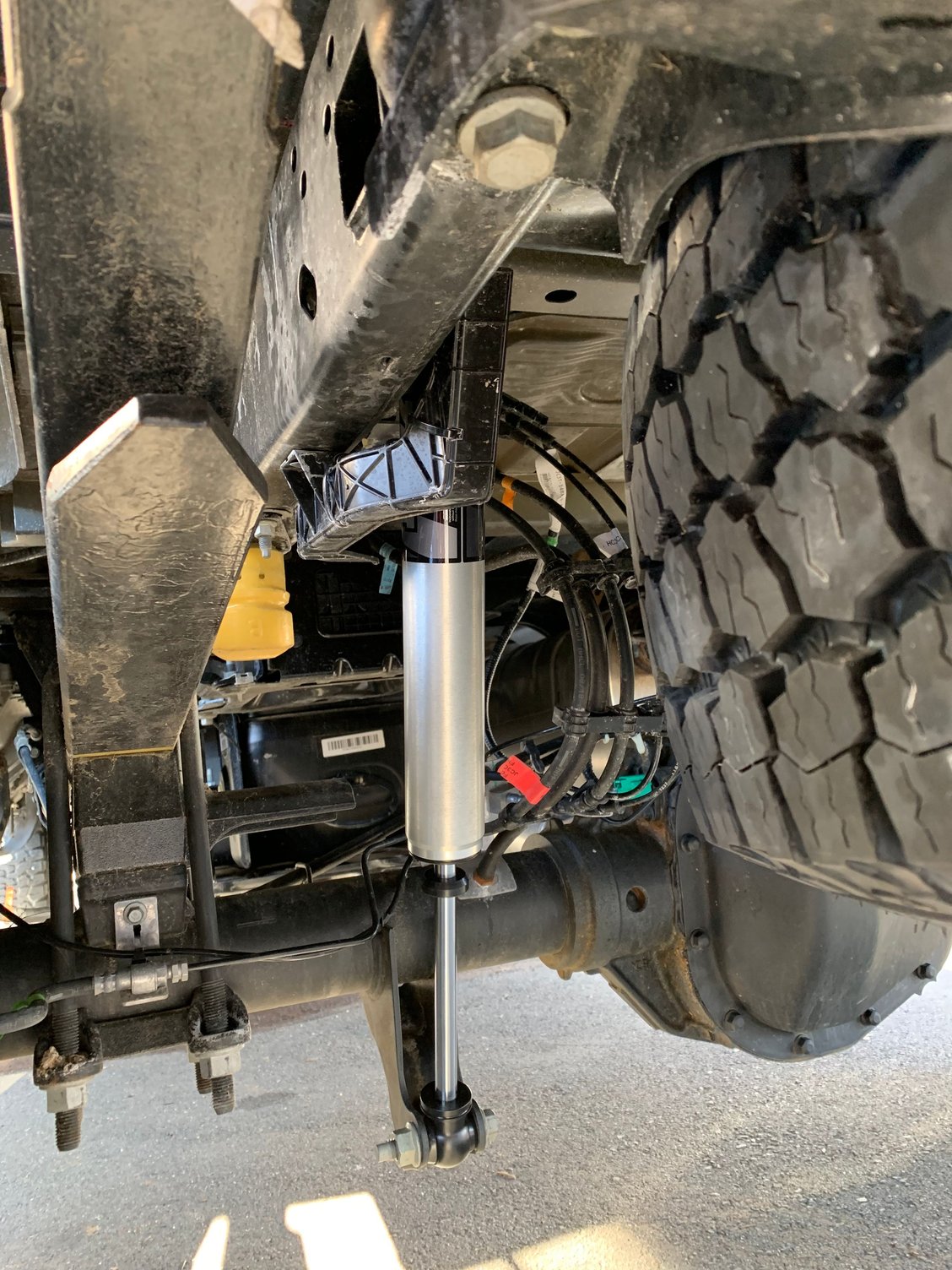

The job took 2 hours total but most of that time was spent wrestling the front shocks in place. The rears took 20 minutes each, including removal of stock shocks. The first front took me an hour because it took me a while to realize/admit I could not wrestle the shock (I’m a stubborn man) and I finally decided to lift the truck by the frame to make things easy on me. After that, shocks went in easily/quickly.
