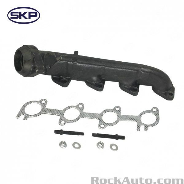

The exhaust manifolds on a 5.4 look more like a boat's with a straight tube that gets thicker at the back end.
On a 4.6 the manifolds look "snakey", instead of being a straight tube it sort of "wiggles".
But it is possible someone mixed up the parts.
