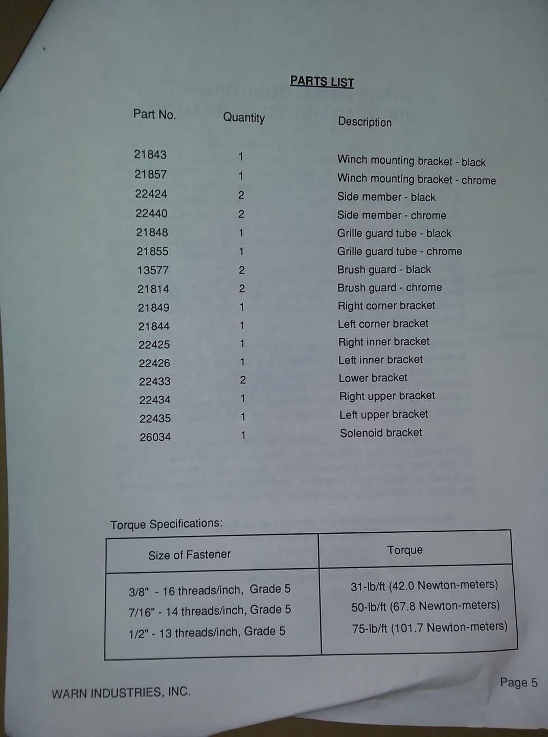

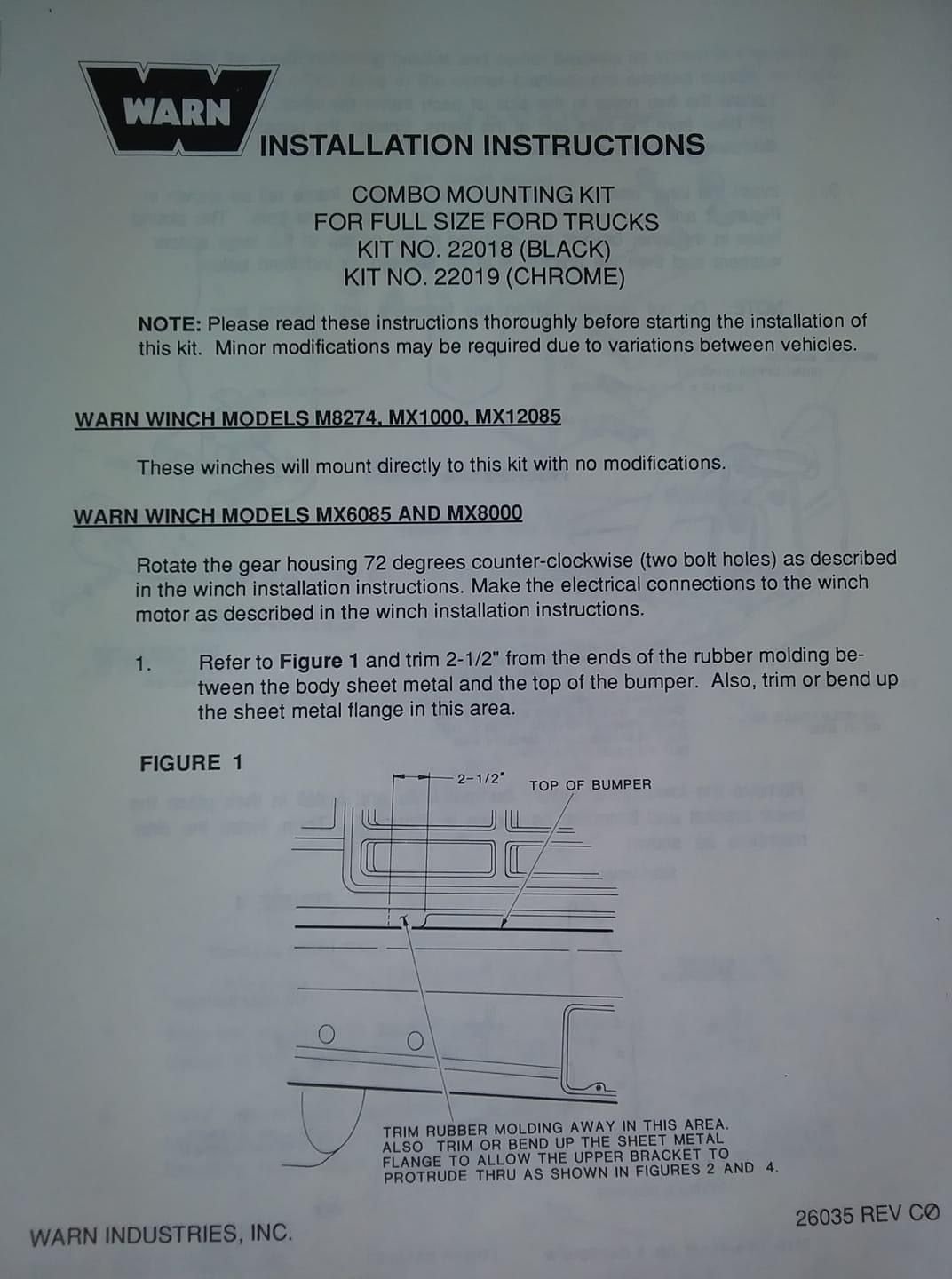

I have a 1990 Bronco and I am wanting to install a Warn Combo Kit winch mount (Part Number 22018) and I do not have the brackets. I called Warn and they went through the archives and emailed me the instructions but all the illustrations are blank so I nothing to go by. I really like the brush guard type of mount and it looks just like the one I had on the Bronco I drove in college. I am mounting a Warn M12 winch and want to make sure I have it securely mounted to the truck. The way it was mounted on the donor truck was not secure at all and just used the bumper bolts. So, if anyone out there has the old mounting instructions that they can take a picture of or maybe the actual brackets I sure would appreciate it.

Thanks, now if I can just find a set of brackets.

No problem. They certainly are hard to find. I am planning on just having some brackets fabbed up for this similar superwinch grille guard Name:  photo638.jpg
