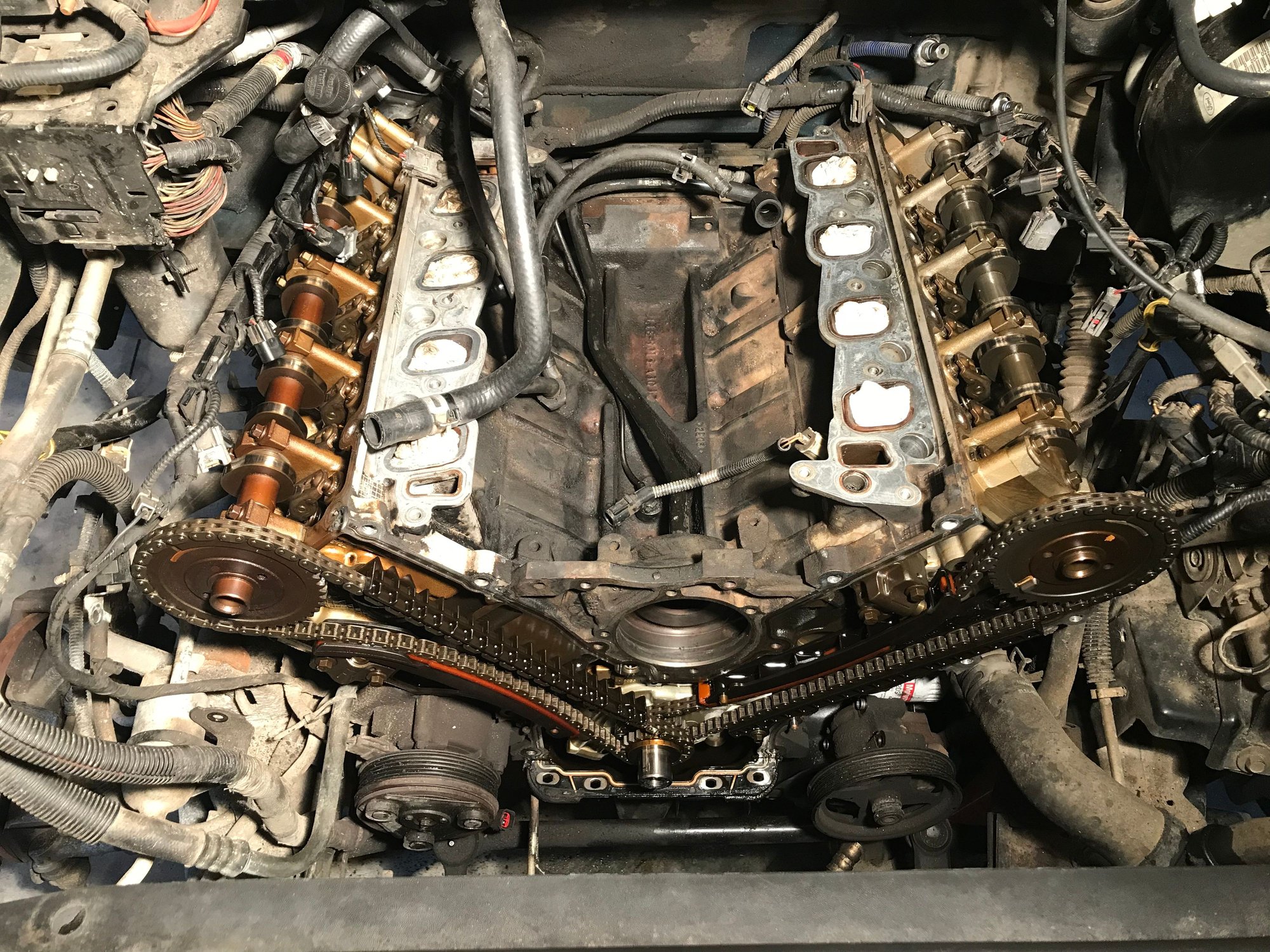

I know this thread is a little old but for those who are interested in replacing the oil pump while the front cover is off:
I just put new chains and tensioners on my wife's 2002 with a 5.4 and I was able to replace the oil pump without removing the oil pan. The driver's side bolt that attaches the pickup tube to the pump housing is a little farther back than the passenger side making it a bit more tricky but it is doable with a flex head ratcheting wrench. 8MM or 5/16. I probably dropped the bolt 5 times into the pan before I got a flex head wrench but was able to retrieve it each time by using a telescopic magnet. It never went into the deep part of the pan. Melling makes a high volume oil pump which I used because her truck has 277K on it.
Good luck guys!

This was the only picture I saved. You can see a gap at the bottom where the front cover goes. That’s the gap you have to work thru. The oil pump goes around the crank shaft behind the lower timing chain gear.
