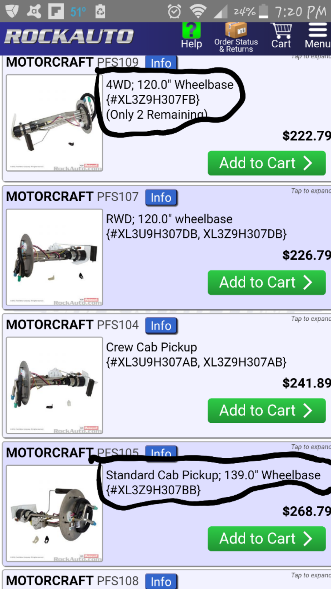

Trying to find the right fuel pump for my
03 4.6 f150 supercab fx4 styleside
Specs on here say my wheelbase is 138.8".
Trying to order off of rocksuto.com.
The 4x4 option says 120.00" wheelbase.
While the standard pickup option says 139.00"
Any ideas which one will fit? Is there a difference? Any advice will be greatly appreciated!

I looked it up on Ford Parts Direct, in your picture the correct one shows to be the 2nd one down according to the Ford Parts Direct website with the alternative Motorcraft part number ending in "DB". It also shows to be 26¢ cheaper than Rock Auto.
https://www.oemfordpartsdirect.com/
So it might even be worthwhile to check a local dealership parts department for the correct part # and to see what their price is.
Having gone through this recently with a friend on his Ranger, we ordered what Rock Auto showed to be the correct fuel pump assembly according to the vehicle description. Upon arrival the new one had a frame that was too long to fit into the tank. We swapped over all the new parts onto the old frame and put it back together. No big deal. It still runs with no issues at all.
Also, the vehicle certification label shows the wheelbase and other information specific to your exact vehicle. The label on a Super Cab is located on the front of the drivers side rear door.

Weird how rock auto doesnt have that straightened out!
**** that site you sent seems pretty damn legit!! Have you ever ordered from them before?
