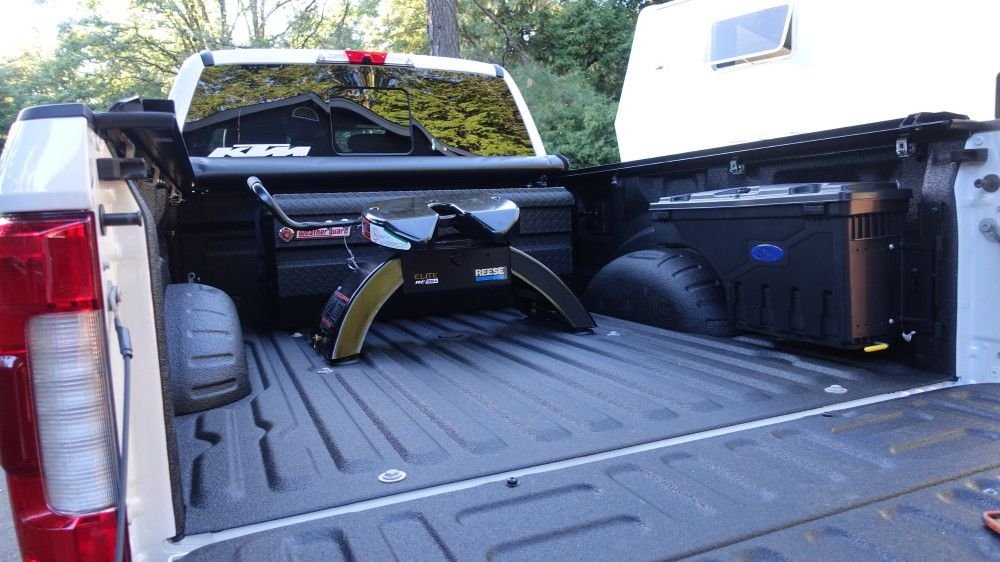

I have been happy with mine also. I have one just on the passenger side.
Security wise they do have a lock but these are made of plastic and I would say they would be relatively easy to pry open.

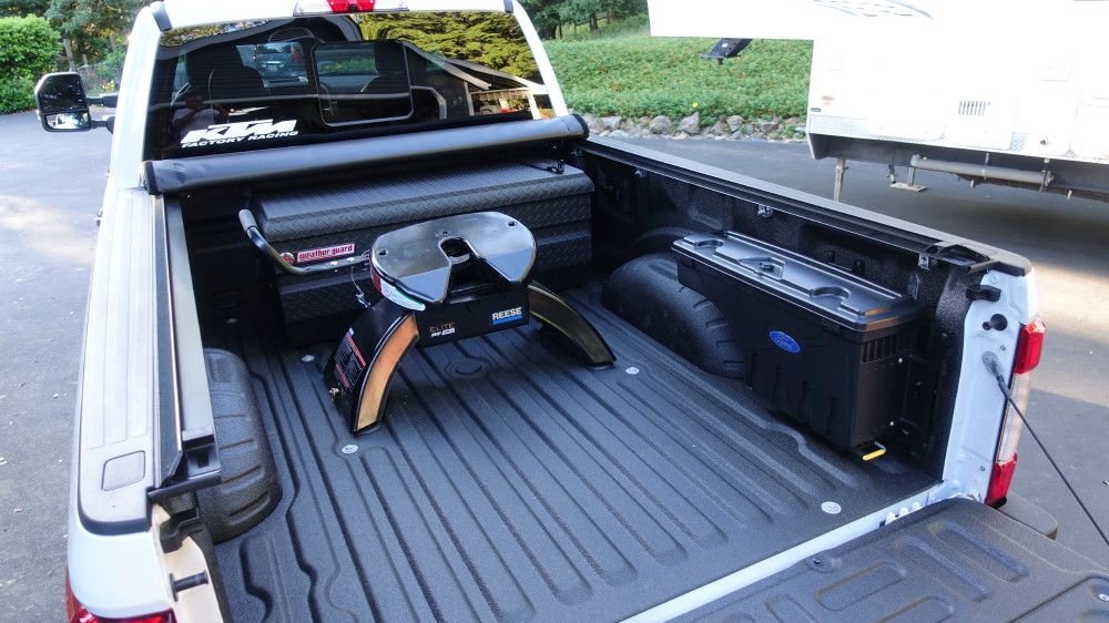

Mine is a '17 F350, F250 should be the same. The light is mostly blocked. I am able to use the tie down hook only if the load is high in the bed.

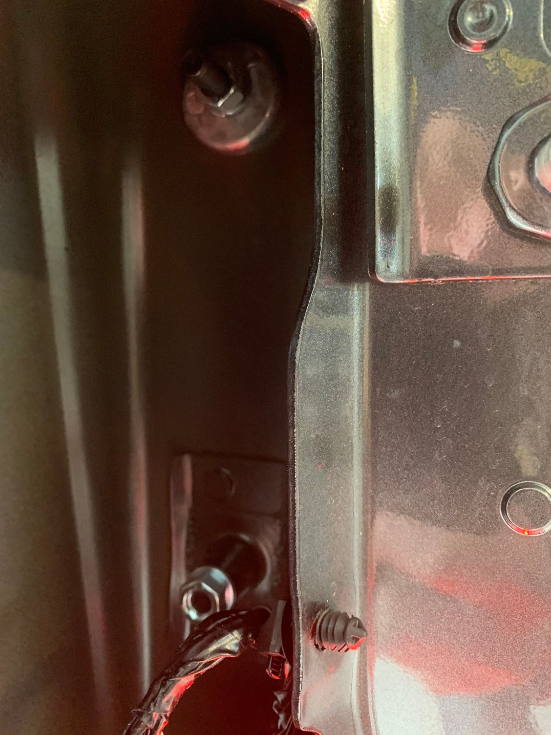

I received the boxes yesterday and installed one today. I really liked them and the installation is very
clean. No need to drill holes or use self-tapping screws. It all mounts on existing spots in truck.
Bolts pass through the existing holes on the bed frame and nuts tighten from behind with lock washers by taking the tail light housing off:

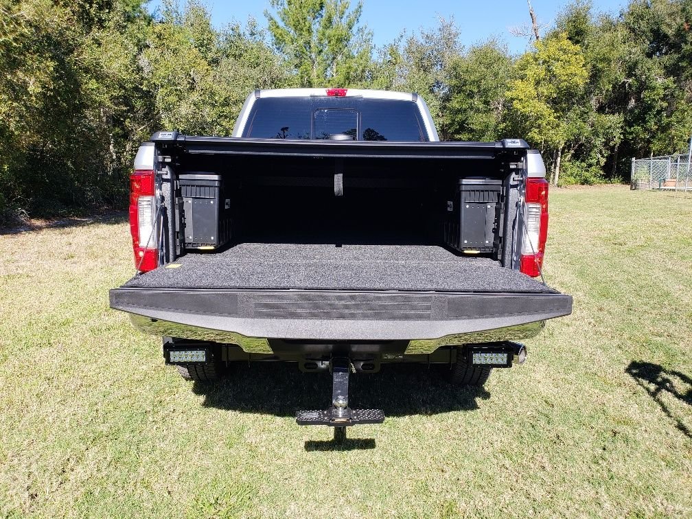

Installation looks clean:

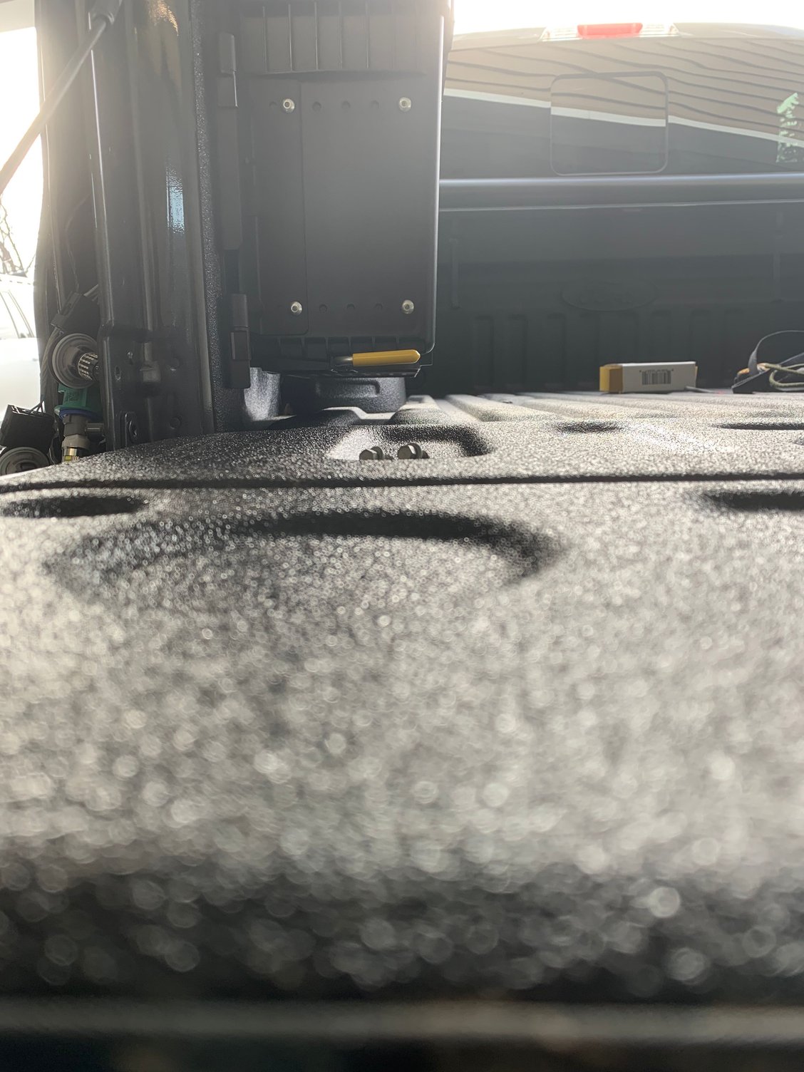

I liked them a lot and I was only going to add a rubber stop to the locking bracket so that it would close tight, under a little tension to prevent any rattling. But, I had to return them 😳
The problem for my needs is they stick out past the wheel well and I need all the width to fit my ATV in the back:
