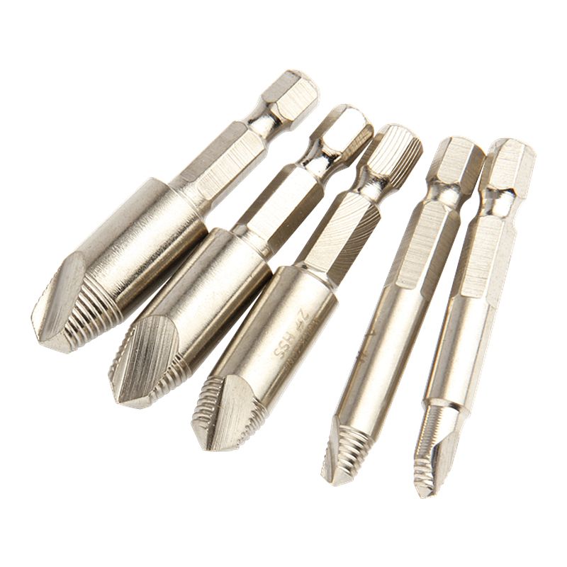

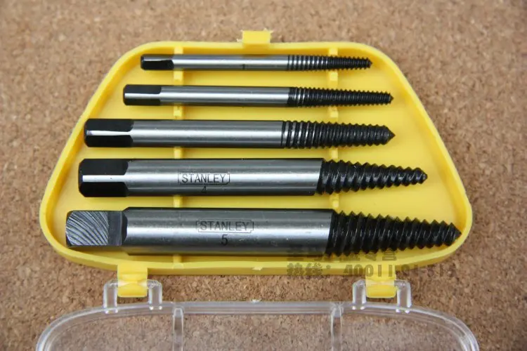

Try one of those left or backwards "drill / extractor" in a reversing drill, I bought a cheap set at HF that work for occasional items.
If that doesn't work, drill it out using carbide bit …… and retap hole to next size and up size screw if threads get smootered badly.

Reverse drill bits can work. I found that they are best applied with a hammer drill or impact gun. More than 1 type on the market. I've got several of them, and usually one of them will work, if the first one I try does not work. Lubricant really helps. WD40, Liquid Wrench, et cetera. Sometimes it takes a little patience. Sometimes you have to use a smaller drill bit, drill into the bolt a little, then insert your reverse bit.
