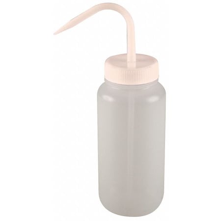

Now if your carb is not squirting and will not pull fuel till running you can fill the carb with fuel.
Get a squirt bottle fill it with fuel and use it to fill the carb bowl thru the vent.
Just thinking that may not work on the 300 six carb so this one may work.
You can also add a little more fuel to the carb than the 3 spoons
