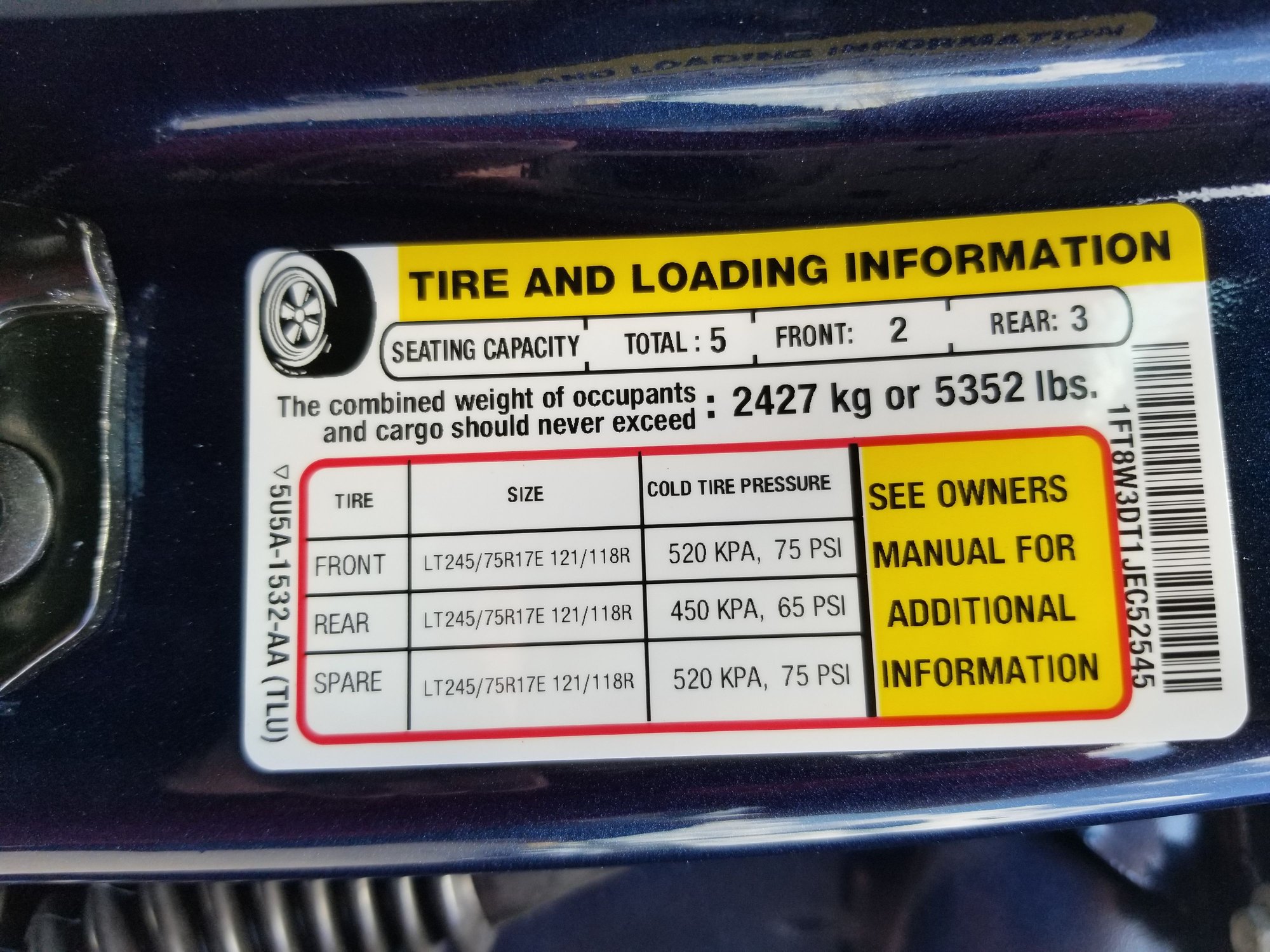

If you do decide on a 16K pound fifth - then go with a dually (FORD, Chevy, Dodge); AND ensure they've (Dealer) checked the appropriate order boxes for the heavier capacities.
Here are my two door stickers: NOTE the (optionally selected) GVWR of 14K and its subsequent payload of 5352 pounds.

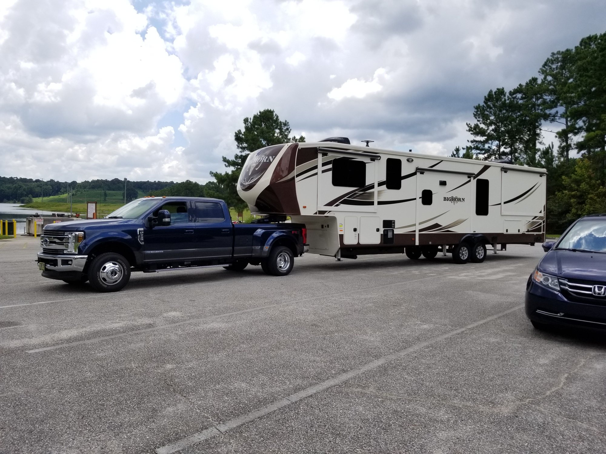

My dually & 16K# Bighorn; with 20% - 25% (3200 - 4000 pounds) loaded on the pin I still have ample capacity for people (fat mother in law), pets, fuel, hitch, tools, wheel chocks, propane and grill, portable waste tank, etc, etc.
Towing prudently like grandpa, over basically level ground, I only realize 8 - 9 mpg; keep that in mind if you go that route.

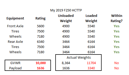

I recently posted this in another thread:“Yet another weight related thread is petering out. No problem, there will be another one soon. Before this one dies completely, I did some math that I wanted to share. I built a spreadsheet assuming that the actual weight of my truck (I have not scaled it yet) is the GVWR minus the payload on the sticker. That may not be perfect but I'm sure it is pretty close. I did some research to determine the individual axle weights. There are a couple threads where folks posted their weights or an image of a CAT scale ticket. I added 350 pounds to the unloaded weight of each axle (700 lbs. total) to account for cargo in the bed and cab. Once again, not perfect but this is about getting a general idea. I used the specs of a Grand Design Reflection 303RLS which has a GVWR of 11,995 pounds. I assumed the trailer would be loaded to the max and allowed for a pin weight of 22% (2640 lbs.) with 11% (290 lbs.) on the front axle and 89% (2350 lbs.) on the rear.
If you are devoted to the GVWR/payload sticker, this is damning evidence of how utterly overloaded my truck would be towing a moderately sized fifth wheel. If your concern is the actual ratings of the component, this is validation of just how capable this truck really. It is interesting that even a SRW F350 would be over its GVWR based on these calculations...and this is a relatively light, mid-profile trailer. It is also interesting how close the front axle is to the max rating.
Please check my work if you want. I think my methodology is at least sound enough to derive a reasonable picture.”
Everyone gets to decide what they are comfortable with. As a logic driven guy, I find it almost impossible to make decisions that are based on ratings which are not derived from any actual testing. Personally, I can think of no reason to be concerned with towing or hauling any load that does not exceed the ratings of the components that actually carry the load.
