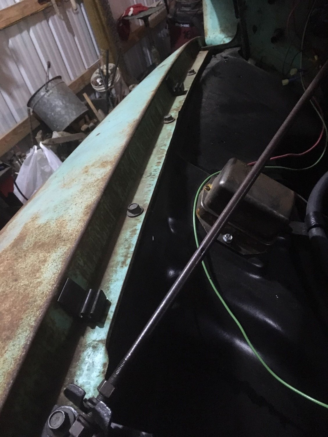

Here is a picture of the zig zag pieces. I only had one on each side. Notice the hole that they go in to hold them in place.
The conical pieces go on the hood I believe. I don't seem to have a picture of that. I will see if I can get a picture for you. It might be this evening though. Someone else might have something handy.

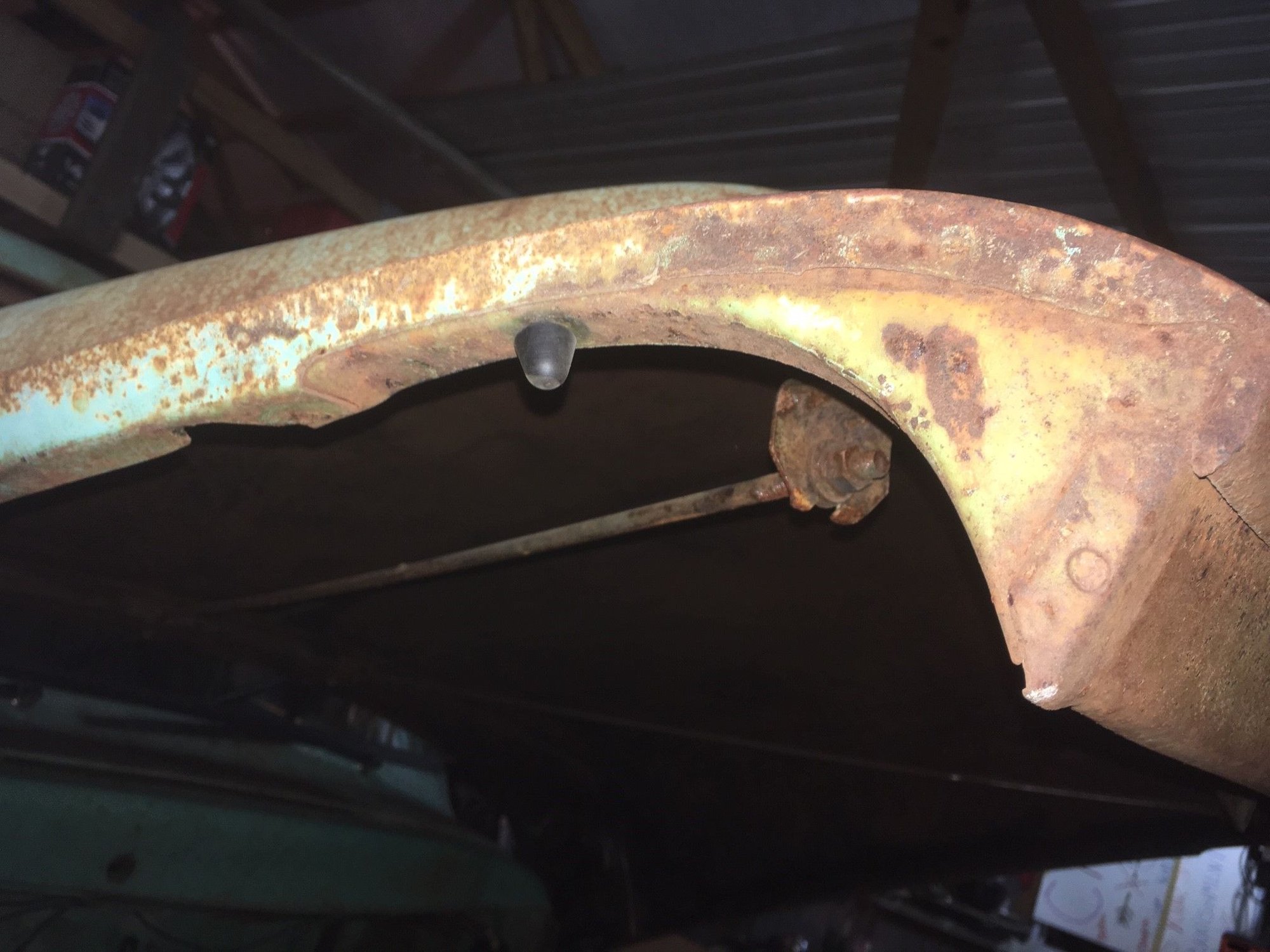

I ran to the shop on the way out the door. Here is what I currently have.
Location of the conical bumpers:
Both zig zag bumpers installed.

You are spectacular!! Thanks for taking the time to send the pics.
Regards, Mark.
