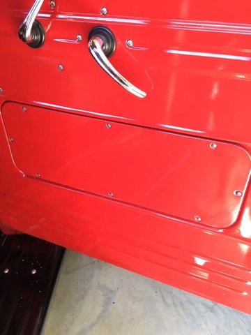

Door Panel Access Screws:
I am missing some of the door panel access screws on my 1952 F-1.Can these be purchased at the neighborhood hardware?My problem is a lot of the screw holes are stripped out.I realize I can just get bigger screws but with bigger heads??What is the best way to go about resolving this problem.I was hoping to go with stainless screws at some point.

Old thread but I did I think fix and quiet down those rattling inspection plates on doors.I put some JB weld in the screw holes and drilled out.I got some tool chest liner and installed on back of plate.This seemed to quieten everything down and door seems more solid.If your inspection plates were like mine all you had to do was tap on them and they sound like a tin can!I used 3M adhesive spray in the center for extra hold.Just thought I would pass this along.
