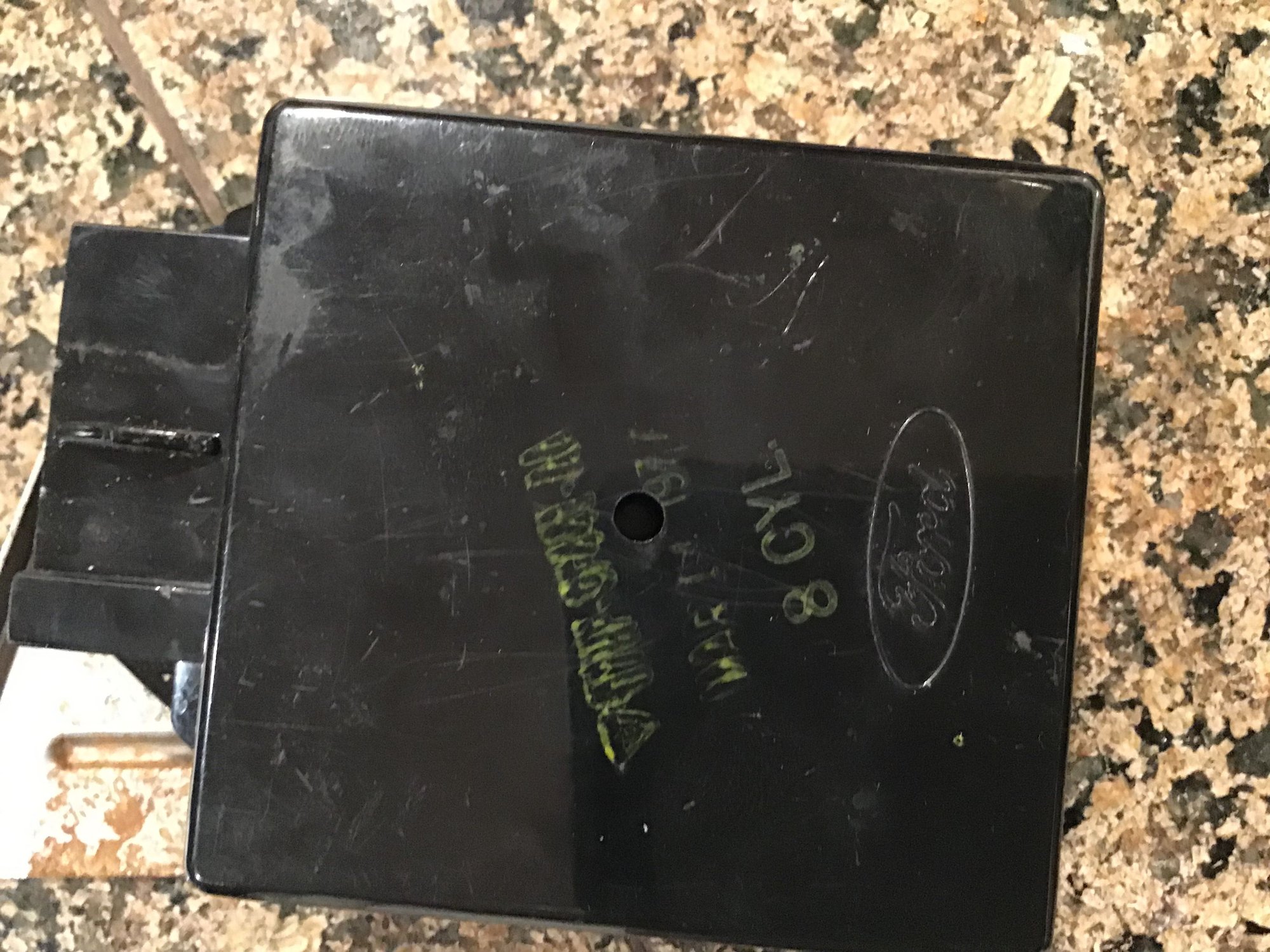

Part identification
I have a 1977 F350 Camper Special. I found a part behind the gage cluster that I am trying to identify and need help. As near as I can tell the part number stamp is V-17HF-9744-AA. It was connected by a metal bracket that attached to a heater duct and has a single plug that goes into it. It is also stamped with MAR 14 1977, 8 CYL.
What at is this? Help
Thanks

D4AZ-9E731-B .. Speed Control Amplifier / Marked with ID number: D4AF-9E731-BA (Motorcraft DY-145) / Obsolete
Use with factory installed Speed Control:
1975/79 F100/350 & Econoline; 1978/79 Bronco; Some 1980/91 F100/350, Bronco & Econoline with two (upper/lower speedometer) cable system.
1974/76 Thunderbird/Continental Mark IV; 1979/82 Mustang/Capri/Fairmont/Zephyr; 1981/82 Granada; 1981/83 Escort/Lynx.

Cruise control brain box.

Thank you both. So I take it there is no way to purchase a new one? Also if that is the part number what is the number that is stamped on it?

When ND posts his info, he usually posts the location of the part if available. But he posted "obsolete" at the end of the part #. so it is not available...Maybe Ebay for a used one? Maybe post a WTB add in the classified section. https://www.ford-trucks.com/forums/m...ntent%5B0%5D=1
You can also check for these vehicles in JY's for that part. But they are OLD so probably not a lot of them still around in JY's.
