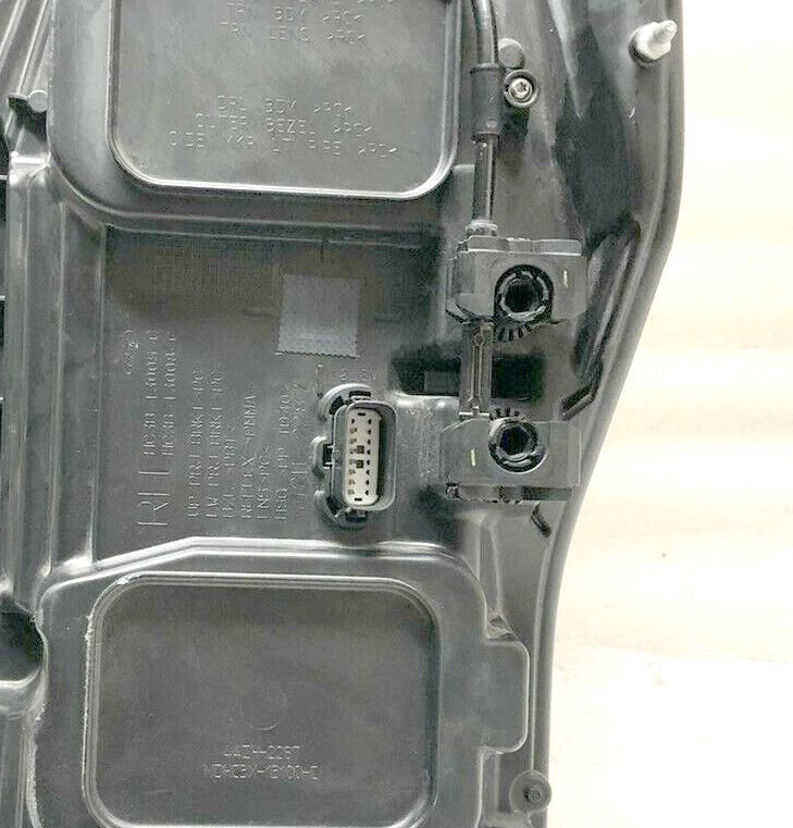

Figured out how to fix 2017 LED adjusters
Guys, firstly, thanks for all the comments in this thread that really helped me out. New to this forum and new owner of a 2017 F-350 Superduty Diesel. My LED headlight adjuster screws (the ones with the hokey cable and plastic gear setup) were also locked up. I tried turning them but they didn't budge, so didn't turn any harder for fear of breaking them. So went onto Ebay and found some photos of an LED headlight unit showing the back side and the gear system (photos attached). So it turns out that the cable turns a plastic shaft that's connected via some plastic gears to two 90-degree bevel gears that adjust two hex socket screws that in turn adjust the light beam up/down. I'm not sure whether it was the hex screw that was frozen or just the collective resistance of all of the parts not having been used and collecting dirt but here's how I solved this:
I removed my batteries which gave me enough access to the back of the lights where the adjusting mechanism is located. I then sprayed some silicone lubricant on all the gears (use silicone not regular oil as it could damage the plastic). Then I used a 1/4" hex wrench (I think an 8mm one was probably the correct size but 1/4" was all I had and fitted okay) and inserted it into one of the hex socket screws and cranked it a little back and forth until the gears freed up. Then lubed some more and turned the adjuster screw backwards and forwards until things were moving nice and freely.
I did things one battery at a time so that I wouldn't have to reset all my radio stations, etc. and also so that I could turn on my headlights after lubing the first, adjust the beam height back to match the other light that I hadn't touched yet, then did the second light and adjust it back to match the first light's height. Also took the opportunity to clean up my batteries and repaint some brackets that had gotten damaged from battery acid leakage.
So hope this helps out some of you if you want to get those adjusters working again without fear of breaking them or going through the warranty process.

Thank you, mine were also a bit high blinding others, tried to adjust and they didn't move. Not wanting to break them off, I got out my allen wrench and went to work losening them up. A little lube really helped, but still pretty tight. Got them to move without breaking anything. Dropped an socket down there somewhere in the process, much cheaper than a headlight though!

Undoubtedly like many others, I found this thread through a depressed google search after stripping out the crappy plastic adjuster screws. I tried using a good lube to loosen up the gears, but still stripped out.
When I tried fitting an Allen wrench into the backside to adjust it that way, of course it wasn’t possible to get the wrench in behind due to clearance issues. Of course, Ford designed the truck where you have to remove the grill to remove the headlights.
So… out of desperation, I tried shoving a 1/4” Allen wrench in the adjustment screw slot, and it grabbed the sides and turned right away. For those looking for a fix - this worked for me. That said, it would be real nice if Ford didn’t cut corners on cheap plastic parts that are known to break easily, and of course that aren’t replaceable individually. Replacing my headlights would have been $1770+ each… and that’s not okay when a 5 cent part breaks.

The adjusters on both my LED headlights don't work (2015 model). They won't go up or down and are currently pointed too far down (came like that). Has anyone removed the headlight assembly and adjusted from behind? It is a lot of work to take the assemblies out and I would hate to do all the work if they can't be adjusted from behind either. Thank you all for your help with this. Such a terrible flaw with Ford's headlights.

Yes I have an earlier build 2017. It was very strange as I could not turn the screw either way on either one. It would turn and build up tension like a spring and as soon as I would let go the screwdriver would spring back literally like I was turning a spring and the headlight would not move. I maybe turned the screw about 2 full rotations against the springy tension before I heard the sound of plastic snap then it turned freely but did nothing. The passengers side is same story but I only turned that one about 1 rotation in both directions and it would not budge so I gave up before I heard any snapping.
this is exactly what’s happening to my 2017 f250 and I need to aim the headlights down due to barely seeing the road. Can you adjust them from the back if you remove the headlight?

Yes, you can adjust them from behind using a 1/4" or 8mm hex wrench but you'll have to remove the batteries (do one at a time so you don't have to reset your radio stations, etc.). You may need to spray some silicone lube into the gears and gently crank back and forth to free things up as there can be dirt and grit buildup in the mechanism.
perfect, I just saw your post after posting this! Been looking for what you posted so I will be doing what you did this weekend! You just saved me 3k lol thank you !
