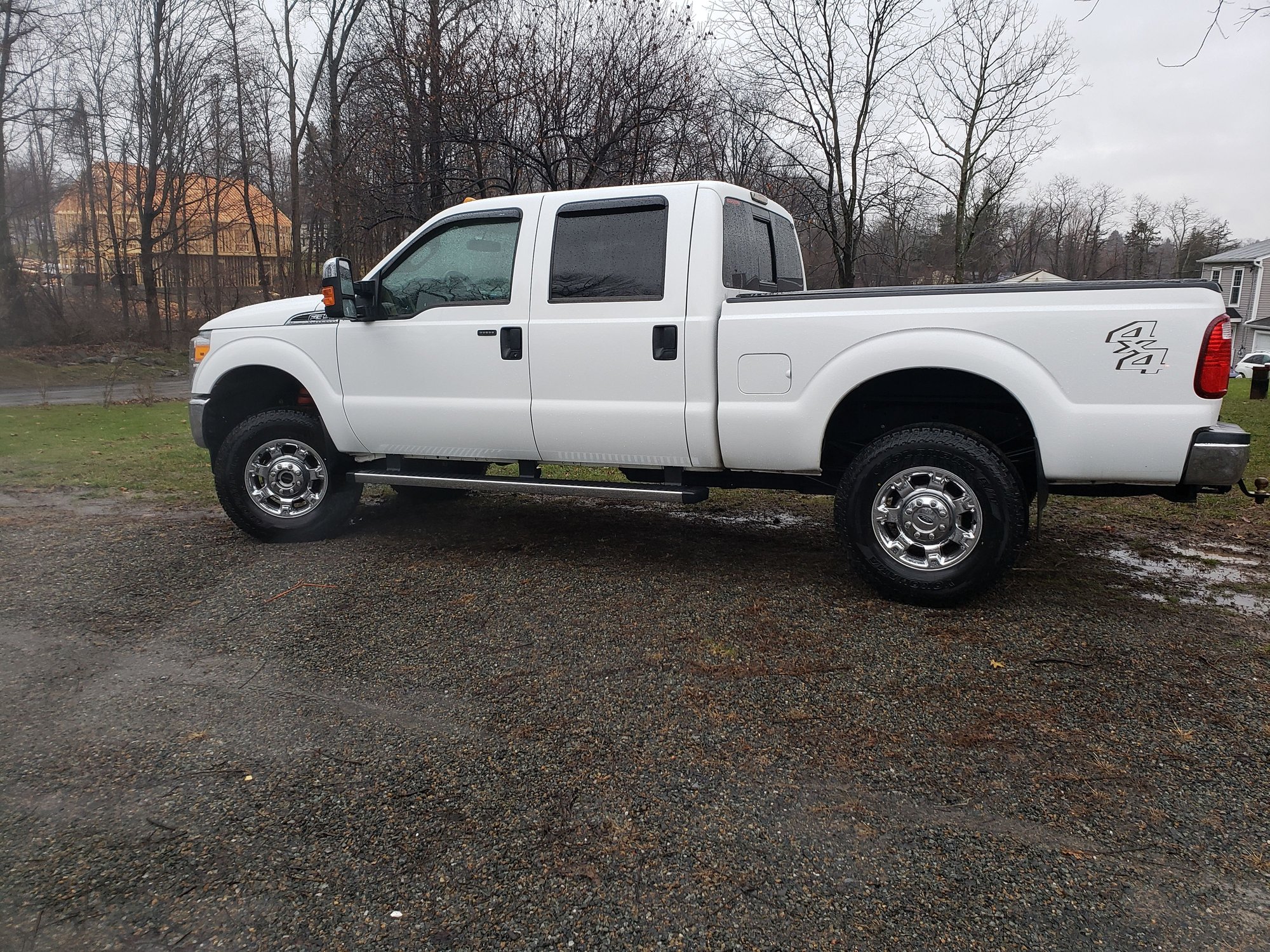

Hey I wanted to just post an update in case someone out there wants this info as i had a hard time finding it myself, or making a decision. I had stock 18" rims and tires on my 15 f350. I wanted a meaner look but the ole wallet couldn't take new 20" black/chrome rims and 35" tires just to run in summertime so i wanted a beefier looking tire that would perform decent in the snow. I settled on a 285-75 r18. Its only an inch wider on top but it measures a 35" circumference. Also it carries more weight than stock.Rides better due to taller sidewalls, stock was 33.5 i believe.Attached what it looks like with the new tires

nice wheels... I recently upgraded the wheels on my truck too. went form a 17" steel wheel with 315/70/17 tires to a 18" king ranch wheel with 325/65/18" tire.
