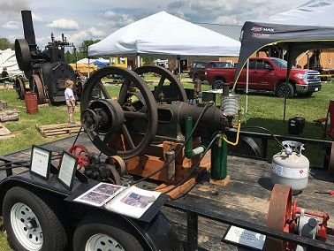

Here is a photo of my 1899 5HP Bessemer Hit n Miss engine at a show this summer. I want to mount this engine to the bed of the truck. I am guessing the engine weighs about 1 ton.

I love the sound of those engines.
