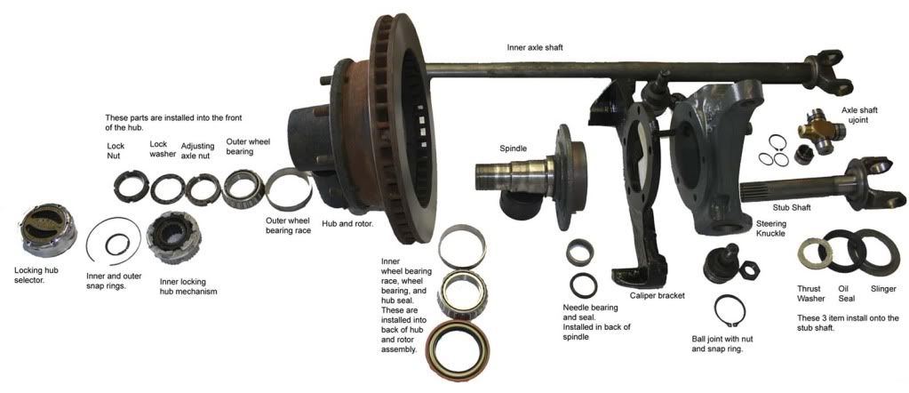

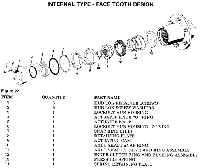

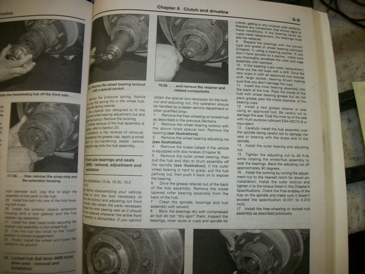

Here is some more info for you.

Wow! Thanks, Rich! The pics from the manual were most helpful. Everything is out at this point, with the exception of the pass. side inner axle seal. The pipe I have was long enough for the d/side but not the p/side. I found missing ring bolt number 10. It was in the bottom of the pinion shaft side of the diff. Well, the head of it was anyway. Used a magnet to get all the metal out of the diff and it hit with brake cleaner. Looks good.

Pic 1 and 2 are just the ol basic Chilton/Haynes manual. The other is the dealership service dept paper manual. All over Ebay, in paper form and CD. I use them all to get what I am looking for at times. Shop around they can be found all over the web.
