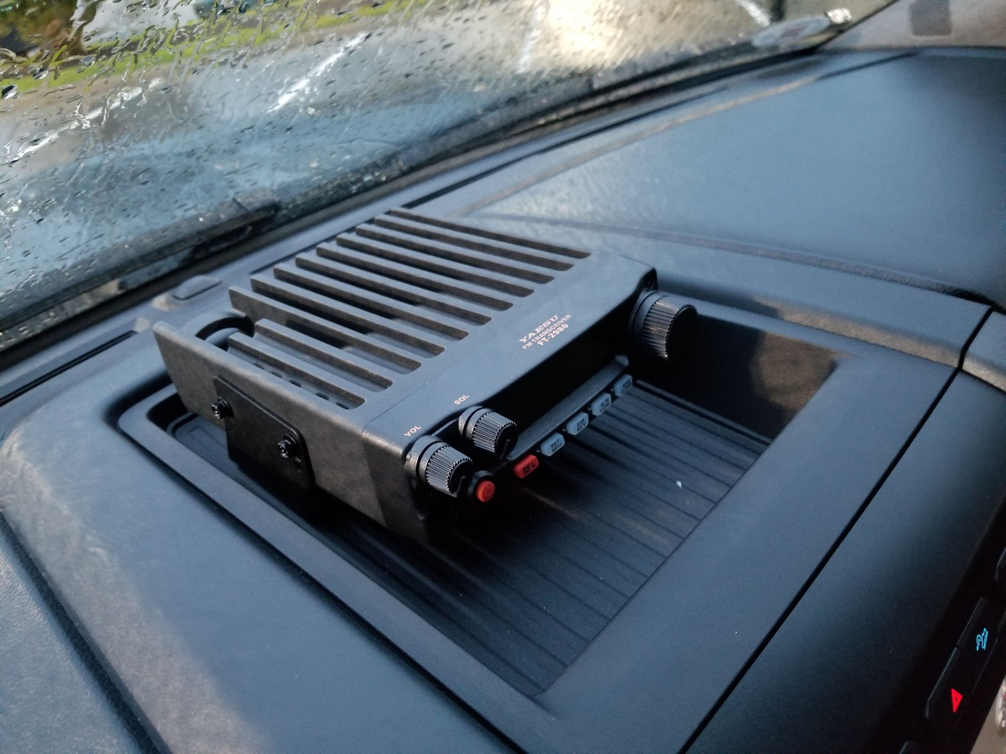

I'd like to mount my VHF mobile transceiver in the storage area on the top of the dashboard. Anyone know if it's safe to put a couple of screws in this area to hold the bracket down?
It'd really be nice if there was an easy way to expose the area under this spot (remove some of the bezel/pieces around the screen?) so I could see where it was safe to screw/drill, etc. I was thinking another hole or two to route the power & antenna cables through the dash would make for a super clean install.
I could just replace the rubber mat that sits in this spot when I decide to remove the radio & sell the truck and nobody would ever know a few small holes were underneath. Thanks for any info/tips from anyone that's done anything similar or done any exploratory work with dash/radio area on the trucks.

Take a look at this bracket and they have a video on the page as well that details the install and such. Hopefully this is what you are looking for here. ;-)

flumpydog, thanks! That bracket is perfect and I'll be ordering one.

For anyone that may stumble on this thread later, this installation video for the bracket linked to above answered all of my questions

I pulled down the overhead console w/ the upfitter switches this evening just to investigate what it'd give me access to above. Much to my delight, you have access to the bare aluminum roof just behind the cab clearance lights (or where they'd go if yours had them). It appears I should be able to drill a 3/4" hole for a roof top NMO mount 3-4 (maybe 5-6") behind my middle clearance light and use the access provided by the overhead compartment to get it all snugged up and route the cable across the headliner by the top of the windshield and down one of the A pillars fairly easily.
Only potential problem is even 3-4" behind the middle cab clearance light the roof it still a bit sloped towards the front of the truck, which means my VHF whip will be slightly tilted forwards. How goofy this will look/how much it will bug me on a truck of this size (mine's on a 3.5" level on 37s) I'm not sure of - I'll have someone hold the antenna in place for me so I can check it out from a distance tomorrow.
Im assuming from your "txs" forum name that you are in Texas. Mounting that radio there on the dash is gonna severely reduce its life, with that hella-hot Texas sun frying it all day long every day.

Yes, located in Texas. I use a fold out sun shield when parked in the sun, and you can't do anything about the inside of the truck getting hot during the summer. This Yaesu 2980R was only $150 - so if I get a few years out of it, I'll be satisfied.

Nice radio and good location for convenience. However, I'm thinking you might have a couple issues with that location.
1. It's right there in plain sight for everyone to see, so some sticky fingers might try to walk off with it if you leave it unattended.
2. If you're in Texas, the sun will probably bake it into oblivion. Electronics don't like extreme temperatures.
Suggestions - Maybe you can put some kind of shroud over it to shade it from the sun and hide it from plain sight? Or possibly add some quick disconnects to take it down when not in use? If I were mounting a radio, I'd probably go under the dash, center console or up high where you keep up-fitter switches.
