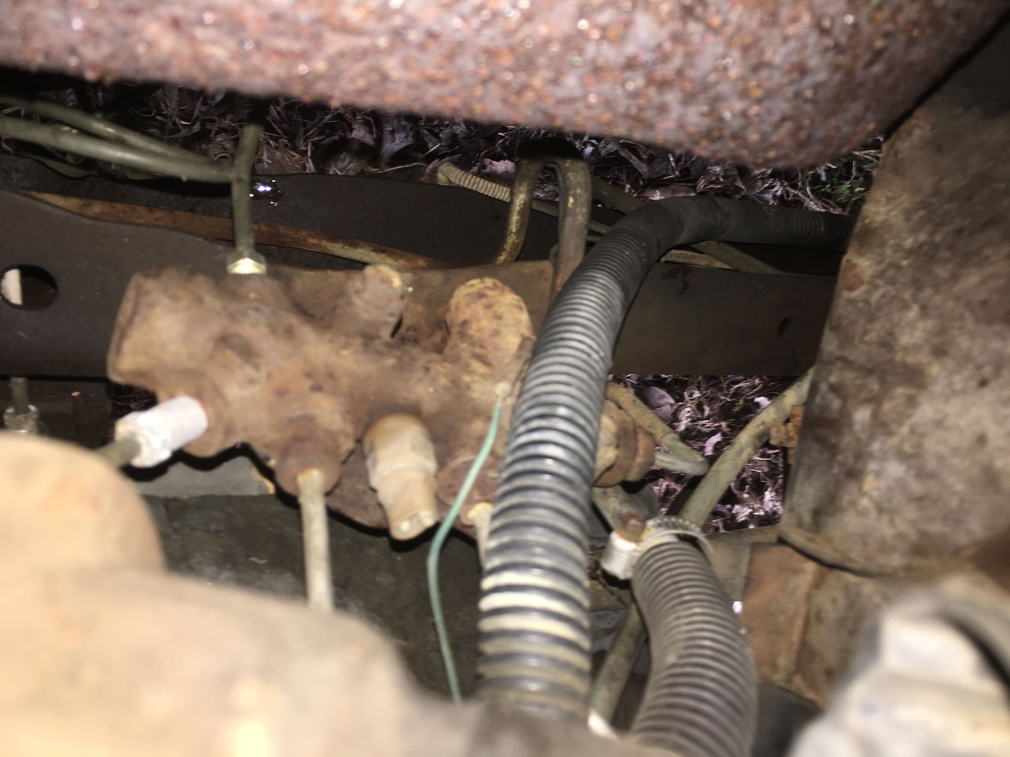

Master cylinder and Power Booster
Last edited by barely alive; Dec 30, 2018 at 08:10 PM. Reason: As you can see there is a lot of rust and likely lines will not come loose without a lot of help.

That looks like a project. I would replace the booster and the master, and plan on replacing a lot of the lines also. You can get universal lines at the store in different lengths, The nuts on the lines that thread into the master are usually non-standard size for the line, so you can try to save them when they twist off the line, or sometimes you can use a brass adapter they sell in the store to make the standard size fitting fit.

You can replace the master separately from the booster on the F-250 with the 6.9l. However if the master leaked into the booster you probably want to change it out too. Looks like this truck has been run in an area where they like to use liquid deicer on the road. The master and booster are rusted up pretty good so I'd probably replace them both. I really like being able to stop my truck.
