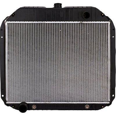

Here is how the options look, don't bother with the APSI brass radiators they are beyond paper thin and way over priced. There is several brands of welded radiators but I only recommend ASI or Champion. You can see that 265.00 from spectra vs 217.00 for the champion. I used Ebay for prices, the spectra is a 2 core and the Champion is the 3 core.
CHEAP SPECTRA REPLACEMENT THAT IS SOLD AT PARTS STORES
CHAMPION WELDED RADIATOR

I just had my radiator blow out on my '77. It was a Spectra brass/copper reman radiator that was about 6 years old. Part number was CU480.
That same part number crosses to a new aluminum and plastic radiator. I was very skeptical about it being enough to cool a 460 in an aerodynamically challenged truck like ours, especially in stop and go traffic. However, I found one for a steal on Amazon for $105 to my door and decided to bite the bullet.
When it arrived I was very surprised at the quality of it. The core is about 1.5-2" thick. Perfect replacement for mine.
Keeps the truck cooler than the original one did! Can't wait to see how it cools this summer!
